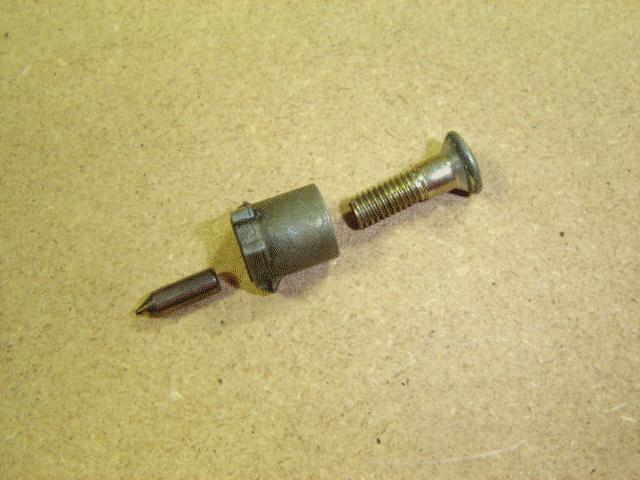

The check ball R Q mentions for a Holley I believe is straight down one of the center vents and is a pain to get out. Either need a strong skinny magnet or turn carb over and tap bottom plate with a brass hammer and have your hand ready for you wouldn't know it came out it's so small.

The 'check ball' for the Holley system is a big needle BTW. It's a little easier to keep track of ;)
I was wrong, it's in here. Need flat head to remove plug. What you are referring to orange150 is the "needle and seat assembly" that controls float level. The check ball meters fuel somehow.
