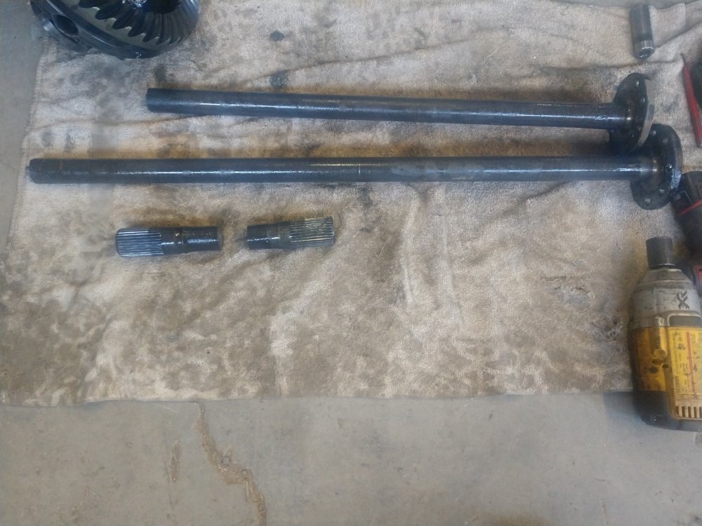

I lost drive to my 14 bolt today. When I put my t-case in neutral my driveshaft free spins. It's was all of a sudden and makes no noise. My guess is that I sheered the pinion. It's new, so maybe manufacturer defect?

I took it apart and found the problem. I broke both rear axle shafts! Time to upgrade to 300M.
Are those stock shafts? I've only seen clean shears like that from stockers. All of the 4340 breaks I've seen splinter
Yes, I heard several people say stay stock or go 300m. The cheap chromoly are no better than stock. I have beat on them hard over the years.
