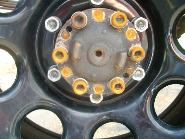

For the FJ80 rear, just drill the hubs for (6) 3/8 dowels and (6) 7/16-20 socket head cap screws like the ones @drkelly linked to. There are 7/16-20's in that link that are supposedly stronger than grade 8. Throw some lock washers on there while you're at it and a little locktite then never worry about those things again.
Someone link a picture, I'm very curious about this now.
You really want to use hardened washers under the heads of high tensile socket head cap screws BTW. There's less bearing area under the head so you need something to distribute load unless there's a reason that you can't. Regular lock washers need not apply.

From when Wizzo did the same mod to his old rig.
What a weird hub setup.

Those are the most useless lockwashers you can get. They only partially work from spring tension (they have very little tension), don't work properly once they're tightened down because the split cutting edge is flat to the surface, they're split so they don't distribute load very evenly, and can also spread apart so the diameter unintentionally changes. Basically, you'd be better served with a good quality hardened washer which works much better as a washer and just as well as a lockwasher (did I mention split lockwashers suck?)...
Basically, those lockwashers are making things worse. If they aren't making things worse, that means the problem is probably something very different than what you think it is.

Yeah, that's true. But, you're shooting yourself in the foot if you're trying to solve something with that type of lockwasher. Has no one produced a hub with a splined drive plate instead of the stud (or cap screw) and dowel pin setup? Adding more pins and more screws just seems like a crutch for a design that is far past it's intended usage.
Yeah, that's what I'm talking about. That's a true solution. That's actually not a bad price for a pair of aftermarket hubs and spline plates and bearings, but I'm used to race parts and not truck parts.
For the drive flange designs, why not stick with studs and nuts instead of using cap screws? Any cap screw that length is likely going to be fully threaded instead of having a portion of unthreaded grip, and fully threaded fasteners aren't very good in shear.
