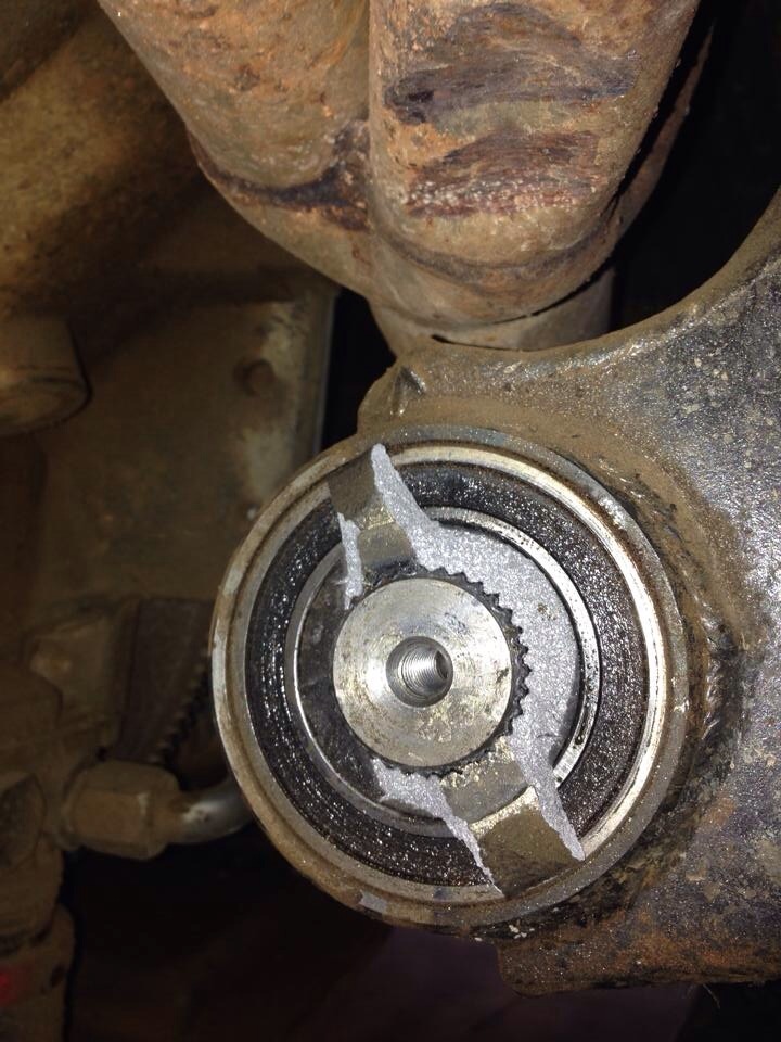

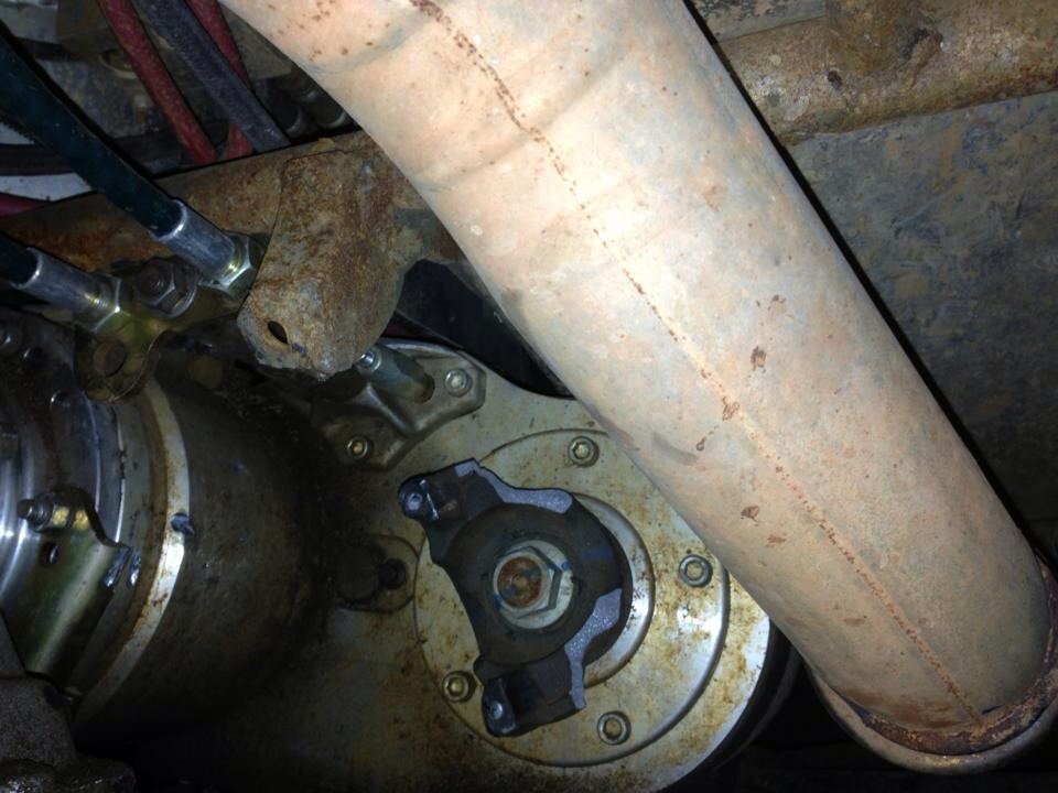

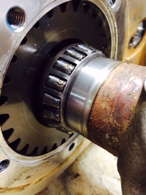

I do not know many people that have broken as many 1410 yokes as I have but here is a little advice on a atlas yoke. Do not ever put a plain spicer yoke back onto a atlas with out the taper portion on it below is what your atlas will look like. Now it is not like I didn't give atlas yokes a chance but after breaking 4 of them I was getting tired of it. Now after switching to the spicer that stopped but as you can see not good on the tcase.
This was a $1,400 mistake to try and make it stronger and quit breaking.

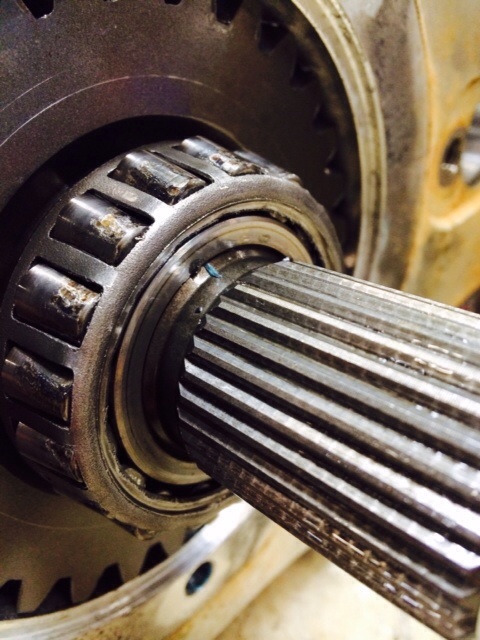

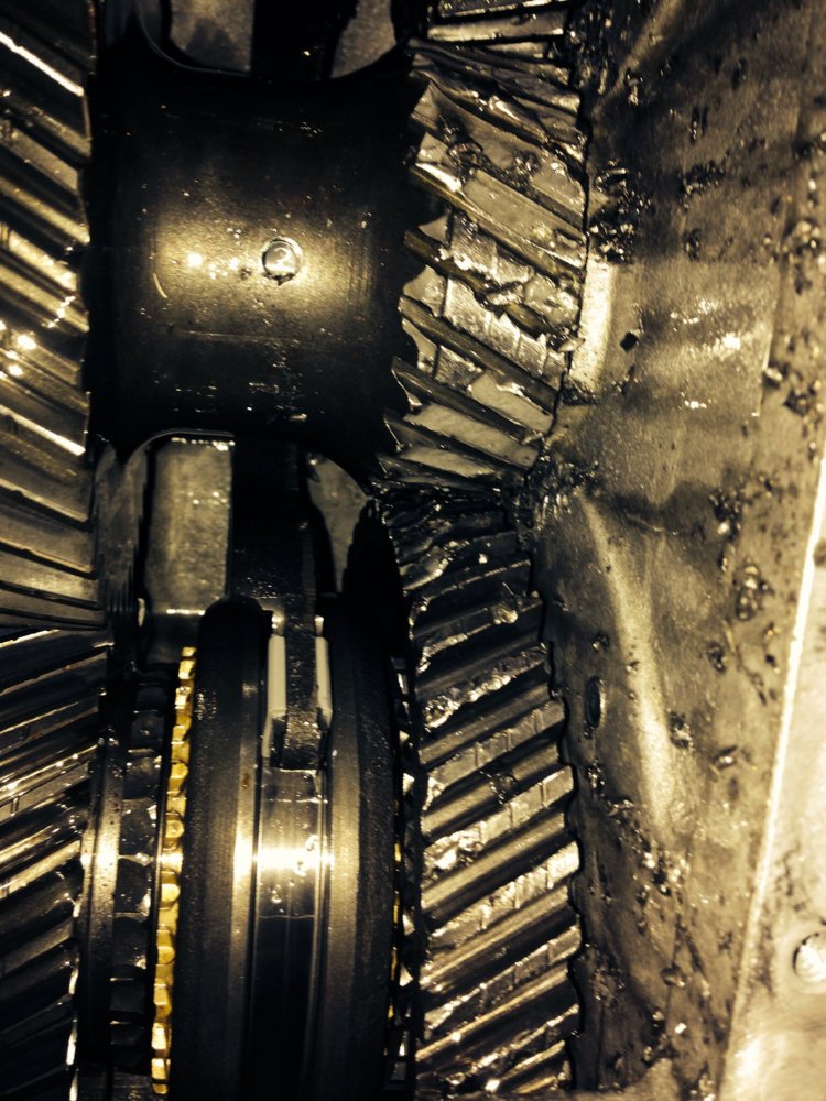

Well that wasn't the first failure the transfer case hasn't shifted correct since it was new. I pulled it out numerous times to adjust it and it would shift one time on the bench then in the buggy it wouldn't go into high range or 2.76. When I changed the oil I found out why a gray gear in it came apart but atlas said it wasn't warranted and I had it adjusted wrong. So hopefully when I get it back it will shift this time.

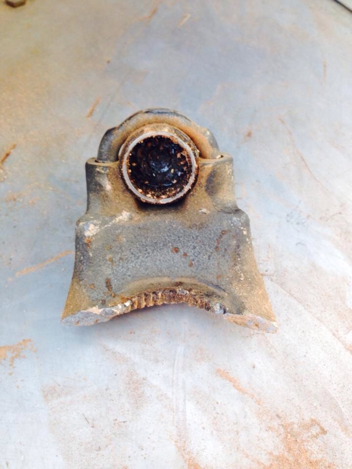

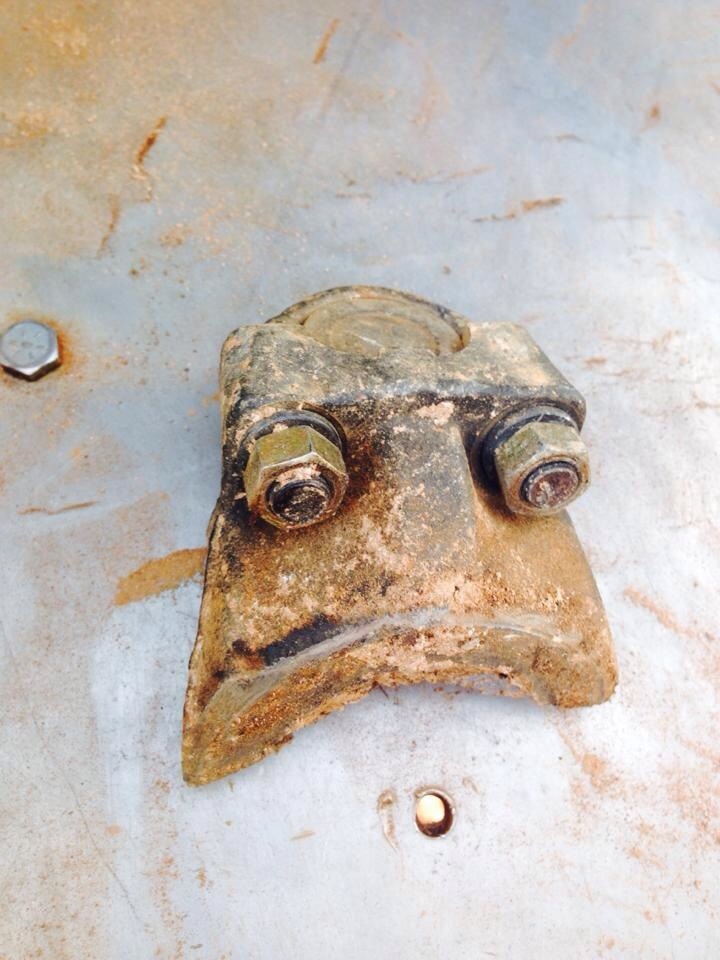

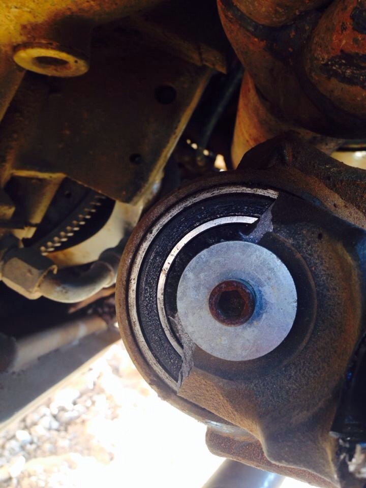

Oh come on now I'm not that bad. But here is a couple pics of the yokes.
Dunno if its just the pics but it looks as if the yoke is so thin in that area its gonna break anyway and the width of the 1410 hurts more than it helps in that situation. You may be better off downsizing and get the best 1350 joints money can buy.

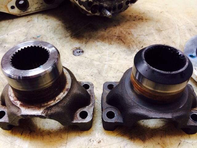

Well the ones on the carrier bearing setup have been milled down and that may be the case but the one on the transfer case broke on the same way. No that I have all spice so far no problems other than burning the bearing up in the atlas. Now on that note the yoke that was put on the atlas that caused the bearing is the same as a 205 so that means atlas uses a smaller bearing.
I have a fortune in my drive line now I am not changing to a 1350 I don't seem to be having a problem with the spicer yokes now. Atlas milled the end of the yoke down to match their bearing and put all the race parts back into the case.
Now another part I have not been able to shift the atlas into high range or 2.76 since it was new. I set everything up on the bench and when it went into the buggy wouldn't shift. Done that 4 times and still same results and found parts of a gear in it before even changing to the spicer yoke. So hopefully when I get it back that problem will be fixed and I will be able to use all my gears.

1410 leverage is the problem, along with shock loading from the drivetrain cushion you lost with the straight cut trans gears. ...and your driving in general. ...[emoji6]
I don't know there is only around .25" difference on the leverage side but that may be enough to do it but I think it will stop with the next round of yokes I am getting none of the body is being taken out of them so we will see.
I did notice a couple different shade of metal in the broken yokes kind of like bad casting. Also Dave noticed it to but who knows all I know is just carry spares with me and some spare caps and it slings those out into a million pieces.
