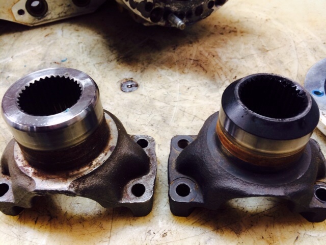

I'm pretty sure they are all cast, but the quality of the casting and design on the Spicer one looks better than the Atlas one. You could machine the taper off the Spicer one and put a spacer in there to make up the gap if the Spicer ones are holding up better. But a flange is probably your best bet.

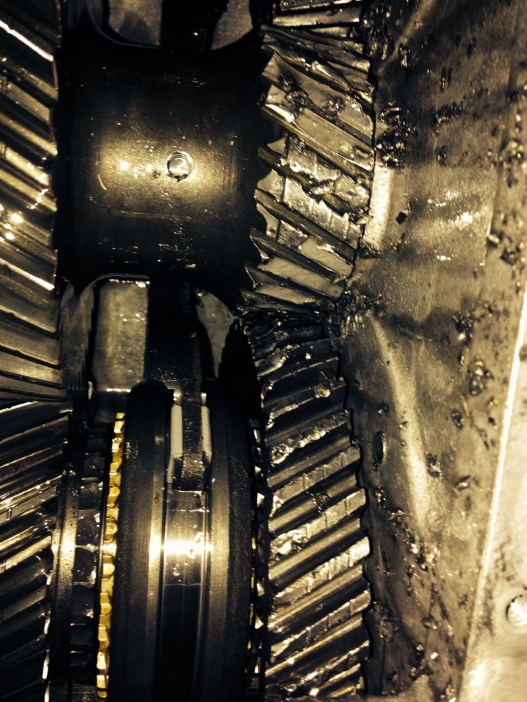

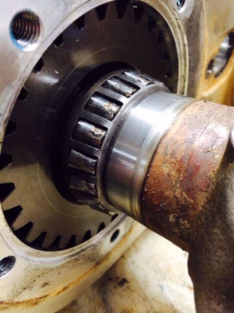

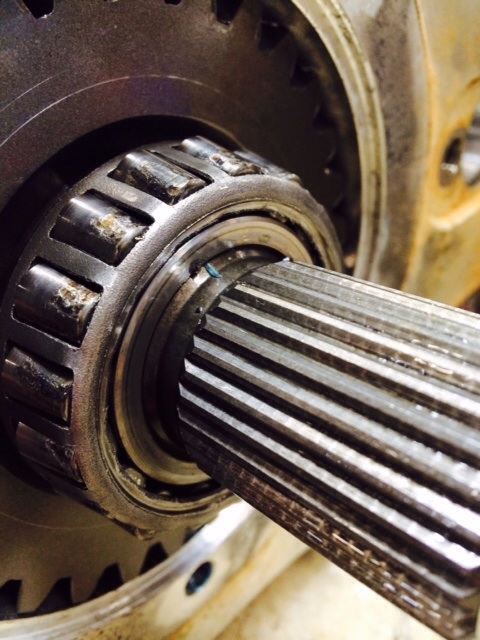

I do not know many people that have broken as many 1410 yokes as I have but here is a little advice on a atlas yoke. Do not ever put a plain spicer yoke back onto a atlas with out the taper portion on it below is what your atlas will look like. Now it is not like I didn't give atlas yokes a chance but after breaking 4 of them I was getting tired of it. Now after switching to the spicer that stopped but as you can see not good on the tcase. View attachment 168951View attachment 168952 View attachment 168954 View attachment 168953
Learned that the hard way this weekend.

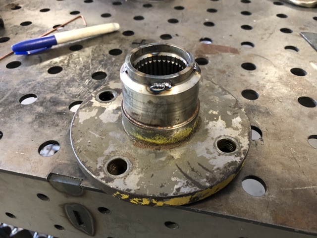

I ended up turning a spacer and welding it to my existing flange that didn’t have the tapper.
My case has been running the flat yoke for a bit, and it “clearanced” itself. I need to open it and probably rebuild it now.
Just wanted to bring this back up for people to know. Don’t make the same mistake I and @Landcruzn did.
