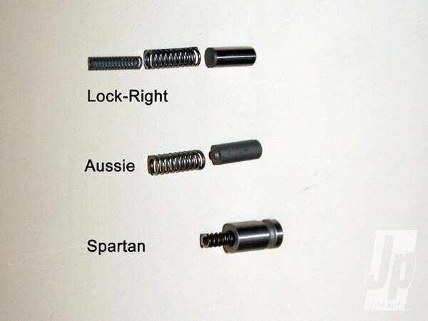

Lockright has the smallest pins of the 3, but I can't remember which of the other 2 is better. There is a best choice, but I can remember which. Just that it's not Lockright.
I do hear very good things about Aussie. If I were to order one right now, it would not be a LockRight. Not that it is bad, but because I know Spartan is better. It has a harder cross pin too.
This is why I would go with Spartan.
I think this alone makes the Spartan the better locker. This style of locker puts all the stress on the cross pin. I would never think of installing a luchbox locker without a hardend crosspin. The Spartan comes with one, so its the better deal.
hardened cross pins are a catch 22, with the hardened pin the weakest part of the diff is now the carrier. and it can cause the carrier to break.
after i busted a carrier, i started using a regular pin and carried a spare. its easier to replace on the trail and you can keep wheeling. if you break a carrier your back on the trailer going home.
