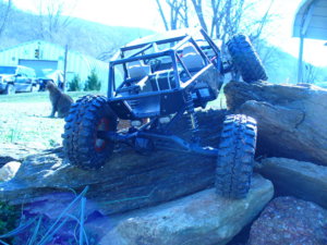

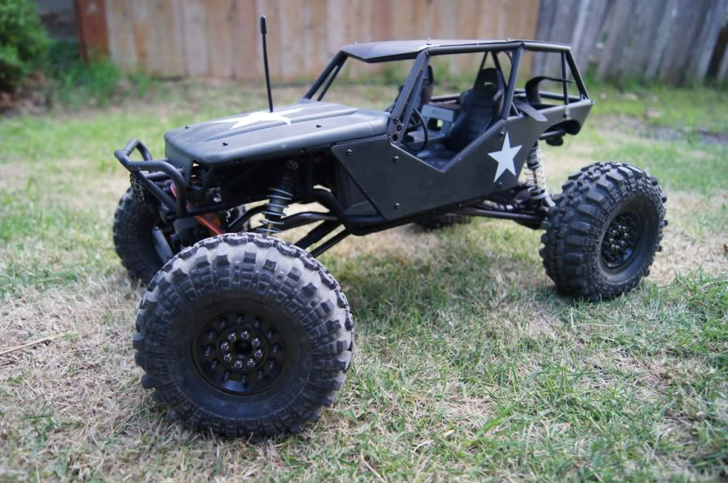

Crappy pics, but here's mine.

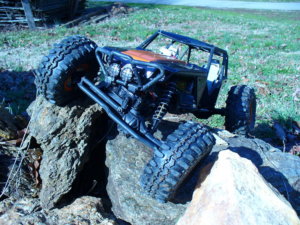

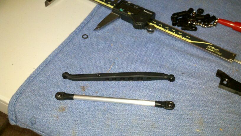

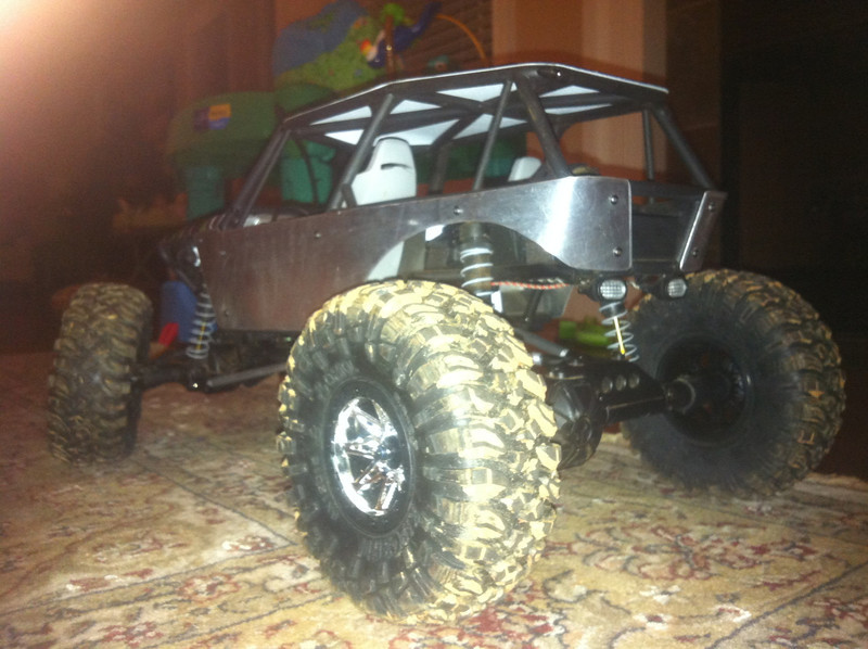

I made my own aluminum links both front and rear. Also flipped the lower link / shock mounts upside down to lower the rig.

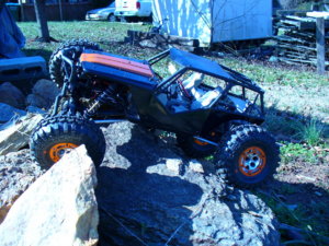

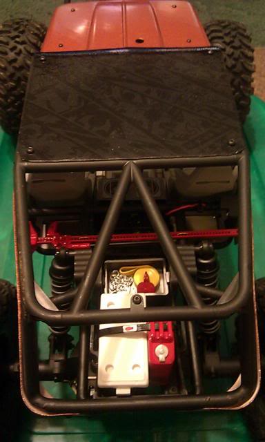

Aluminum skins.

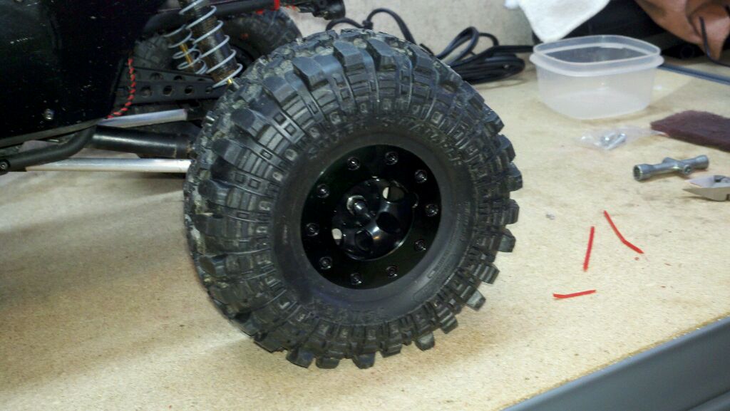

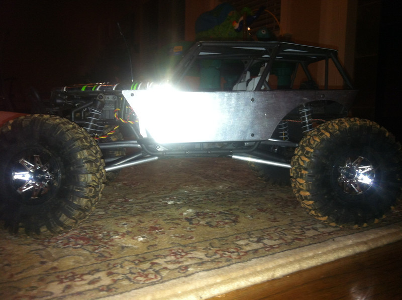

Some TSL SX's with Proline beadlocks.

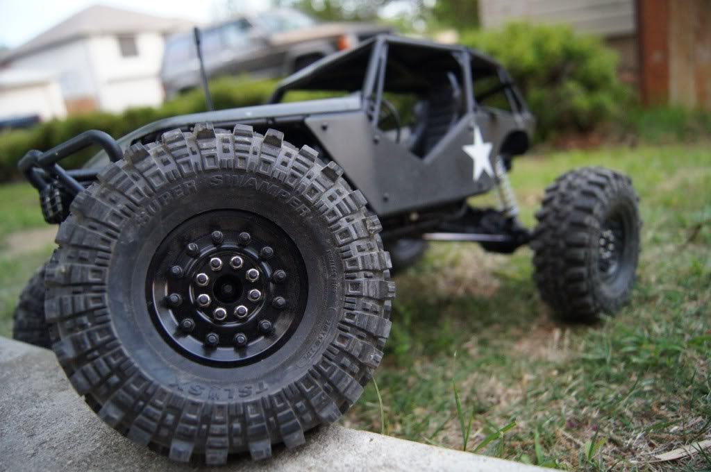

A few other small things like a 55t Integy motor, alum servo horn, high torque server, and moved the battery to the front.
^^ Any pics of your relocated battery? I would like to move mine. Probably gonna do your tip for link arms. Just haven't been able to get to the hobby shop.
So far, I have backd off the nuts on the shocks and moved the upper shock points to the inner position. That dropped the whole truck about 3/8 inch. Seemed to help body roll.

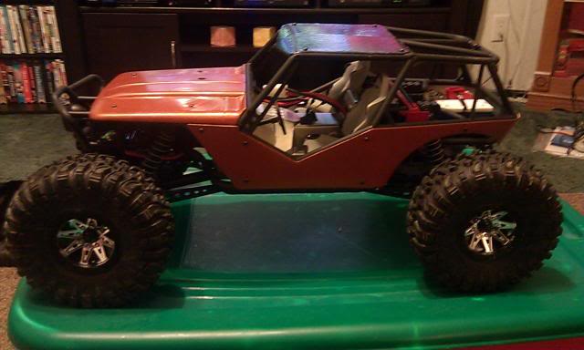

ok been messing with mine a little bit.

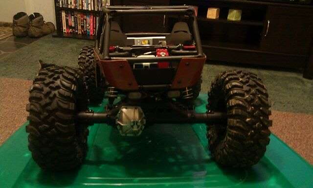

new paint,flipped rear upper shock mounts,moved front shocks to rear position,relocated battery to front and esc in rear,15/87 pinion and spur gear(best mod yet),added few scale goodies i had laying around.
next is lipo,steering servo+arm,35-45 turn motor.

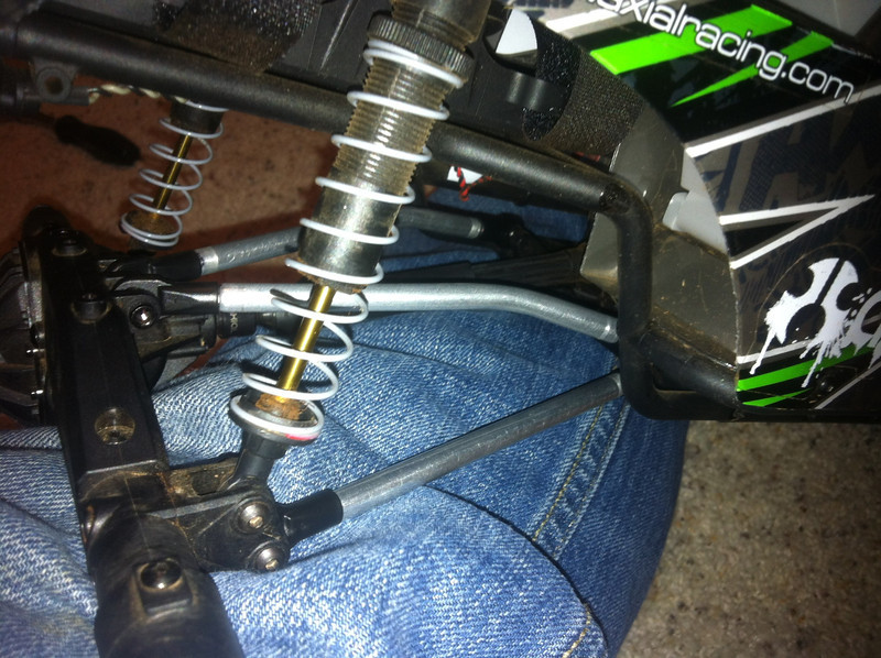

Started my links tonight. One down......

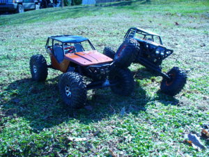

Went up to check on the 1:1 rig at novacayne's place today. Just HAD to break out the Wraith's while I was there. LOL

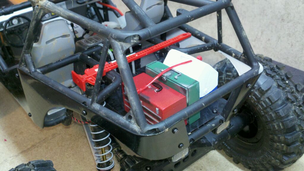

Got a few scale items in.
Also found a set of Proline 8 shooter wheels with wide rings

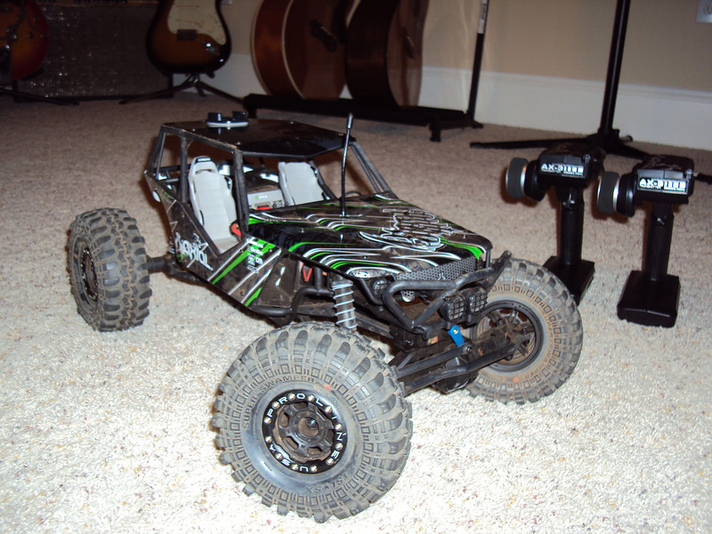

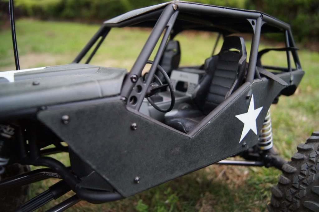

I tried old school. Hand painted with a matte finish. I added Pro-Line Slash rear shocks and heavy scale Humvee wheels. The wheels are a pain to setup the tire but they are worth it!
