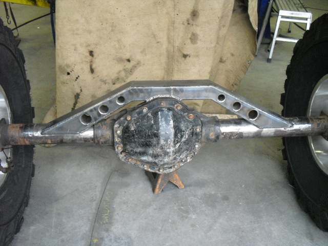

Just in case your interested.Here are some that are more unique. thanks pj
http://mandmoffroad.com/id71.html
thanks pj
X2 on the Mudpro 14 bolt Truss.

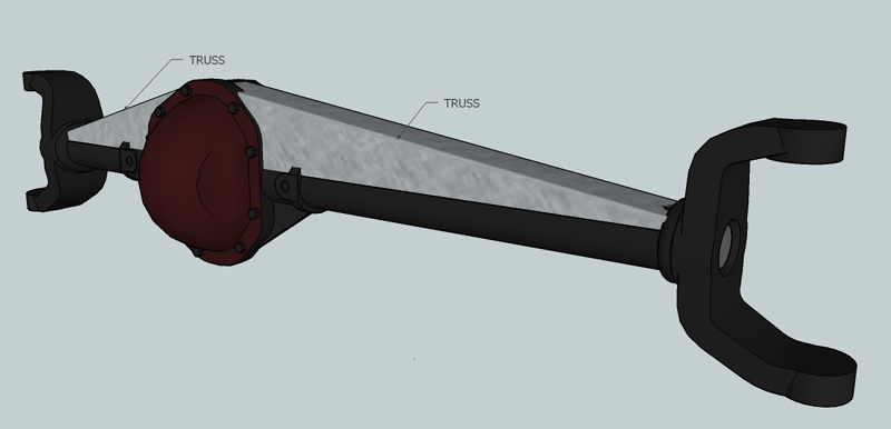

I might recommend something different for the front. The BTF looks to mount everything pretty high, thus limiting your upward travel. Or forcing you to set your ride height up more than you might like.

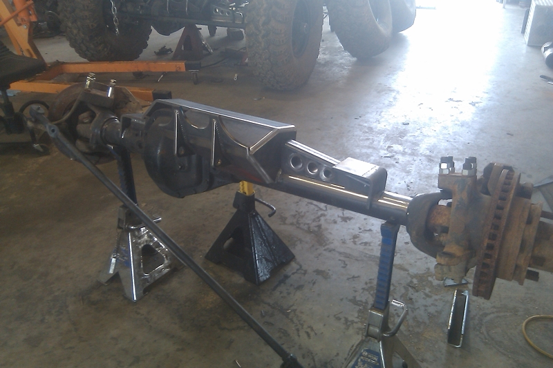

I prefer building our front trusses low, like this. Nothing higher than the center section!
I you want something pretty close to BTF's this is one I built like it or if you'd like something a little different I can do that too.
Chris, I may stop by sometime to discuss since you're just a few miles away. I don't see your dodge any more at Pharr Mill Road/49...did you move shops or going in later due to the baby? It doesn't have to be similar to anybody else's design...I know most fabricators like to put their own spin on their stuff. My main concerns are bracing the axles (obviously), allowing link mounts on the d60 & protecting the steering ram. I like ol' Jeeps idea of keeping in low, my rig is too tall as it is!

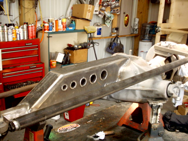

I'll give a nod to PJ @ MandM on his trusses. I used his rear 14bolt truss on my last build and loved it. Lots of contact area to weld to the housing and simple to put together. It will take a little bit longer than just the plate style trusses, but IMO the finished product is worth it.
