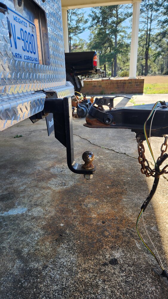

It'd be helpful to see a picture of the back of the bed and how everything is mounted. I'm betting you could rotate the license plate light(s) though, so they shine downward...if they're not already.

This is the only photo I have of it on my phone right now. You can barely see the tag light on the far left side of the plate.

Looks like it shines sideways. I'd move it and make it shine downward and away from the camera. Seems pretty easy.

Is that the Light to the left of the plate, then the camera directly above the plate? All surround by one of the most reflective surfaces you could have on the back of a truck, Diamond plate?
If so, you need to unplug the light and plug it back in for inspections or when LEO pulls you. Or relocate the light. it's going to reflect all over that diamond plate.

Yeah, and it's LED, so it's super bright. I've seen a version of a tag light defeat on eBay for Jeep and Tacoma, but I guess I'm solo in this issue. I'll try what @jeepn-jason referenced earlier so it still functions normally.
