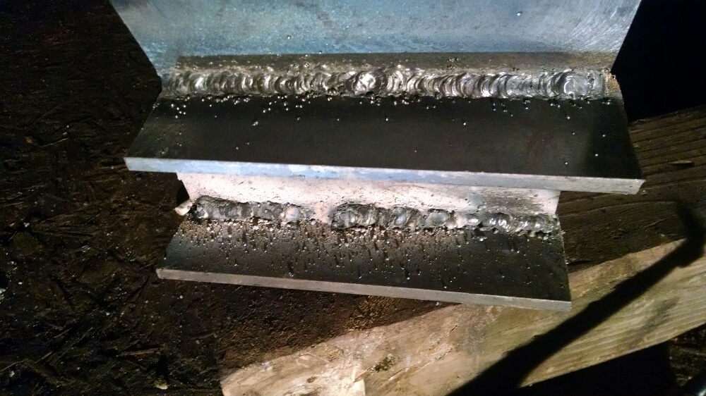

Ran out of wire, no problem, I keep a spare spool.
And welds went to crap. Way more spatter, inconsistent burn. First spool of hot max wire I've had like that. Lincoln, Hobart wire runs terribly in my AC machine. Wonder if they changed flux formulations... I guess I'll try spooling half off and see if it gets better.
AC ????? I don't think I've ever saw or heard of anybody attempting AC flux core. Most if not all cores wires require either DCEN or DCEP. Depends on the manufacturer and mostly if it's inner or outershield. This is a new one on me.

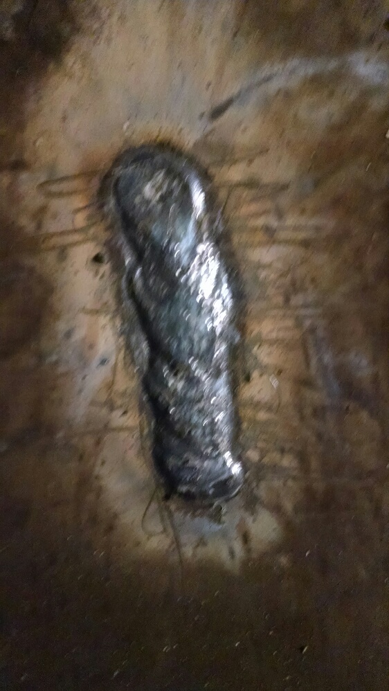

Yeah the owners manual says says it's AC. This particular wire didn't specify DC, and the previous spool was the top weld.. Liner go bad in just one change of a spool? I think it's the wire.. tried different tips. No change. Wire feed is smooth, arc just didn't burn clean. Kinda like the arc was being extinguished momentarily. I'll get another spool tomorrow..
Any rust on the wire?
Have you tried running DC? Is this dual shield? What shielding gas?

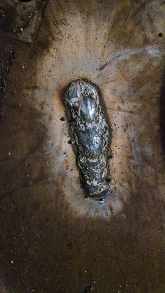

I had welded a lot with my Hobart, no problems with flux wire. Then welder sat for a year, maybe. It's in my dry basement. I tried welding something, & the wire kept burning to the tips. Over some time, I tried several things, with no luck. I gave it up, & used the old Stick! A couple months back, I bought a new spool at Northern, & more tips, just to use some coupons with another purchase. I finally loaded the New reel, & did some trial welding. Then I welded up a crack in my tire carrier. No Problems! I think the old wire drew moisture, or Something happened to it!
Yes it was the wire. Got a spool at HF and.... Just a flywheel coupon. Didn't touch any settings. Not that this one has a lot of settings lol. No prep was performed, just laid it to that somewhat greasy thing.
