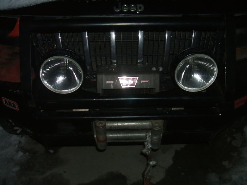

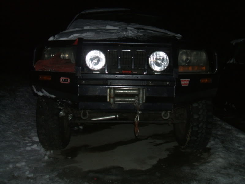

I mounted an xd9000i on my ARB today. I remembered seeing this thread and thought I'd post some pics.

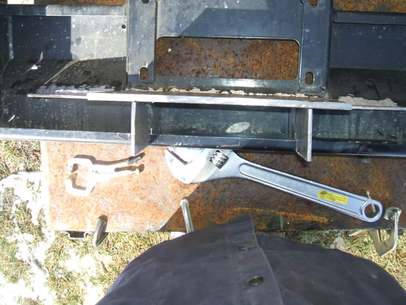

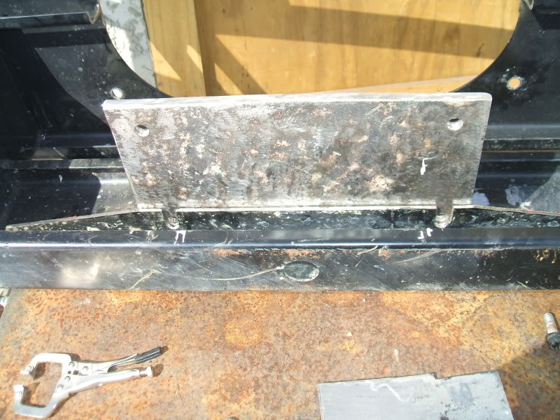

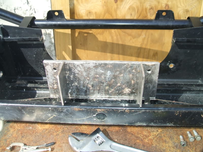

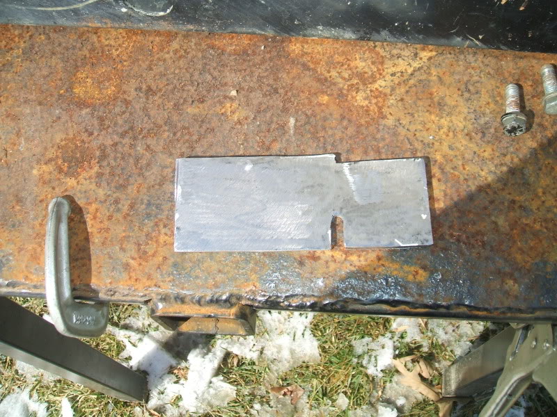

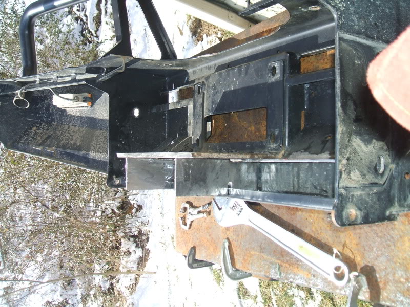

Got that new winch mounted today. One of my first fab projects. The winch tray is 1/4" and the bottom gussets are 3/16's.
Winch plate:
One of the gussets:
Mocked up:

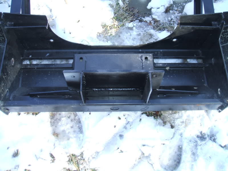

Welded and painted:
and finally on the jeep!
