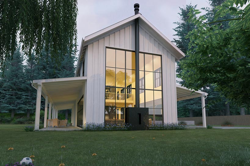

We like this design pictured below, not necessarily with the huge window on the end but tall with steep roof and porches on both sides. We want concrete floor and of course concrete under porches but probably with a step down to stop any water. We want a large open floor plan with kitchen on one end and loft above that. I think 30x50 or 30x60 would do us well, it’s just the 2 of us.
@trailhugger told me back then to orient it with the peak running east/west and with enough overhang to mitigate summer sun but not so much as to stop winter sun. Thinking sprayed insulation and good mini-split system and woodstove.
