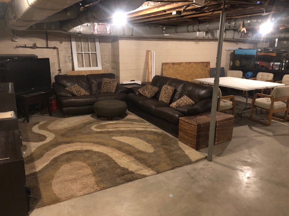

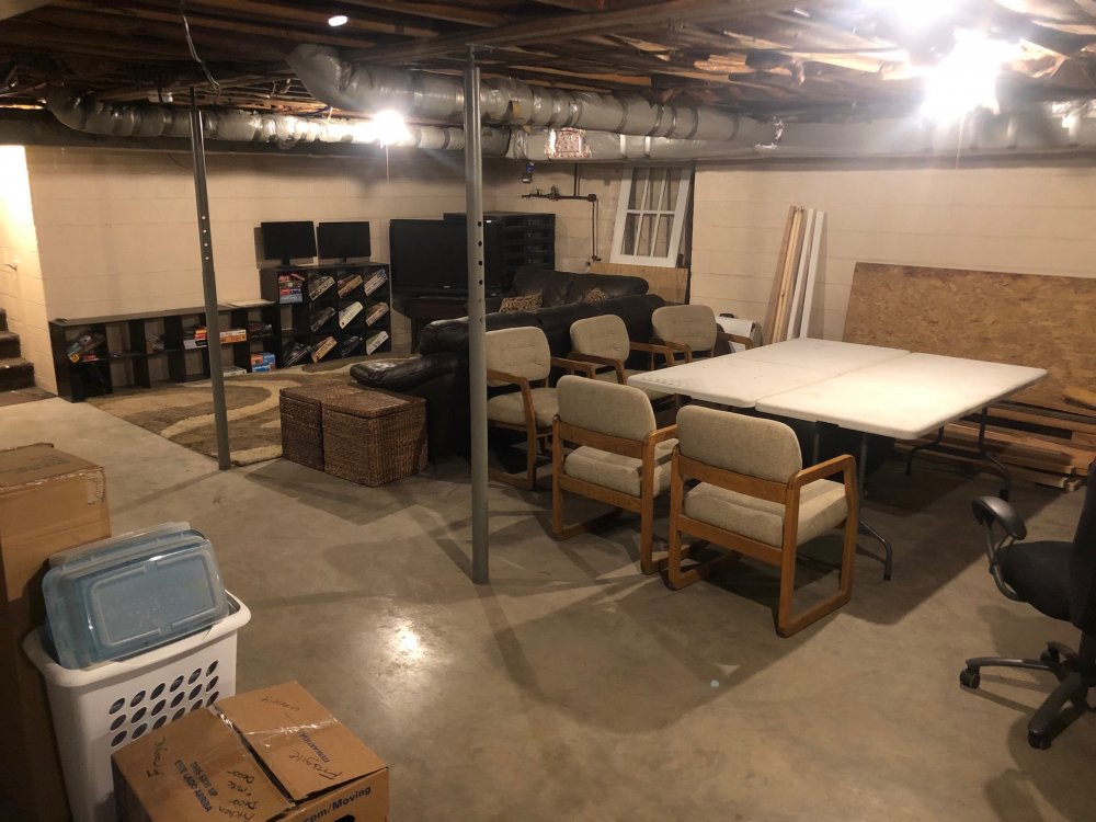

As you can see in my pictures, the heat/ac ductwork is overhead and all very nicely insulated/wrapped, etc. My question is...can I replace those with "slimmer" profile ductwork? Without doing the exact math, I assume a say 8" round pipe could funnel the same air as say a 3"x10" rectangle duct? Thus gaining me several extra inches overhead?
I actually do not hit my head on anything at 5'9", have not measured it but I am guessing for the most part well over 6' to bottom of even the biggest ducts but if I was to put in drop ceiling that low, it would be "too low" and feel cramped / odd.
If I say did JUST around the ducts that low and the rest of the ceiling was up closer to the ceiling that would give me more head room but "look weird" to have all these odd / square areas? Thus the thought of trying to replace the ducts with lower profile (and wider) so maybe I could end up at close to 7' or so for even height for drop ceiling?
I keep saying drop ceiling, mostly because I suspect keeping easy access to all the wires, plumbing etc is a good idea vs a permanent / drywall roof...willing to hear any and all thoughts or options here.

Looks about identical to my basement. I would go with an ACT ceiling (drop ceiling) it's great to have access to plumbing and only replace a few tiles if something leaks. Just go with the cheapest tile you can find. You could call Colonial Material or L&W supply to see if they will sell to the public. I could possibly help with getting a discount from them if they will sell to you.
you can still do bulkheads around trunk lines and run tile vertical to go back up to the main ceiling height. You'll just need hold down clips to keep the vertical tiles in place.

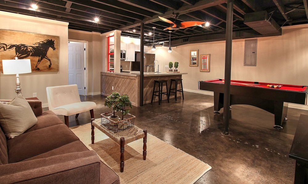

Shooting from the hip here.... anybody that knows what they’re doing, feel free to correct me if this is a terrible idea. Maybe swap out your fiberglass insulation for some foam board insulation, tidy up all the exposed wiring, etc. as much as you can and spray it all black like you mentioned.
Would maximize your ceiling height and you would still have access to everything if you needed to repair something.
Could look good if done right.

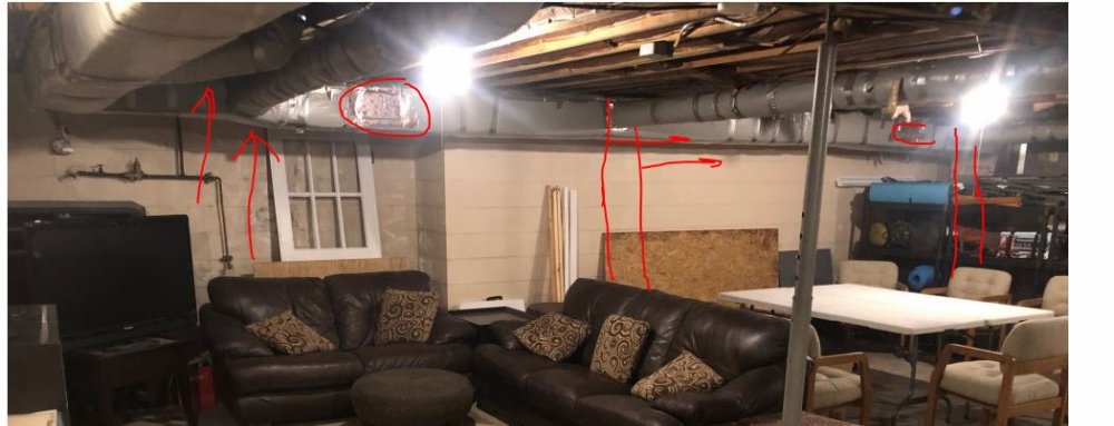

Currently the basement is not air conditioned, but if you look at the picture you will see they DID put in vents in the ductwork, thinking someday it would be! They are all covered up very tightly with AC 'duct tape' of some sort. So the thought is when I basically wall off the "workshop" / garage space from the rest of this, I will uncover those and it WILL then become part of the heated / cooled space. This is pretty important for a couple reasons, the first is simply nicer to be in and the second is I want to be able to store / play my acoustic guitars in this area too!!
My wife and I walked around over the weekend and I think that by being creative on my wall placement, I will actually "enclose" most of the offending ductwork anyway! I am really down to just 2 ducts left that will be "in the way" so I think I can replace just those 2 instead of my original plan of having to replace a LOT of those! My crappy pic below, you can see circled the vents that are currently covered up, will be uncovered. And the the straight lines down on either side of the ductworks is where we have decided to put a wall between the couch and where the conference room table is. (And another wall on far end where shelving is at, between this area and the rest of the basement / garage space. Finally you can see 2 arrows, those are the only ducts left that really will be "in the way"
