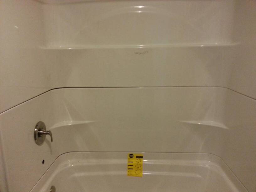

Ok went acrylic tub. Now its whipping me. Any insights on why the gaps suck?
Walls probably aren't square. Did you shim it?
The seams in those things are the exact reason why I hate them. No way to ever make them look nice.
Poor casting...can you get it to fit together proper if you pull it out from the wall Wmd just do a test fit?
It is already pulled away from the back wall some. That helped it some. I stacked all three piece together with no screws and wiggled it around to find the best fit. And unfortunately this is it. It's getting me down a bit because if it doesn't look right then the whole bathroom will look half assed. I don't really want that. I wouldn't be happy if I payed someone to do that. I've also thought about spacing the other parts up to match the gap.
At first I thought it was the sub floor. It is old and is just 1x12's on the diagonal. So I removed the whole thing and put down a nice new piece of plywood under the shower/tub section. That helped some with the levelness and rocking.
In all honestly I did a lot of different things today to get it to look right and I don't think that I ever got that gap to look right.
It is off the back wall about 9/16" and off the right wall 5/8" (61" opening w/ 60" tub/shower) So there is not anything physically preventing it from going down. I don't think.
