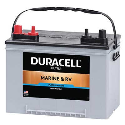

There is also this which looks identical to the Duracell and has identical specs. It is probably rebranded.

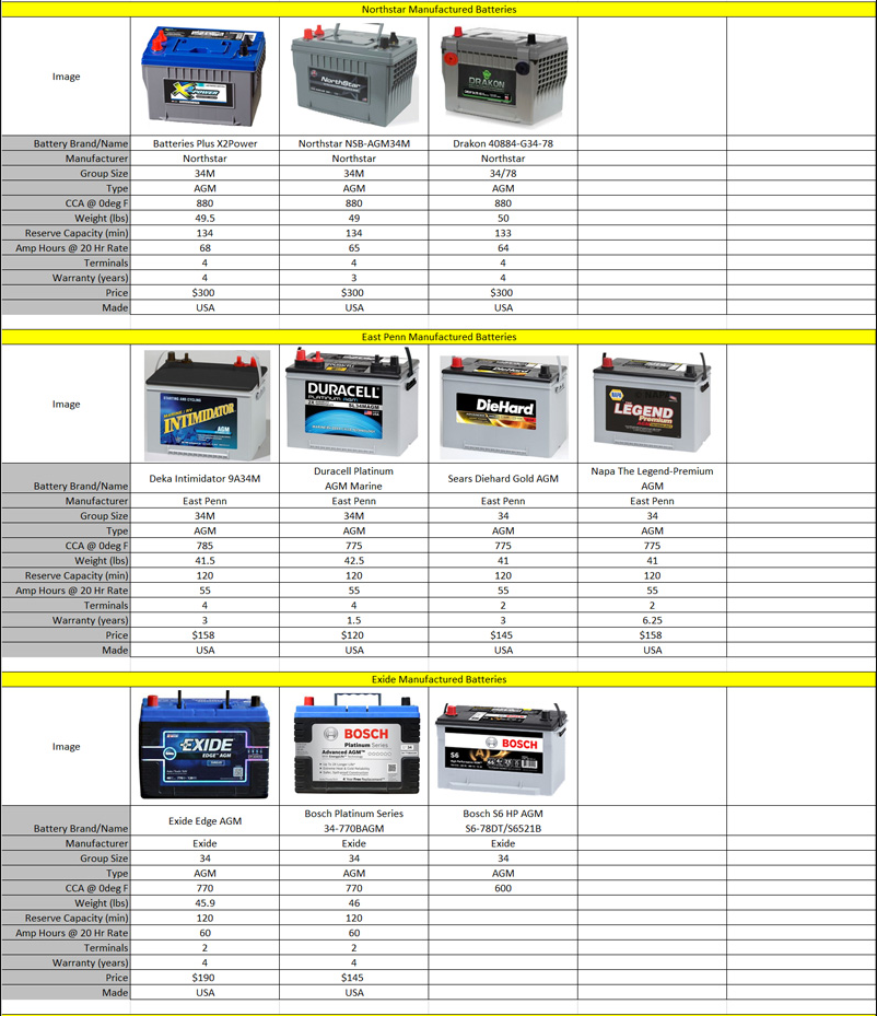

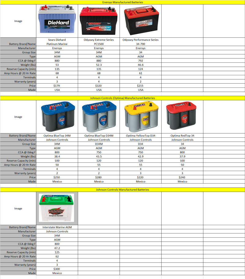

I may have posted this before... can't take credit for assembling all the data. I found it somewhere. Note that the Diehard Platinum is no longer an Odyssey battery, but the Batteries Plus/Northstar batteries are (same parent company)
@ponykilr do NOT buy an Optima. Just don’t waste your money.

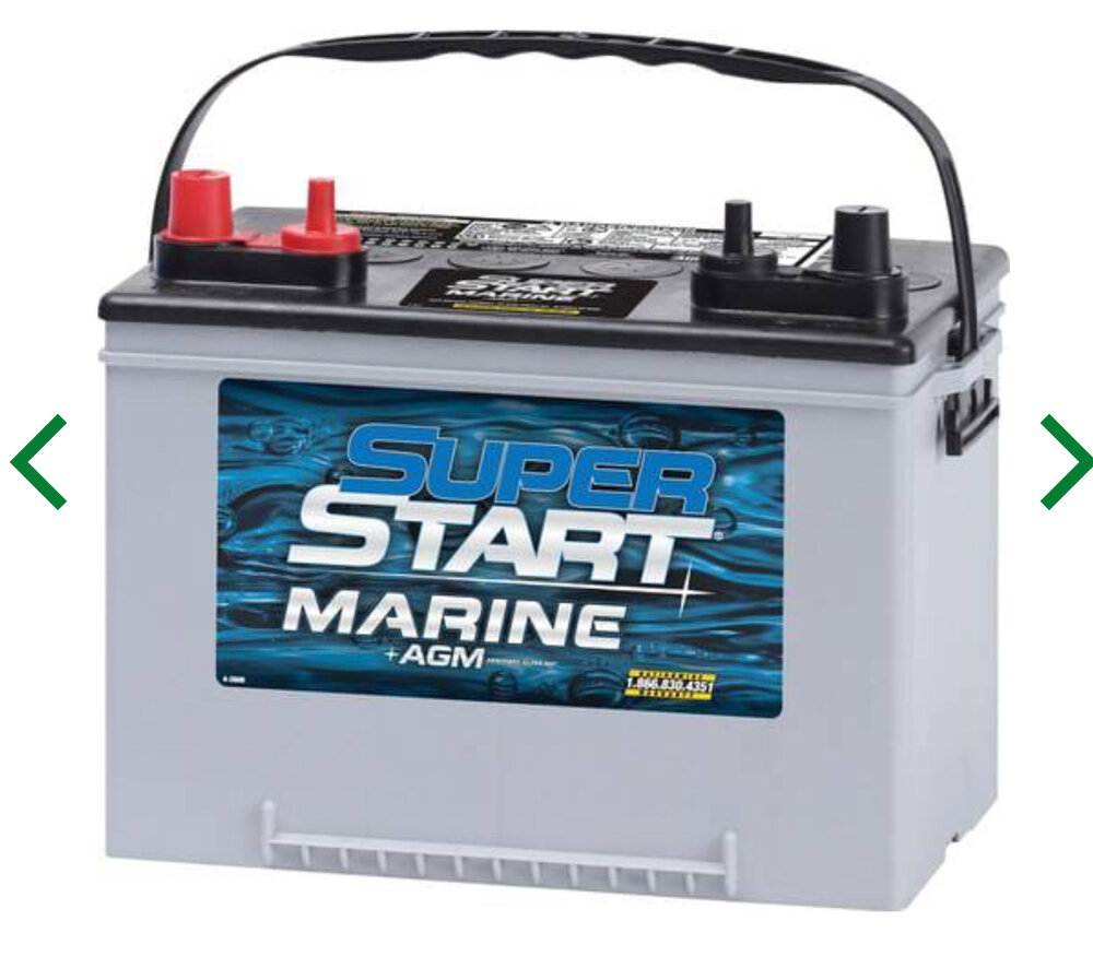

As for your question, AGM isn’t exactly a bigger/deeper cycle battery. It’s Absorbed Glass Material inside therefore no battery acid and water type deal. The Super Start you posted would be good. Any good deep cycle marine battery would be good. I’ve had countless Red Optimas die on me, and was about to switch till I realized it was still under warranty and they let me pay the difference ($60) to move to a yellow top. If it weren’t for that I’d have switched. Optima used to be good but something changed 5-7 years ago and they’re garbage now.
