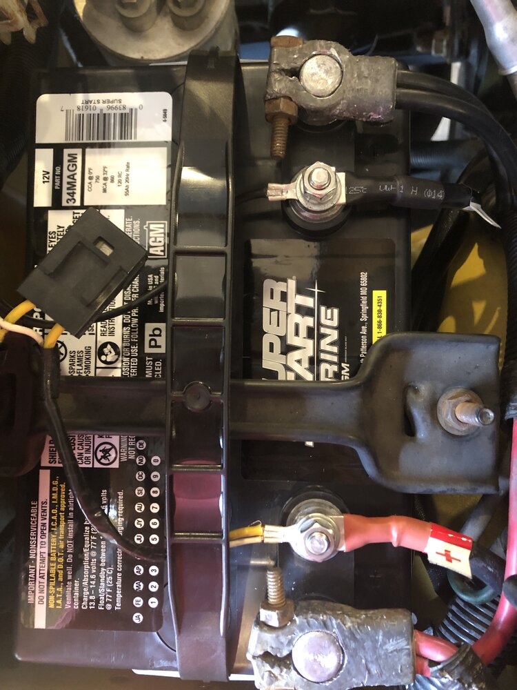

The battery is in 👍🏻 I saved about 12 bucks due to the commercial discount. It is very nice having the threaded studs for the winch and light relay connections.

The battery is night and day. I pulled most of the way without stopping. When I put the smart charger on it, it still held 90% reserve. I left the charger on it a couple of hours and it went to float.
👍🏻👍🏻Up for O’Reilly Marine AGM.
