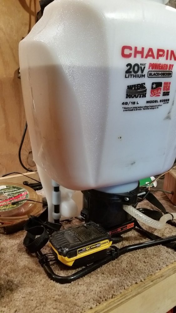

So I recently bought a battery powered backpack sprayer. A Chapin Pro that is powered by a Black and Decker 20V lithium battery. It is one of those "why didn't I buy this sooner" items. My old Chapin Pro backpack was hand pump and this one is unbelievably more convenient and less tiring.
All of my other tools are DeWalt and I looked high and low for some sprayer somewhere that uses DeWalt batteries.
There is no such animal.
So I bought the Chapin and loved it, except the fact that I now had to keep up with a different battery and charger.
So I resigned myself to my fate but I looked and looked for an adapter. It seems there are adapters on ebay that adapt every powertool to a different battery except..... No 20v B&D to DeWalt that I ever found. The fact that the battery is already on the bottom of the sprayer and would have an adapter and new battery hang lower than the frame aside, I wanted to get away from having different batteries.

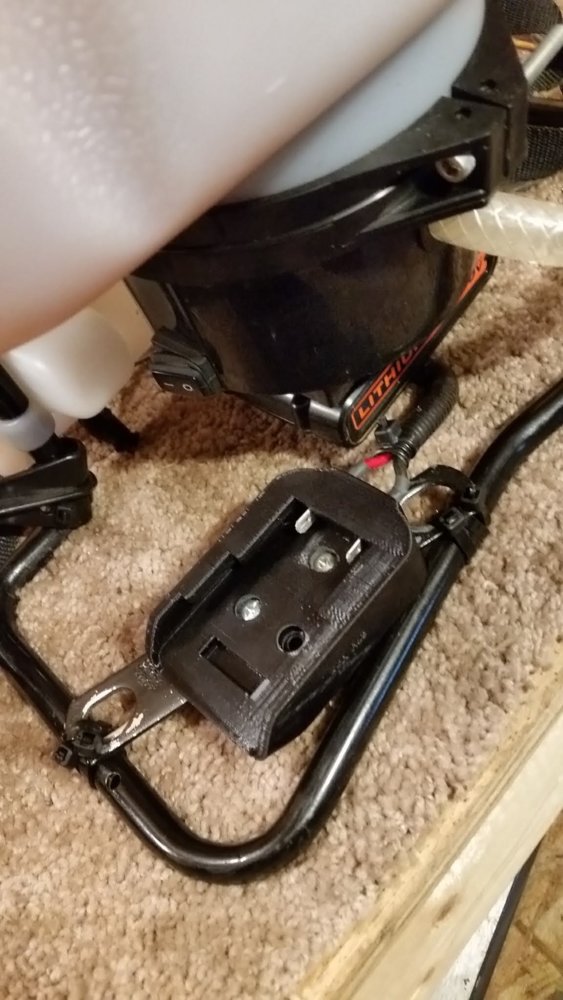

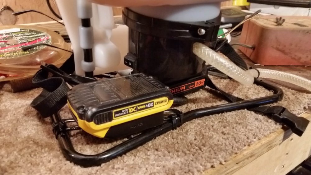

I stumbled on a guy who 3D prints battery holder/receivers for 20V DeWalt batteries that have two 12g wire leads and nice heavy pins and construction for $16 + 3.50 shipping. I spoke with him on the phone and he thought my idea was good.

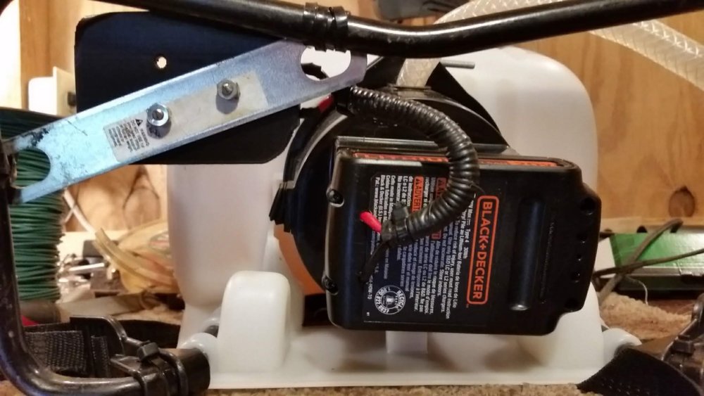

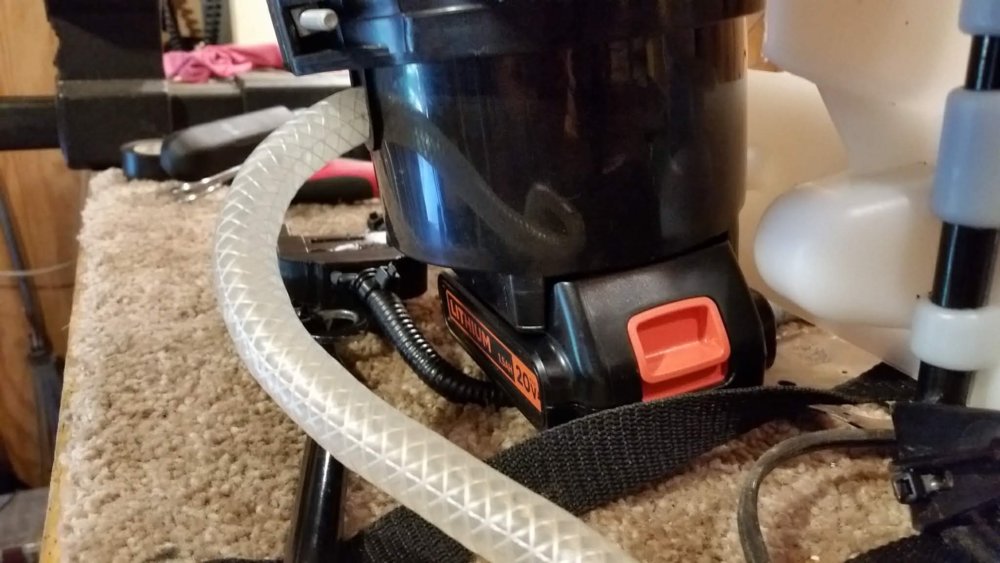

I would gut the B&D battery and attach the leads from his receiver to the pins in the old battery through drilled holes and mount the receiver on the frame. Voila! DeWalt powered sprayer.
Well it all worked as planned. A quick bracket and some soldering and drilling and it works like a charm. The bracket is double ziptied now but I plan to clamp it with wire clamps or even stainless hose clamps.
