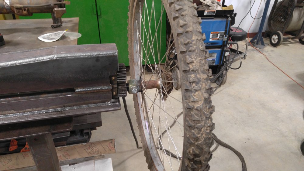

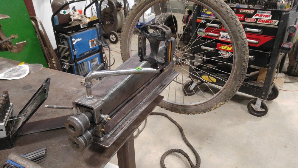

A friend gave me an el cheapo roller. I'm gonna be up grading to a motor feed. Still one man is a pain....but I was single pass rolling .090 aluminum with a 5/16 head.
![Stick Out Tongue :p :p](/styles/nc4x4/xenforo/smilies/tongue.gif)
No where near ideal or useful but it didn't deflect.
I've also made it a bit heavy.
![Frown :( :(](/styles/nc4x4/xenforo/smilies/frown.gif)
I incorporated a clamping rail on the front for a guide.
