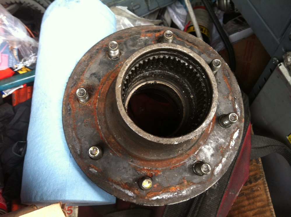

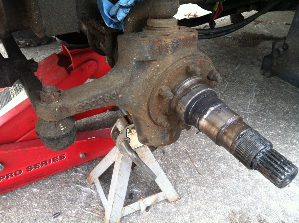

Is a Dana 44, 8lug hub need inner and outer bearings and seals for said hub, telling parts house I need it for a "Zamboni" brings blank stares ( it really is for a Zamboni)
Need to get this back up by 5pm if at all possible
Production date on diff cover is 8/92, think a Dodge 2500 of that era would cross ?
Inner bearing fragged, causing wheel lock up, was fun to get apart
I did go to CQ and ask for bearings and seal for '92 W250 w/5.9 gas everything matched what was left of what I took out, but the outer race for inner bearing just drops into hub, not good, it's either had the wrong bearing in it for awhile, or the hub is wallowed out (left hub, constant hard right turns in 4wd so I can see it after 10000+ hrs, will see what right side looks like tomorrow, it's back together and being used at the time.
Looks like Chevy D44 outers to me.
If its a big bearing 44 spindle you can use a 78 jeep cherokee chief as a reference. if i recall 77 was the cut off year for the small bearing vs big bearing spindle.
Looks 44 except the large spindle studs!
If you still cant get it identified, if you call me with all the bearing and race dimensions. I have a Timken book that you can ID the bearing and race by dimensions
