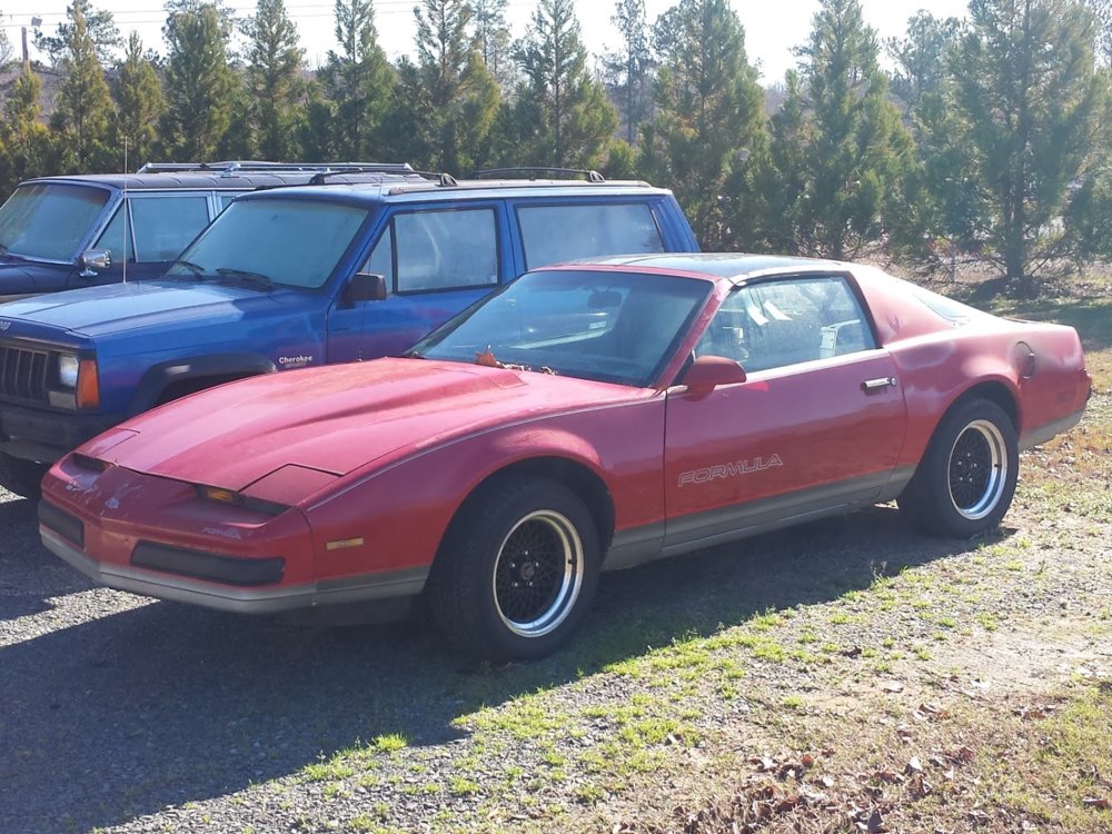

So what is the car? It is a raggedy ass 89 Firebird Formula WS6. Car started life as a 305 TBI 700R4 car, then went to a 350, then to a 355, then back to a 305. Somewhere along the line a rebuilt T5 got swapped into it. The 305 runs awesome and the T5 shifts good. The car leaks like any respectable t-top 3rd gen does and the interior is equally ratty. The good thing is the drivetrain is solid and the suspension is tight, along with the body not being rusted out.

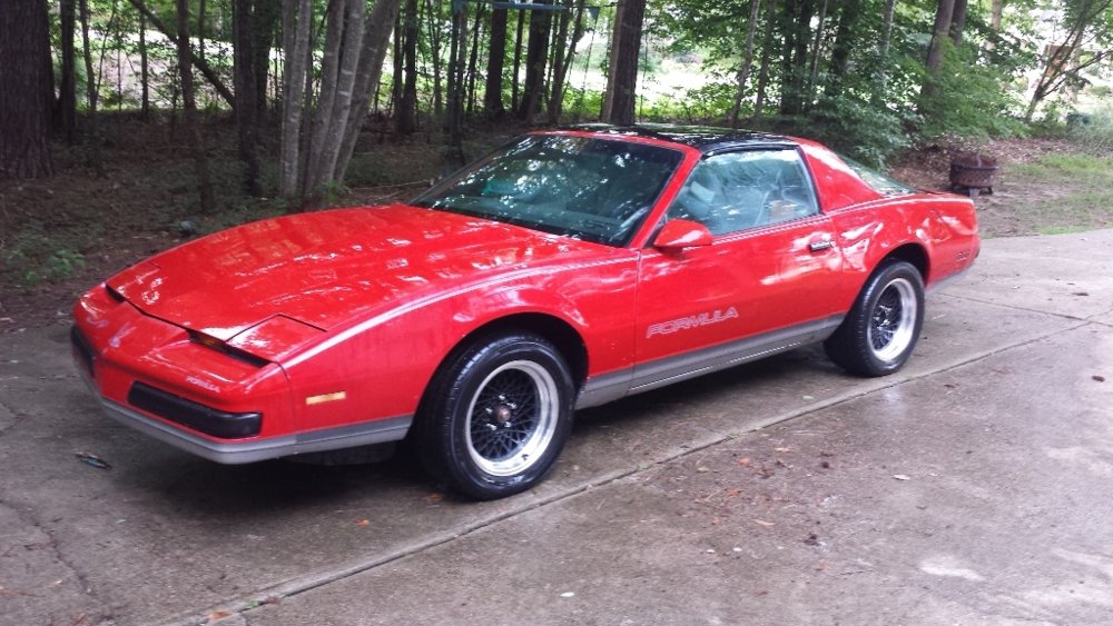

So here she is in all it's glory.

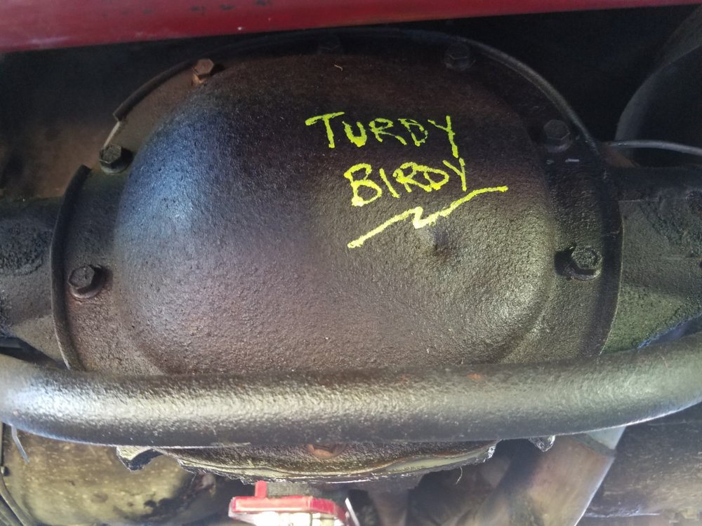

So now that the TA is done other than a tune, time to start working on the Formula. Started with a bath yesterday and woke it from its slumber beside the shop. first order of business is going to be to do the rearend. It is only a 7.5" rear axle, but this will be a road course car with a high rpm motor that will make it's power higher in the range. I won't be launching this or doing anything that will really kill the rear axle. It currently is an open rear with 2.73 gears (car was originally auto, never regeared, yikes) so we are going to upgrade it with 28-spline axles, a Zexel-Torsen posi, and 3.73 gears. Should put us in the sweet spot for the speed class we are running.

So ran into the wonderful issue you have with buying parts and letting them sit so long that you forget what you bought. Car had 2.73 gears originally, so had a 2-series carrier. The 3.73 gears I had are thick gears. The new posi unit is a 3-series carrier, so the gears won't fit. Argh. Had to order some new gears, should be here Friday.
So the Formula got some goodies finished up today. Gears are in, posi is in, new axle shafts are in. Also swapped 4th gen LS1 rear disc brakes onto it, along with Spohn LCAs, panhard bar, and adjustable torque arm. Now it is coming home to finish the spoiler and send it off for cage work.
