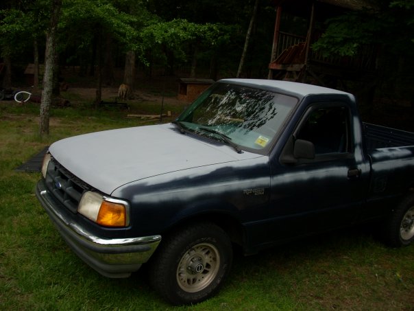

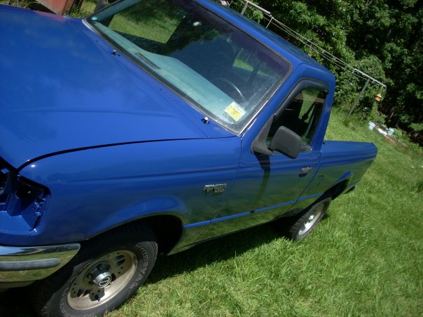

Maybe I'm bored, maybe I'm excited to wheel this thing, maybe I wanna show off my hard work!
Bought this Ranger in the condition you see. Made a few pick ups at a local salvage yard and made a stop by Tractor Supply for New Holland blue Ford paint. Spend some time scuffing it up and sprayed some rattle can at it. Didn't turn out too badly at all!

Not to hijack, but I'd recommend clear coating it if you don't want it to fade and its not going to be garage kept. I painted mine in '08 & when I sold it in '12 it had faded pretty bad since it was always outside.
Before: ranger1.jpg After ('08): ranger2.jpg After ('12): ranger3.jpg

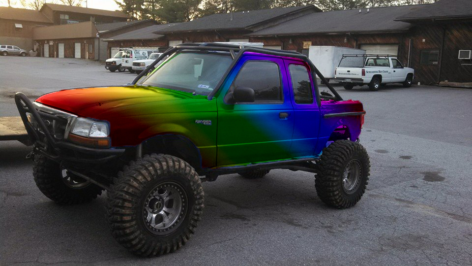

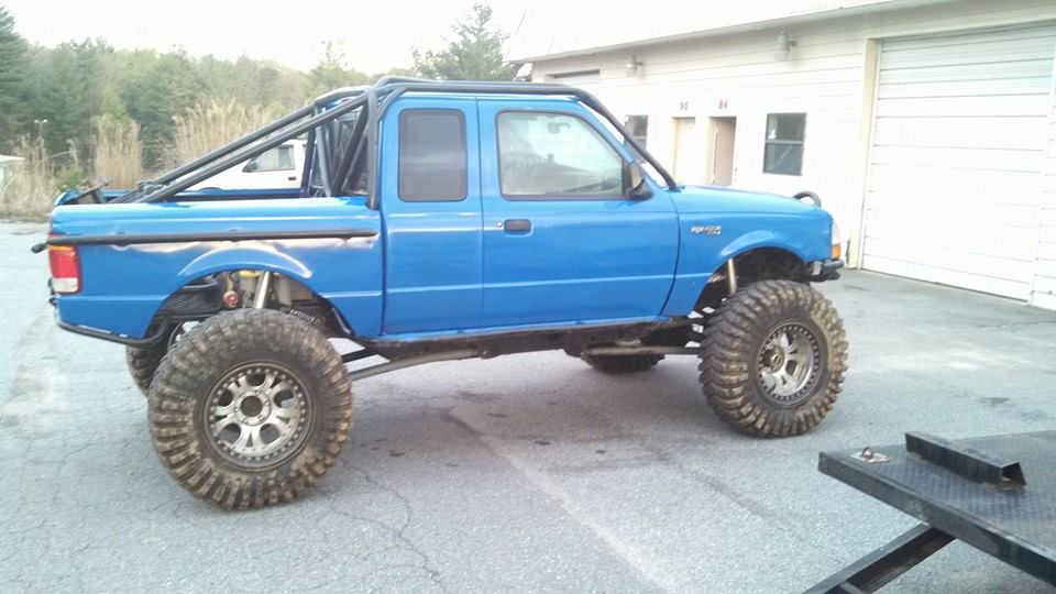

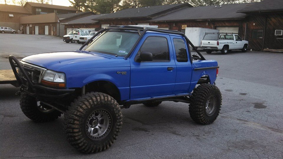

Looks like a really good spray bomb job! I don't know if it is the color or what it is, but it looks much better. Any tips on getting it to come out so nice? I'd be afraid to wheel it now if it was mine, lol!
What are the specs on that truck? I like it. I think I remember seeing it for sale on here a while back.

Mustang 306, B cam, GT40p heads, etc. C6, flipped 300, 44 front ARB, Superiors and Longfields and a Moser 8.8 out back. 3 link front and 4 link rear on Fox 2.5 air shocks. Pretty legit rig. Climbs like a drunken mountain goat and has a litle bit of "whoopow".
