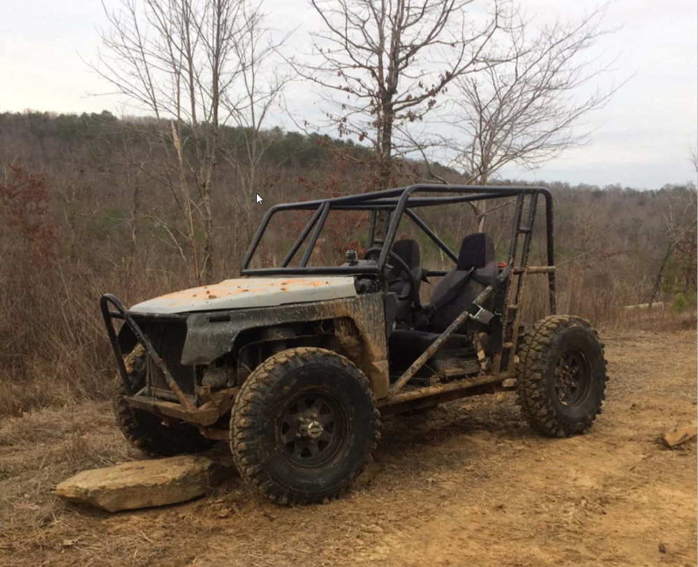

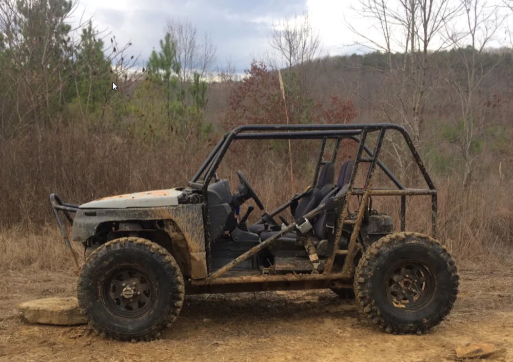

Just some random ones from Pirate that I have seen over the last few years:
https://www.pirate4x4.com/forum/suzuki/1543066-my-geo-tracker-side-side.html
Tracker buggy - Pirate4x4.Com : 4x4 and Off-Road Forum

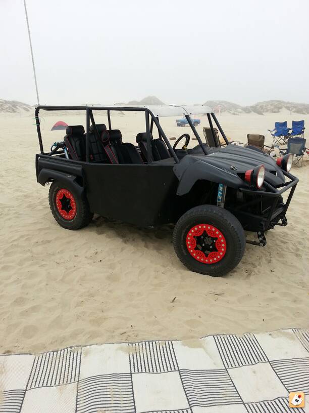

T-rex
Also, alot of folks have had success running SxS tires on these things. They tend to be lighter, with deeper tread and bigger voids, compared to a LT tire. This likely isnt the best move if it is seeing street time though.

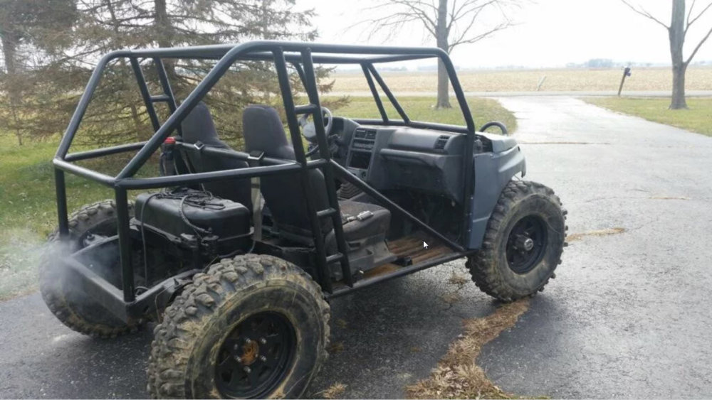

That is pretty much what I had, but built just a little more. Even with YJ springs, it didn't ride as well as I wanted. Most of that was probably due to the limited up travel of only 2-3". I was thinking the IFS and coil spring suspension of the Track/Kick would ride better for a simple trail rig. Plus cutting up a rig up to the point of only leaving the firewall and floorboards just seems like a boat load of fun.
The link to the Jew Buggy that was posted is pretty much exactly what I have been day dreaming about. It could be done SUPER cheap.
Mine was basically the same thing, but with a little more sheetmetal. I want to say I had less than $2000 in mine. Purchased it for $500; got it running good; gutted as much as i wanted; welded diffs; caged it; bought tires. Had almost as much in tires as the rest of it.
Front what I am seeing is that the whole SxS front end is difficult to pull off. The T-Rex thing would look a lot better without the headlight deal. So in the vein of the copper crawler. How, would would skin the front to give it a good looking body. I need something that is going to look good at the mall.
