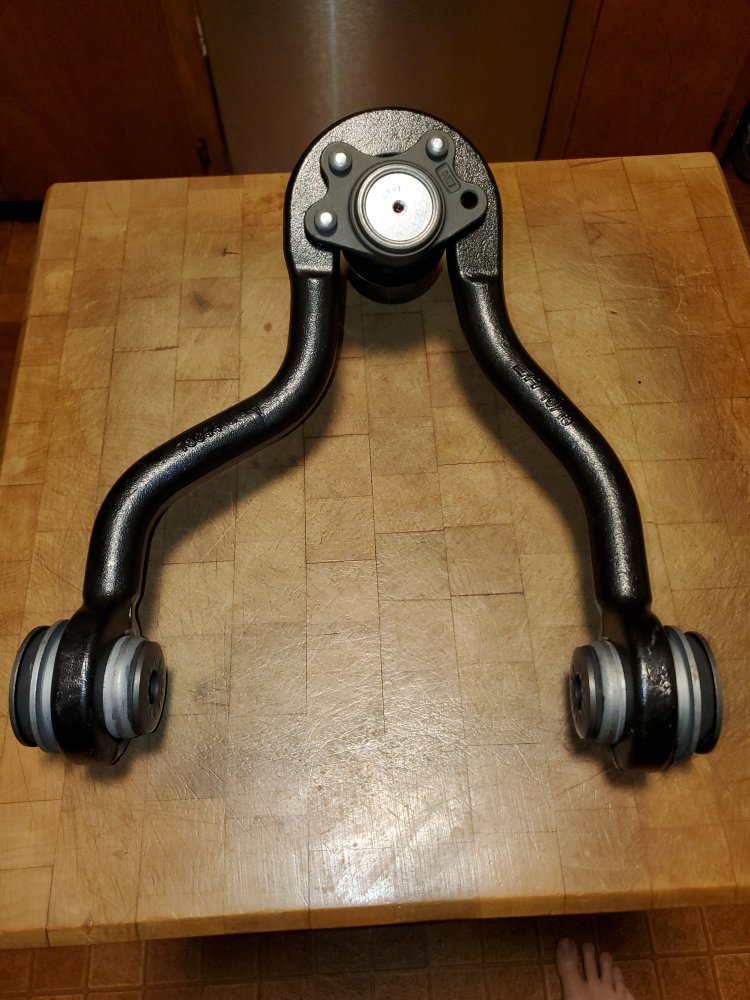

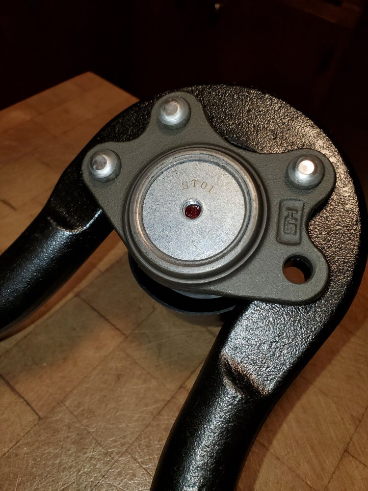

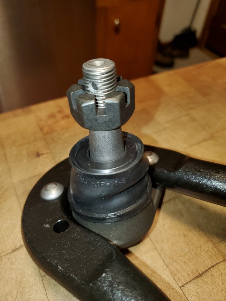

I bought some moog RK "problem solver" upper A arms w ball joints for my 98 K1500 4wd from rock auto and they don't have PS stamped on them.Now I think RK is the low grade and the CK is the the good shit.
With ball joints, aren't the "problem solver" ones usually the knurled ones that are oversized to fit stretched knuckles/yokes? I'm not sure how they apply that terminology to a case where you're buying the whole arm. Can you buy the ball joint separately, but the "problem solver" comes with the whole arm/bushings/etc? If so, the ball joint wouldn't need to be oversized.
I'm pretty sure they just put "Problem Solver" on everything they sell these days for brand recognition and its-wut-my-diddy-used credit.

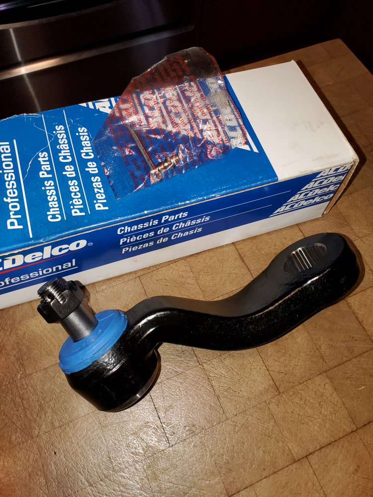

So I found out the tie rods are good, the pitman arm has some slop in the joint and the shaft seal is leaking.Gona fix it sat.Pull the box and put new seals in it and put this HD pitman on.
until then, I put a bandaide on it.
took it for a drive and the zip ties made a difference.
So I found out the tie rods are good, the pitman arm has some slop in the joint and the shaft seal is leaking.Gona fix it sat.Pull the box and put new seals in it and put this HD pitman on.View attachment 332077 until then, I put a bandaide on it.
You know your steering is sketchy when a couple zip ties make a noticeable difference!:gitrdun:
