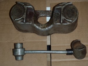

I wish some of the u-joint jobs I have had to do were as easy as smacking it with a hammer. When you get one that is good and stuck torch and press. But I have recently picked up a ball joint/u joint press kit from harbor freight for around $60 with a coupon and its a life saver and you can even change the u joint in some cases ex. an axle shaft without even removing it. All you need is the press kit and a good impact for tough joints or a wrench or ratchet for easier ones. Here is a link to the Kit http://www.harborfreight.com/3-in-1-ball-joint-u-joint-c-frame-press-service-kit-38335.html

OTC, Snap-on, Mac make very nice presses for doing this job, I have a snap-on master set ($700). Still need the hammer to release tension. It does ball joints also. Saves the hammer marks off the yokes.
