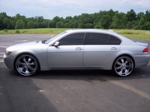

this is not something you typically see on here but i thought somebody might like it

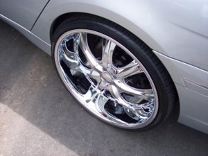

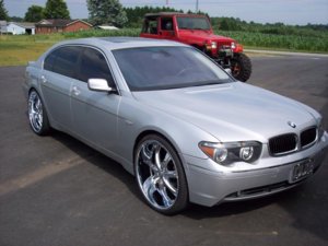

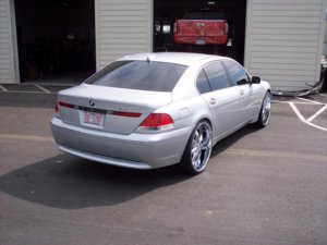

customer wanted to put 24x10's on a 745 .. the 24's are not that hard to get on but 10" wide without any spacers is. we had to loosen the struts and spend them around where they were offset to the inside. that still didnt give us enough room to get the front wheels on so out came the grinder. i had to grind the strut towers away to make clearance for the wheels which included the sway bar mounts so i had to make new sway bar mounts and cut and modily the sway bar end links.

:bling: Looks pretty sweet. Good to see the red rubi outside too.
