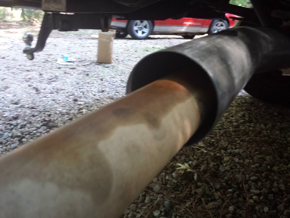

While I was in there doing the fan clutch I figured it was time to put an exhaust on it. So as to not deafen my children I went with the Diamond Eye 4" exhaust with muffler. Got that installed and it sounds really awesome and woke the truck up. While I was doing that, I went ahead and installed a Heath Turbomaster manual wastegate controller on it. The truck was working great. Pipes were a ton bigger than the old ones.

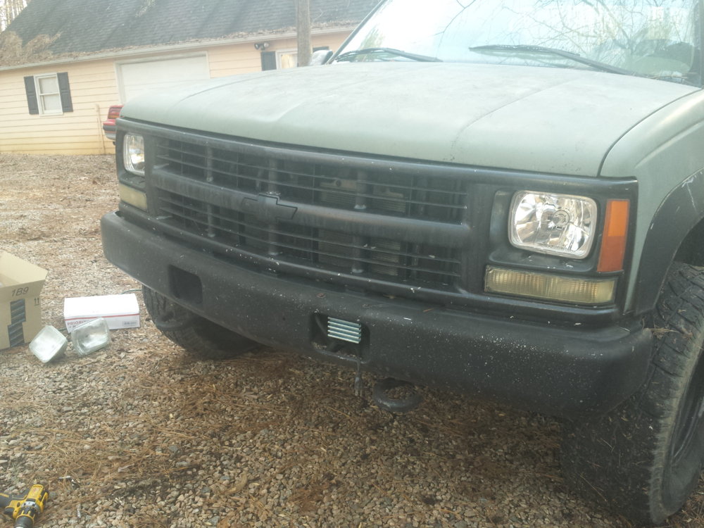

The I was helping a friend extricate his Ford truck from his ex-wife's yard before she sold it for scrap. It was late and we were up in the sticks hauling it to another friend's house. I realized then I couldn't see crap with those headlights. I ordered some new replacements off of Amazon. They have the plastic housings with the replaceable bulbs. Easy install and they throw out 10x as much light as the old ones.

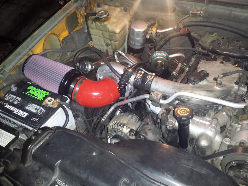

Truck was good until a couple of weeks ago. I was coming back from the scrap yard after hauling a Jeep body when I noticed the truck was down on power. The SES light came on and I knew I wasn't making any boost. I got it back to the shop and ran the codes. Yep, low boost pressure. The turbo had started rattling a bit a couple of days earlier so I figured it was on its way out. So, of course, I upgraded. I bought an HX40WII turbo and install kit and set my way to installing. Had to do a lot of cutting, filing, measuring, and praying along with replacing a few broken parts that were worn out along the way. While I was in there I went ahead and deleted the vacuum pump and installed a boost gauge. Tonight I got it fired up and it runs awesome. I'm making a little more boost than I feel comfortable with, so need to tune it a little bit, but overall I am extremely happy with it.

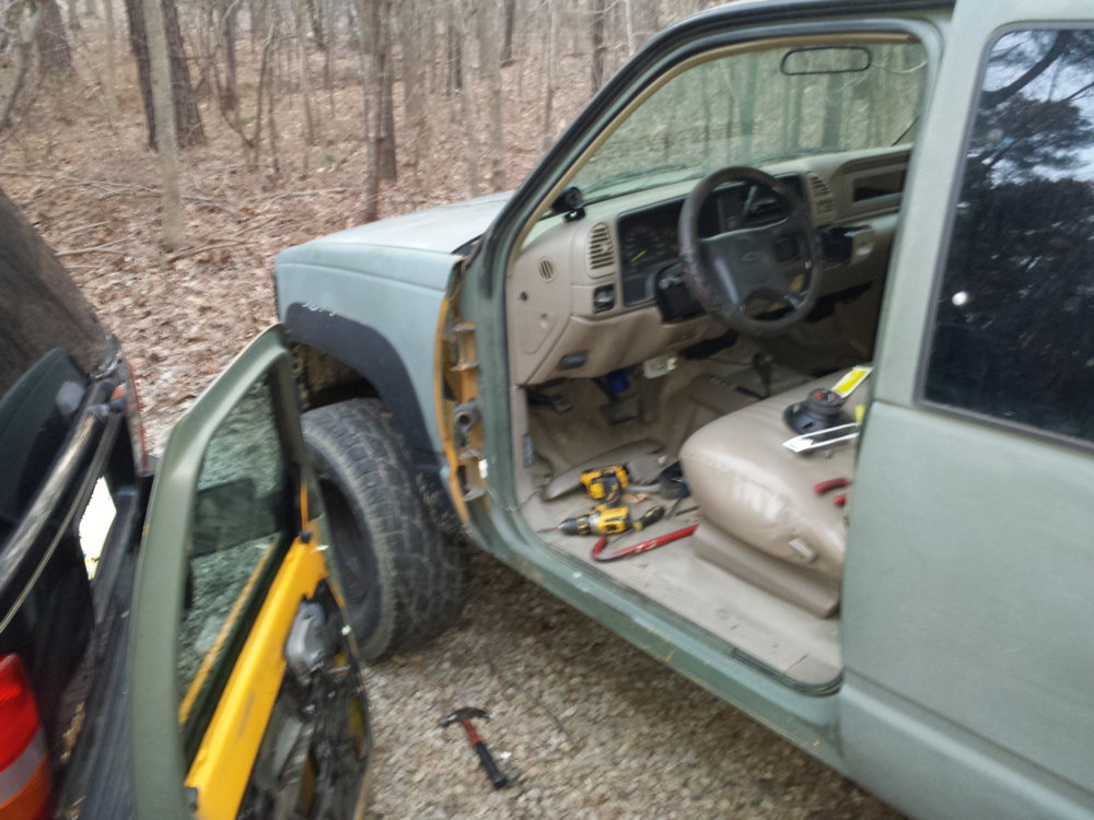

This weekend I am going to install new door pins and bushings along with the spring and roller, then I am installing two LED light bars under the rear so I can see when I am backing the trailer up. I'll post pics as I go!
