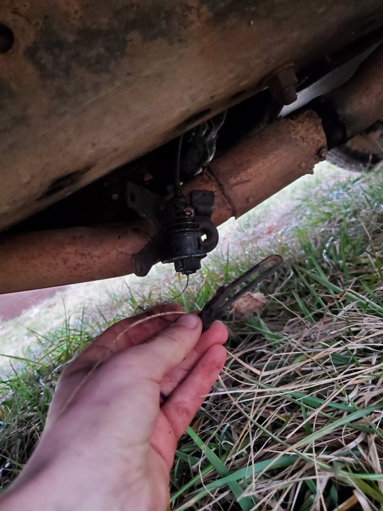

Well, after 3 trips to O'Reillys and wallering around on the side of the road.... got the new u joint in.

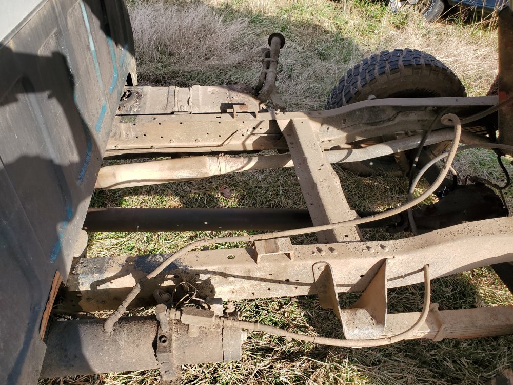

Tried the hammer helper, with a 4 lb. No dice.battery connections or starter solenoid. It’s a GM, give it the ole hammer helper test on the starter.
I wish, but not likely. Not tagged yet and still working out the kinks. I'll have munchkin, so sitting on the side of 109 would not be good. Will either be in the edge if the wife comes, or my dakota.Driving this truck to the URE event?

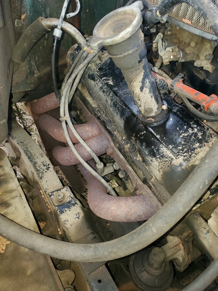

You got it, solenoid. I think I'm gonna switch to a Ford style solenoid and do away with the one on the starter. With long headers. It's a pain to get to the side of the motor.battery connections or starter solenoid. It’s a GM, give it the ole hammer helper test on the starter.
And the added heat of the long tubes doesn’t help anything either unless the starter is shielded or wrapped.You got it, solenoid. I think I'm gonna switch to a Ford style solenoid and do away with the one on the starter. With long headers. It's a pain to get to the side of the motor.
That's my thoughts. Just gotta figure out the stock wiring, then it'll be straight forward.And the added heat of the long tubes doesn’t help anything either unless the starter is shielded or wrapped.
Just google Chevy starter to Ford solenoid. There’s eleventy articles that spell it out with wiring diagrams.Anybody wanna show me where to put the hot to spin the starter? I had used a jumper to the brass tube, but now that that seems to short to ground? Confused as hell now.

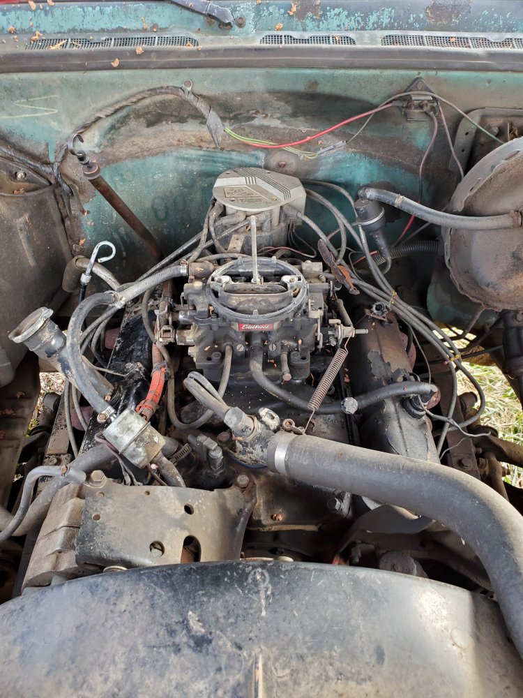

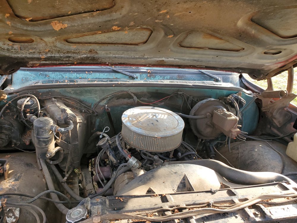

That Edelbrock sitting on top probably has some to do with it (if it's not a clogged up filter). Runs fine cold, then starts acting up when it's warm? Is that about right? You can tune that out, but would be best to start with a refresh of that carb. Looks like it's been on there a while.I swear, if it ain't one thing it's another. Got it started and on the test drive it starts acting like it's not getting enough fuel and stalls out.
That's how I've usually refreshed my Edelbrocks, was with a Holley. It's probably in the metering rods, but those can take some learning to get ahead of the curve...Not quite so simple as a Holley. I had one that did exactly the same thing. After a rebuild, it ran pretty darn well. But you've got to strip it down completely and get all the crap out of it. Other Eddys I've had ran decent, but lean as hell up top. That seems to be pretty common with them. I'd prefer them to run a little fat (which I'm sure you know is common for Holley).
Replacing the fuel line and filter is a fine place to start. If you feel like going a step further, put a carb refresh kit in that Edelbrock...it might come around. Otherwise, go ahead and getcha a Holley.
