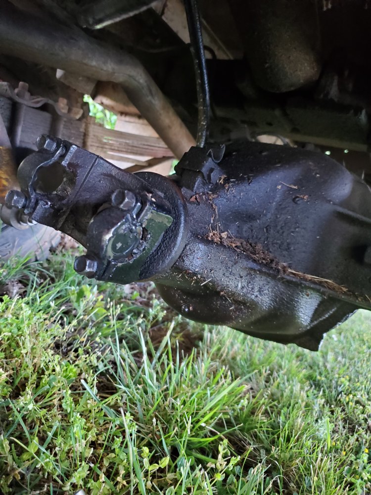

Well, after 3 trips to O'Reillys and wallering around on the side of the road.... got the new u joint in.

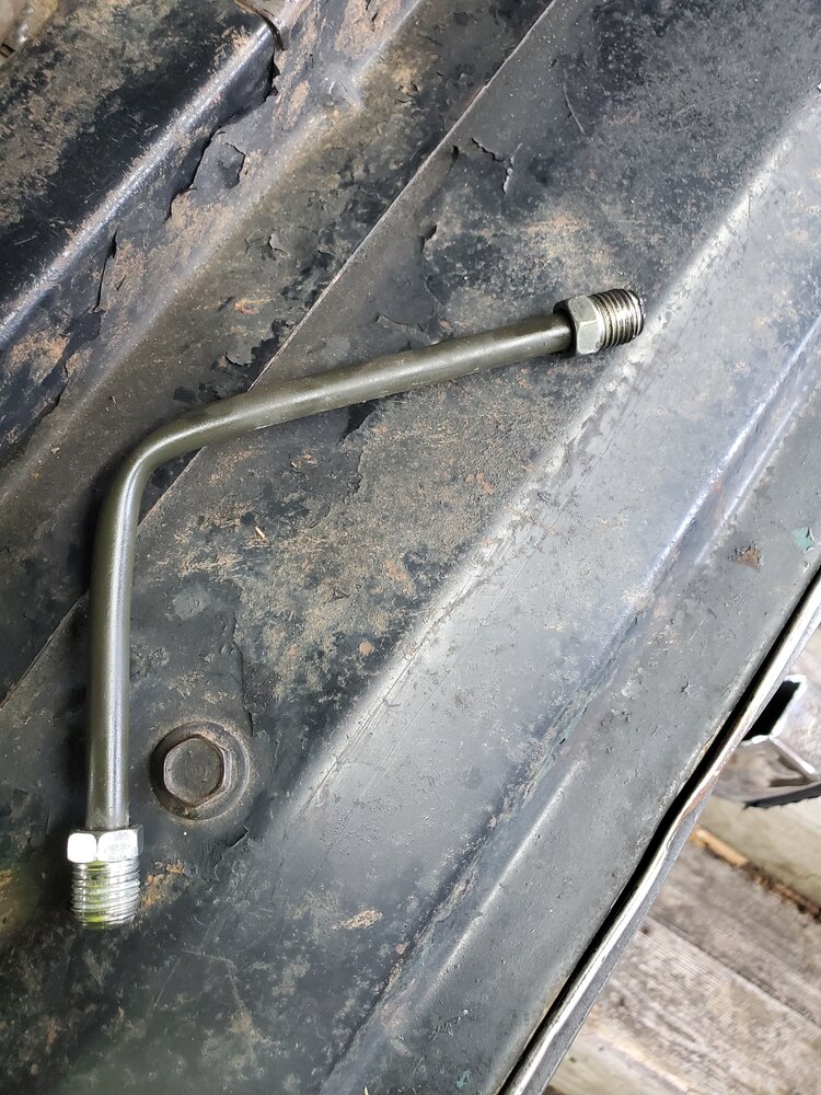

Got the truck in the shop to replace a piece of trans line.
Hoping this fixes thw fluid puking. But.... idk as now it won't crank. Acts like a dead or weak battery, but have confirmed that's not the case. Turn key and get a single click.
