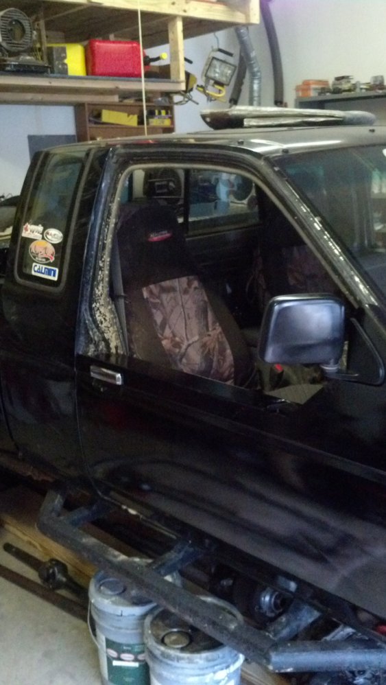

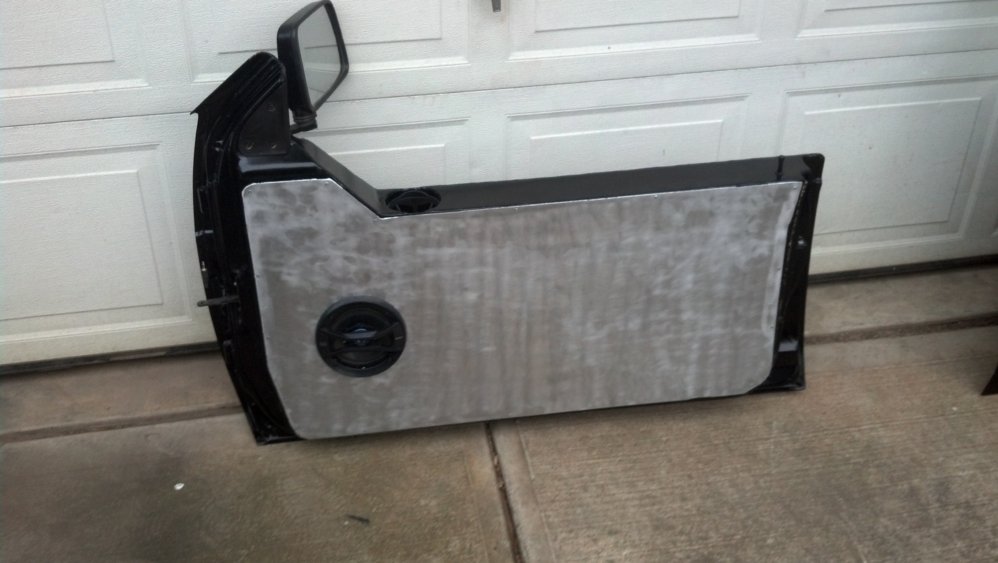

Picked up some doors from a '97 hardbody from 'Royota' on here, stripped them down to have spare parts/glass if I ever need it and started cutting:
Cut the inner panel out (left the speaker mount):

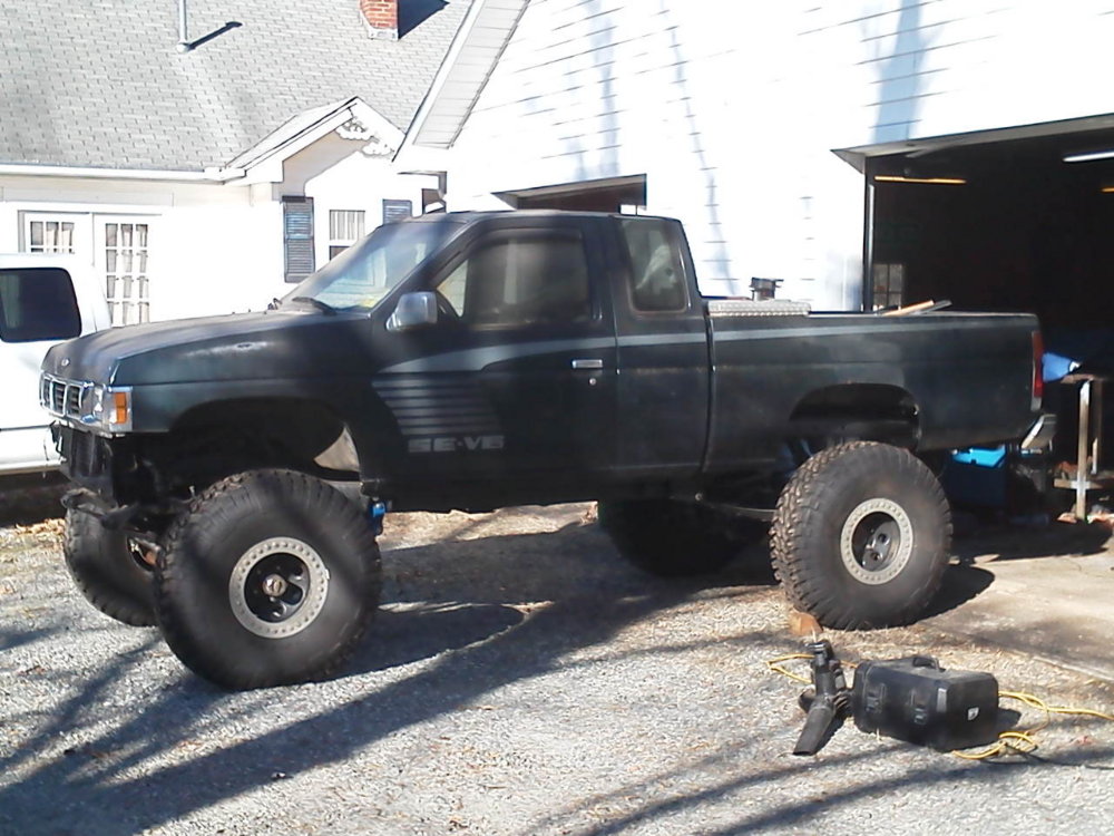

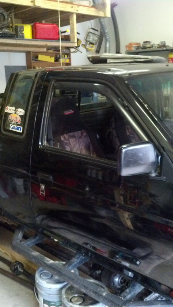

Test fit on my crawler:
At this point, I've got about 4 hours in them...all they need to be finished is some sheetmetal work, body work & paint.

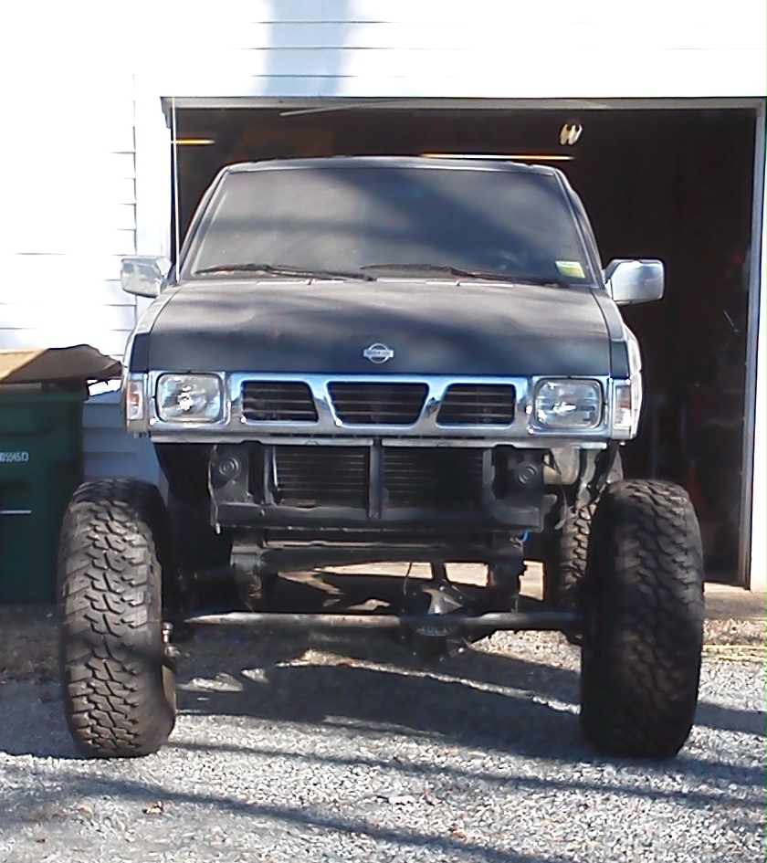

Started ordering more parts...shooting for wheeling on 1-tons by opening weekend at URE.

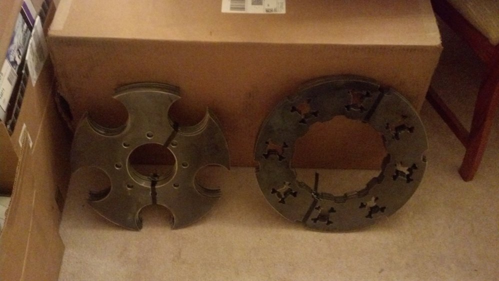

H1 wheel centers & rim stiffeners/rock rings from MudPro

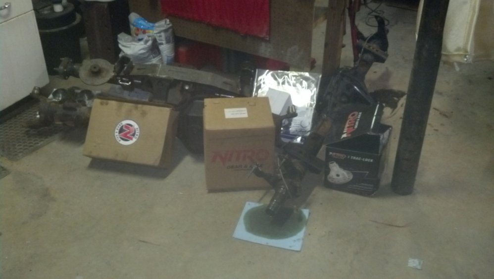

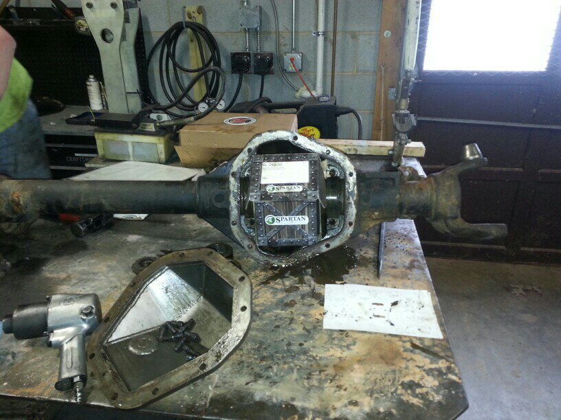

Made some progress this weekend, took the axles to a friend's place and we tore them down. Found out when tearing down the 14ff that it had already been smoothed down a bit, so that's one more thing to be crossed off the list unless I decide to shave it. I'll be heading back in a couple of weeks to rebuild, gear & lock them. Pulled my wheel spacers, wheels & tires (they're being picked up tomorrow) & swapped for some rollers. Transmission was picked up ~2 weeks ago, just haven't had the time to put the drive train back together yet.
Spartan recommends swapping from their cardboard carrier to a metal one for manual transmissions....something about torque converters & gravity. The question is "what makes the gravity?"

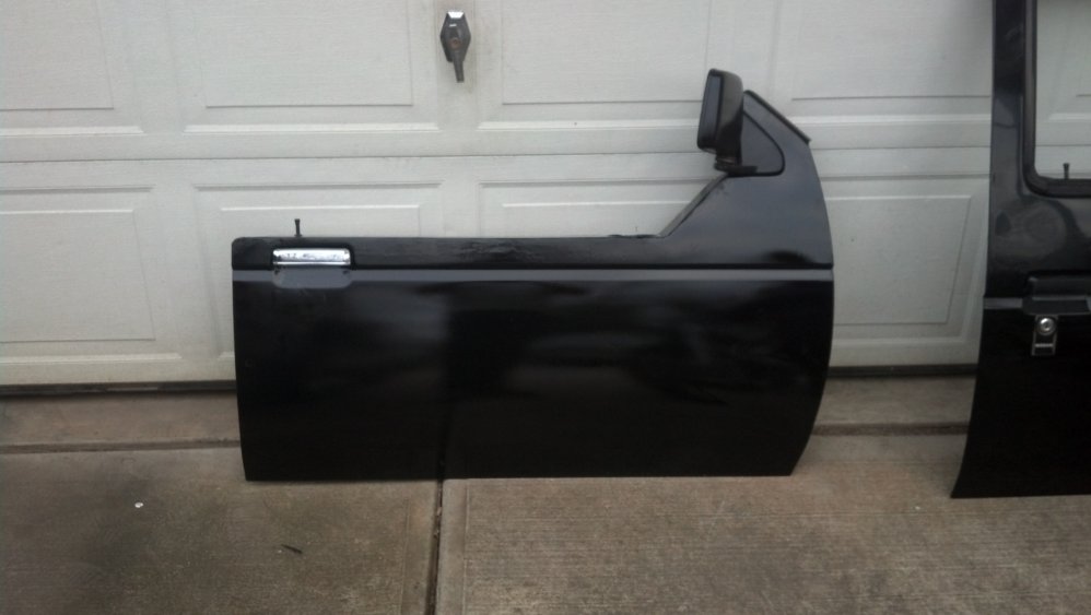

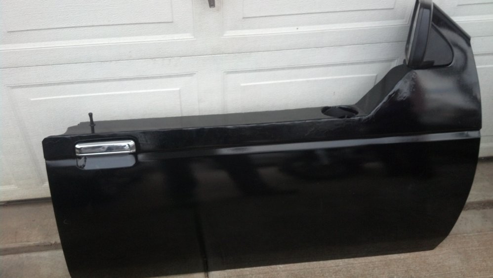

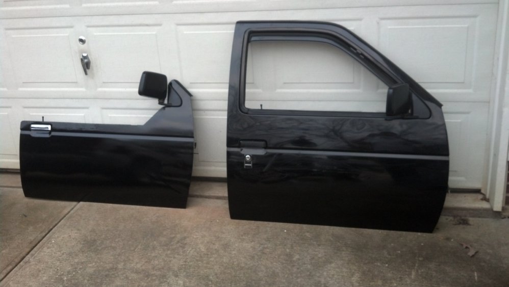

Finally got some pics of my finished half doors. They each weigh ~40lbs compared to the ~65lbs of the full doors. I really like the integrated cup holder...its nice to have those again! Spray bombed the outside primer, gloss black & clear, scuffed up the inner aluminum panel and clear coated. I could have spent more time on the body work & paint, but figured that would be ruined after the first trip.

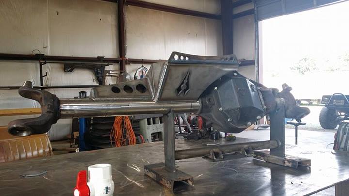

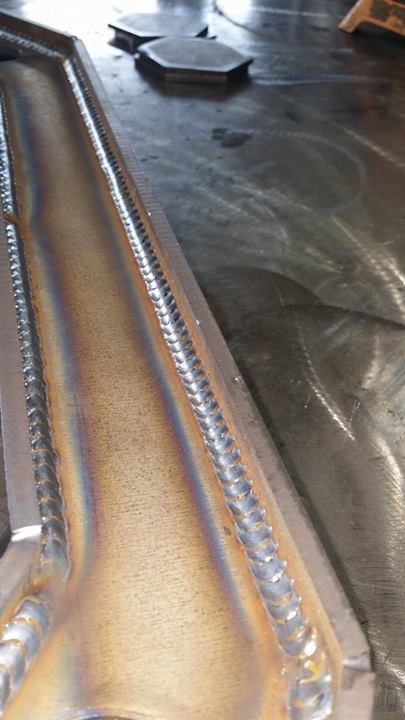

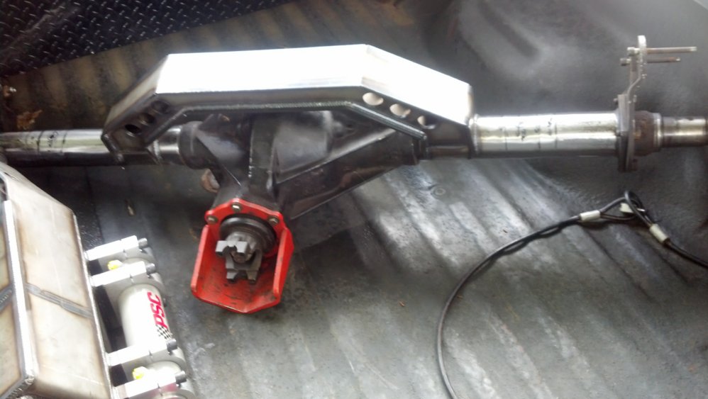

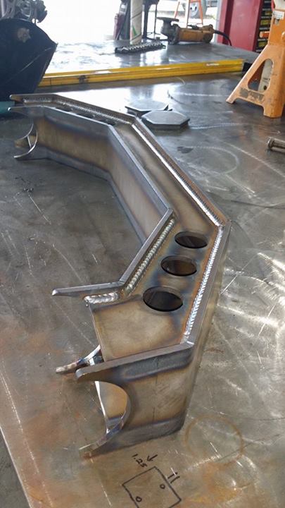

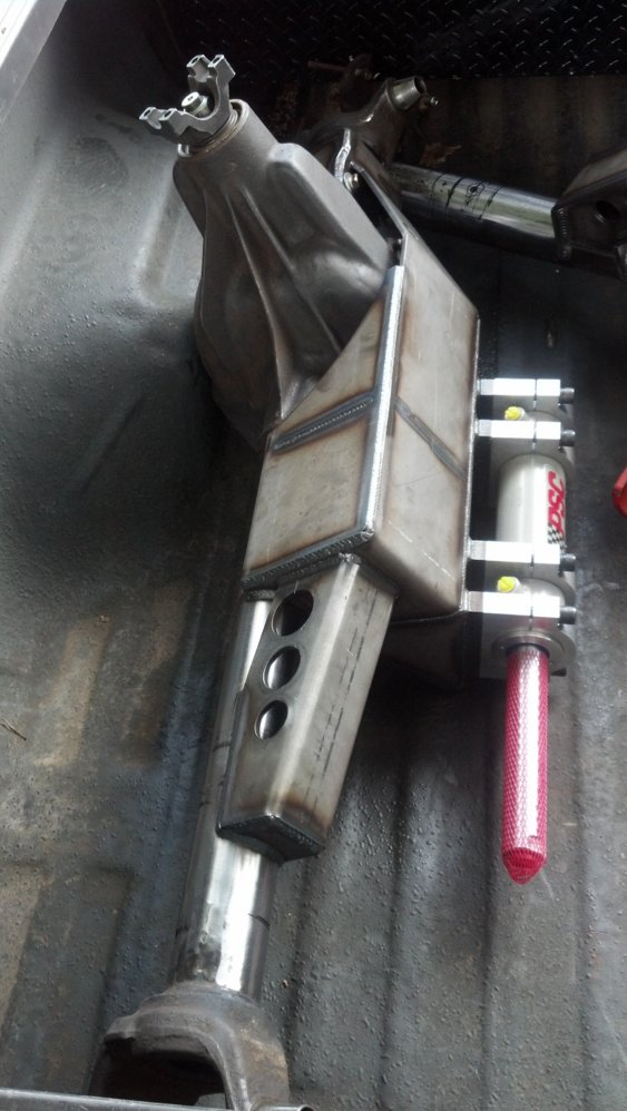

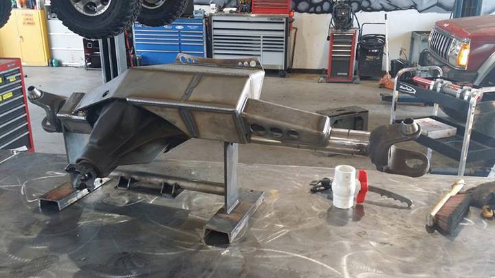

Picked up my axles after Chris put his trusses on them. They look amazing!
1958564_757044574346831_82981164996862789_n.jpg 10296994_757044591013496_1175725968254079456_n.jpg IMG_20140611_142802_002.jpg
10325722_757455677639054_3493214990550633474_n.jpg 10431506_757455654305723_3170038312974941726_n.jpg IMG_20140611_142808_648.jpg

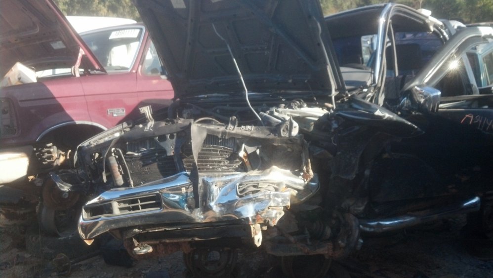

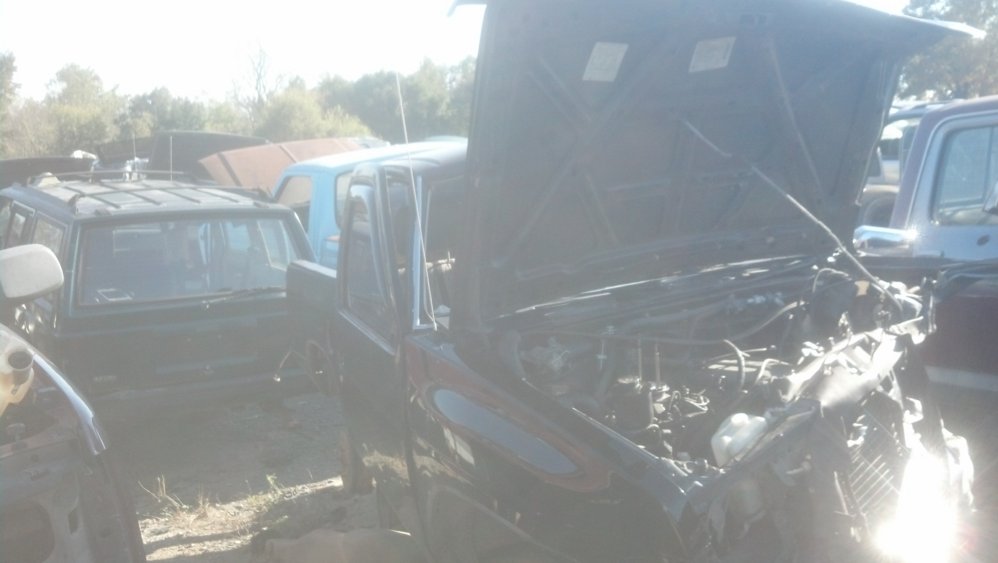

Ruined my transmission during our 2013 Windrock trip by it running out of oil (never saw it leak). It was so badly worn that the rebuilder told me it'd be cheaper/easier to rebuild a JY unit. Only took 3 trips at a JY in Shelby to pull one out of a totaled hardbody...apparently its not a common transmission.
IMG_20131025_161327_805.jpg IMG_20131025_161341_503.jpg IMG_20131025_161435_827.jpg
The only good thing was that transmission had already been rebuilt by Whatever It Takes transmissions, so my transmission guy just had to go through and freshen it up. I had already sold my 36" Iroks & wheels and ended up having to buy some 16.5" aluminum wheels to run this year with my military takeoff 36" tires. I made two runs to Uwharrie & Gulches; after the gulches I had sheered two of my ARP steering studs that had to be dropped off at a machine/weld shop to get them out. Went to put everything together the night before our 2014 Windrock trip and ended up stripping the threads out of another steering stud hole. Was still going to make the run, but my trailer brakes decided they didn't want to cooperate and I wasn't going tow through the mountains without them so I ended up riding shotgun with another club member. Working on the trailer last night and decided to crank up my crawler, turned the key and nothing but a 'click'. All batteries are charged & test good, but literally nothing comes on including the dash lights, radio & CB. Fingers crossed its something easy like the ignition switch...

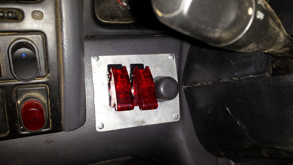

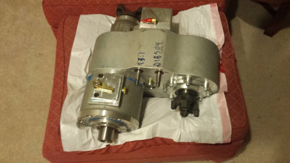

Not a lot of progress has been made since I was looking for a DD, starting a new job, hunting, etc, but I did manage to get the trailer back up and running. Turns out the battery compartment needs to be bigger since it doesn't seal properly, so I added some drain holes, charged the battery up and its worked ever since. While I was at it, I added some LED brake lights to the ramps and a new license tag light to prevent any more pull-overs for warnings that I had a light out. On the truck, I've added a push button ignition and now it won't run for more than 5-10 minutes before it shuts off. I think its a bad ECM, but I'm still testing everything before I start throwing parts at it. Oh, and the brown santa dropped off a new shiny part...
