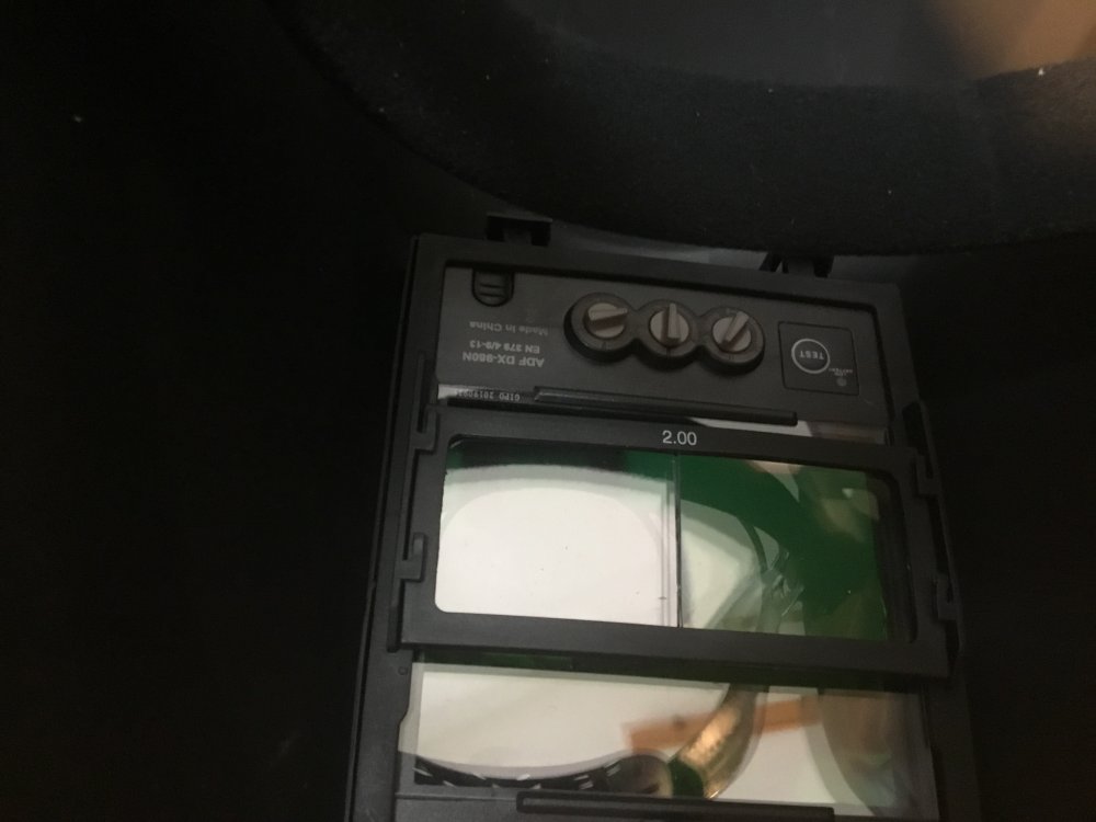

Has anyone used the magnifier inserts for welding helmets ?
Are they worth a damn ?
I've got safety glasses with magnifiers in them (everyday wear pretty much all the time everywhere) but those don't help with a larger field of vision and wearing them in a welding helmet I'm looking down and tilting head back. even with a large glass on helmet I'm looking thru the bottom third of the view. very tiring.

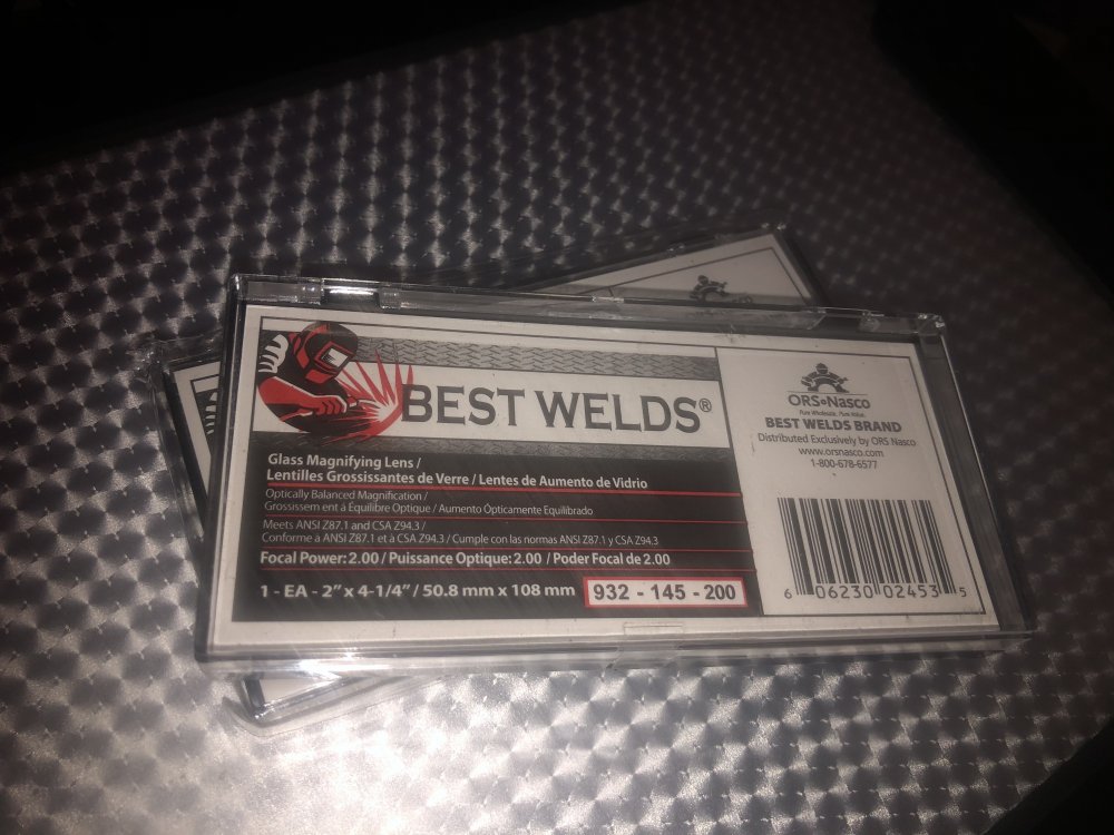

I found the “cheater” lenses and they’ll be here tomorrow. 2.0 and 2.5x
My hood has a hanger for such in it, the question was if they were worth the trouble. For the cost it’s worth trying, maybe I can make them useful for other things as well.

These came as a pair from Amazon
( 2 lenses per purchase)
I ordered 2.0 and 2.5
all came in an individual case wrapped in plastic.
$14 a pair
