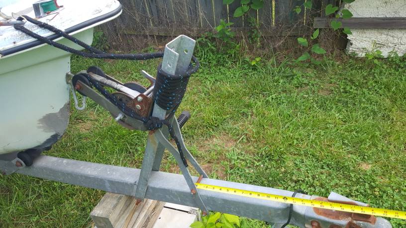

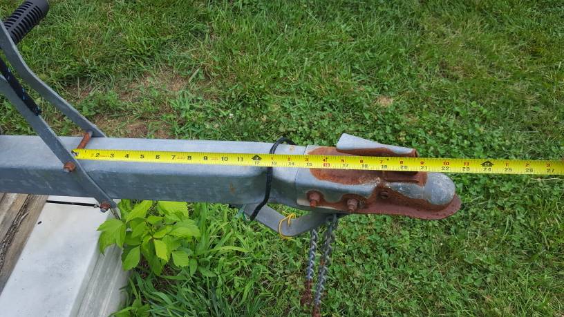

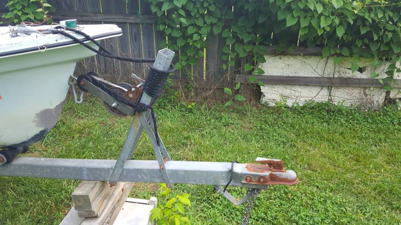

First thing i want to get done is getting the trailer fixed up so i can move it around with out any worries. Wiring the trailer shouldn't be problem along with servicing the axle. My Concern is the tongue of the trailer where it has been damaged at some point.
My plan is to replace the ball coupler and add a wheel jack on the front along with possibly a spare tire holder.

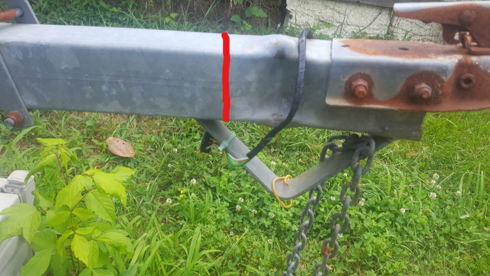

Attached is a picture of the dent my plan is too cut the tongue where the dent is and install the ball coupler right there. The red line represents where im planning on cutting. I'm going to remove the triangle piece of metal install wheeled jack and drill a hole on the bottom to fish a grade 8 bolt through to connect the chain to the trailer since im loosing the where it is currently connected. My biggest concern is doing that is going to make the tongue too short what do yall think?
You could always cut and add a foldaway tongue to kill two birds with one stone if it will go into a garage or carport at some point. You can add length after the foldaway hinge, etc., to be whatever you want. Yours is super easy because you don't have a surge brake actuator in the tongue to worry about.
Unless you've weighed that rig (full of fuel) and looked at the tongue weight, I wouldn't worry yet about making the tongue shorter because it may be a non-issue. Unless you know the boat and trailer are matched, I'd assume they aren't and figure out what is proper based on that assumption.

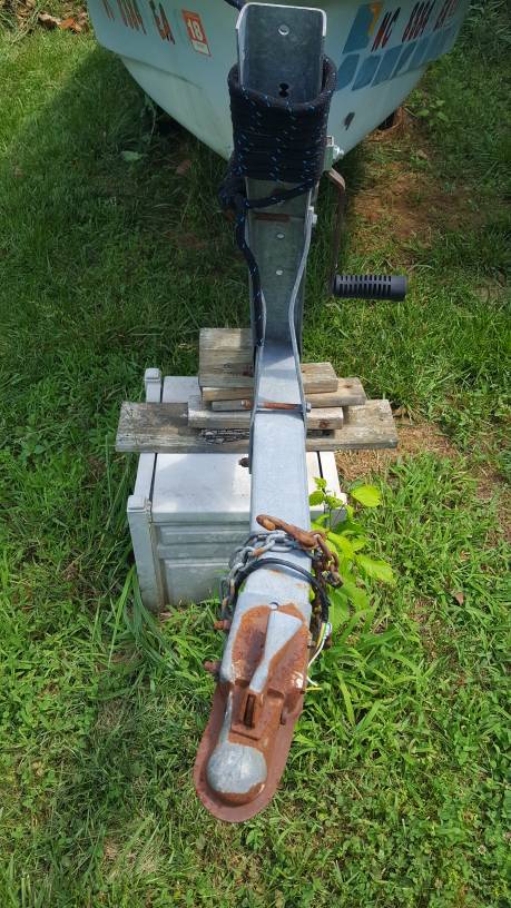

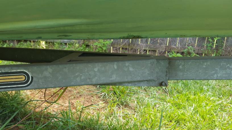

The coupler is rusted and is very loose so i was going to jave replace it i know the tonger is just held with a pin system under the main part of the trailer.
Sent from my SAMSUNG-SM-G890A using Tapatalk
The tongue isn't that rusty, and it's adjustable. No reason you can't reuse it and save a few bucks. Just wire brush it and spray it with some canned zinc.

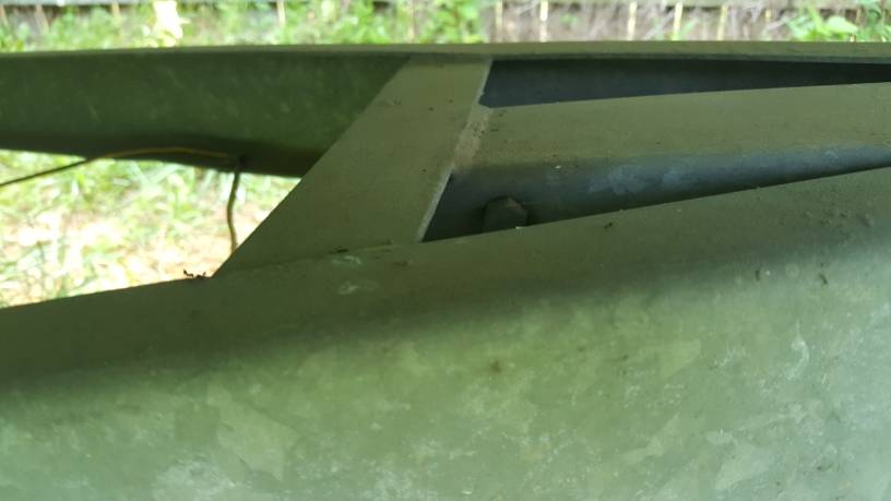

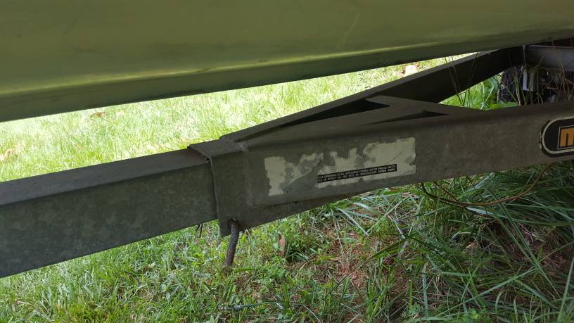

These pictures show where the tongue connects to the rest of the trailer the main thing that holds it in place is just a bolt the keeps it from piveting when there isnt a boat on the trailer.
Also the pictures give the dent in the tongue more justice to why im thinking about cutting it off. Which will cause the tongue to become about 8inches shorter.

I’d cut it just behind the bend and reattach the coupler if it isn’t going to put the bow of the boat to close to the rear of tow vehicle where it could hit.
It will be shortening the tongue by 8 1/4 inches. I dont thing it will be putting the bow to close to the back of my jeep. The internals of the coupler are rusted. This boat and trailer spent all but the last 6 years on a farme in florida.
Thank you all for all of the advice and in put on this first stage of the restoration. Im going to cut and instal a new coupler.

Anything special i need to do when i cut the galvanized tongue besides recoating wear i cut?
Got the boat pull up about four feet one tire is complete screwed and the other is in surprising shape. The one that is screwed is flat to the point the flat spot stayed in the tire. Went ahead and coated every single bolt i plan to undo with pd blaster.
If the new tounge has bolt holes, it doesn't hurt to bolt and weld. Extra work but it's fail-proof. Most light duty 1.875-2" receivers aren't the highest quality of steel at least until you get into pintle styles.
