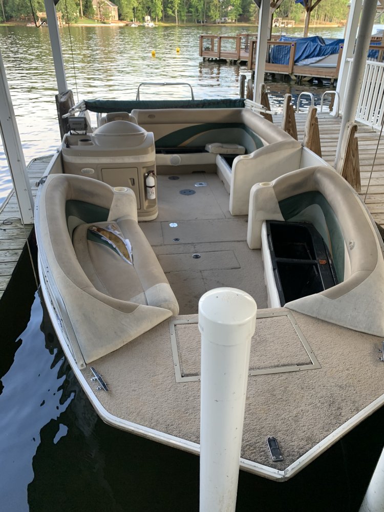

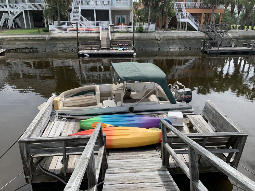

So I bought a boat. Debating whether I should keep it or send it down the road. Overall the boat is solid, but the interior is rough.
I have the cushions, but some of the wood frames behind the seats are starting to rot. Also the console wood needs to be replaced. I’d like to at least get a couple prices or ideas of what I’ll spend. I’m fine with going back with one color for everything if that saves $.

that boat probably has a plywood deck. if the seats are starting to rot, you should check the floor really carefully.
Everywhere I can get to, the deck is solid. It’s a mix of aluminum and marine plywood.
It’s got a little soft wood on some seat backs and around the console. Usable as is, but I want to replace it if the $ is right.
Done the plywood seat backs and bottoms on a couple of boats. Was fairly easy and fast to pull staples, cut wood to match, and re-staple (marine plywood with monel staples). Dont have to mess with the foam and stuff. (one was all the seats in a bass boat, the others were the folding seat/lounge type in a runabout).
Looks like you got some damaged vinyl....is that sun-rot, or did something cut it? If the other vinyl panels are in decent shape, an upholsterer can replace just that one panel.

The vinyl needs replacing too.
