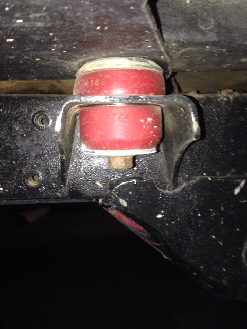

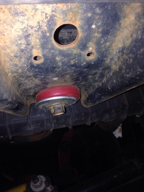

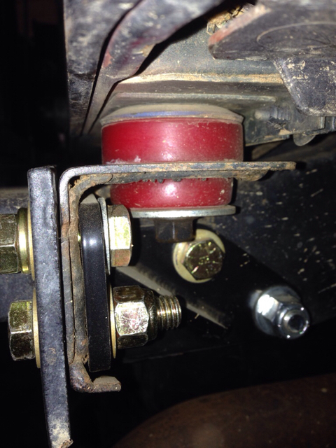

As some of you know I am a ZJ guy... Which has a unibody... So a body on a frame is a little new to me. It looks like the body bushings on my TJ are newer, but I don't know if they are stock height or lifted. So what says you?

Look like stock height urethane bushings to me.
Poly bushings the way to go?
I've found they don't "give" as much as stock rubber being the only downfall for body mounts if you didn't want a tighter feel. Every vehicle would be different to which is better. But there is no "best" IMHO. They do tend to last longer than rubber for body mounts. Urethane can have shorter lifespans in other more strenuous applications but not body mounts...
Run em!
