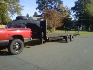

I got my rockers done in line-x with the UV protection to keep from fading and it comes cleans very easy. If real muddy I rub it with a soapy brush lightly and it cleans right off. It was only 125 per side to have done at line x on Winston on university

Linex would be way thougher but a friend of mine just done his bumper and lower rockers with plastic dip spray paint. It actually turned out really good and smooth. He's only had it about a month so I have no idea how it holds up but looks way better then I would have ever of guessed. Also he decided to change his bumper up so he took a razor blade and cutout the shape then just peeled off the unwanted plastic dip just like a piece of rubber and the original finish was not harmed at all. So it's cheap enough to try and if u don't like it u can just peel it off.
I will try to snap a better pic but here is the only one I have that shows it somewhat close up

Looks good yota!
