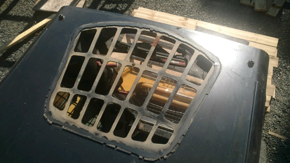

Anyone ever tried this? My skid steer window blew off going down the highway Friday and I need to put another one on. The window is available from CAT but no adhesive. It was glued on with some kind of adhesive that the parts guy says isn't available. I've searched the web but ain't found a definite answer.

Why not just drill 4 holes in it and put some cross tabs across the steel mesh? My Bobcat has 4 holes and threaded knobs on the bottom side for easy removal.

How big is that window? I'm having a hard time judging size from the picture.

I have thought about bolting it down but in not drilling holes in the machine. I could go thru the little square openings that are there now and maybe make a tybar piece. The sealant that is there is probably .200" tall and has little stand offs to hold the lexan off the metal. I assume to help with noise/vibration. The window is approximately 20*20". I wasn't able to find the old one but was able to make a pattern from one at work. Just going to cut one out. CAT wants $110 for it.
The spacers are most likely to set the proper bondline gap for the adhesive being used, so there is enough adhesive to move in shear with thermal expansion and minor impact. With a bondline that thick, that narrows down the choices for adhesives a lot (that's a pretty huge bondline thickness). That's also a bunch of adhesive, because that's minimum 80 linear inches at 0.2 inches thick and probably 3/8 to 1/2 inch wide, so easily 6-8 cubic inches (100-130cc) of adhesive. So something like the bigger 300mL cartridge of the Fusor urethanes would probably be a good choice (probably $50 for the cartridge).
