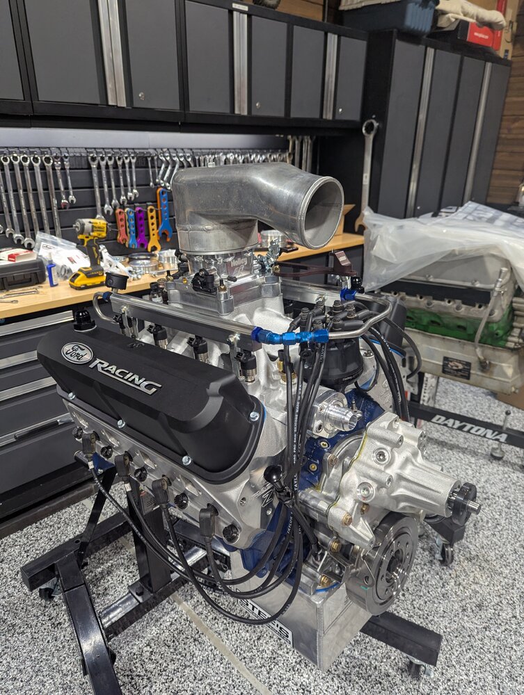

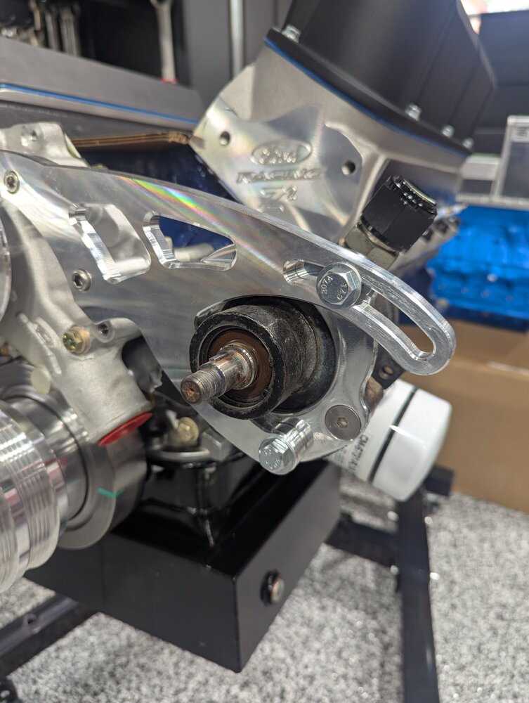

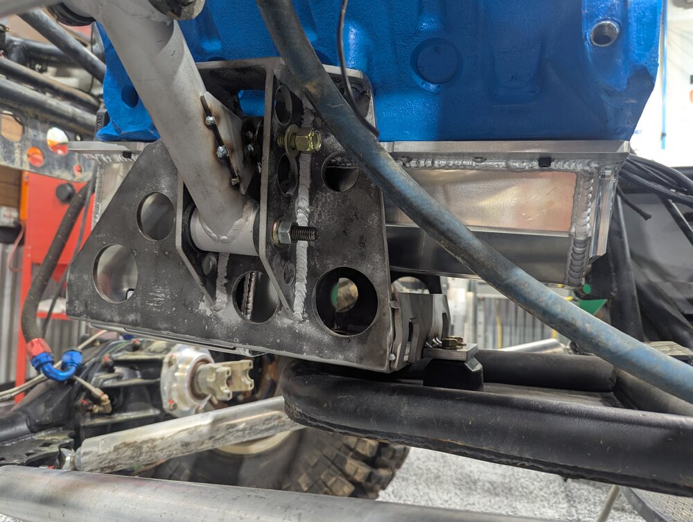

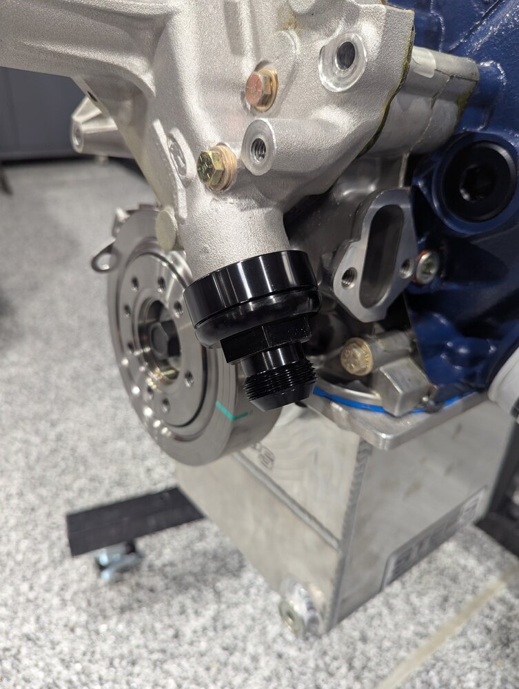

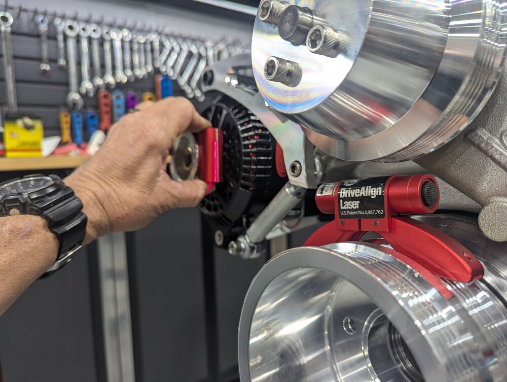

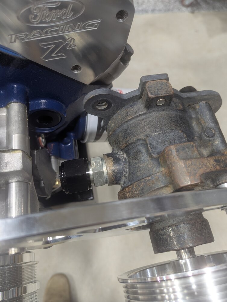

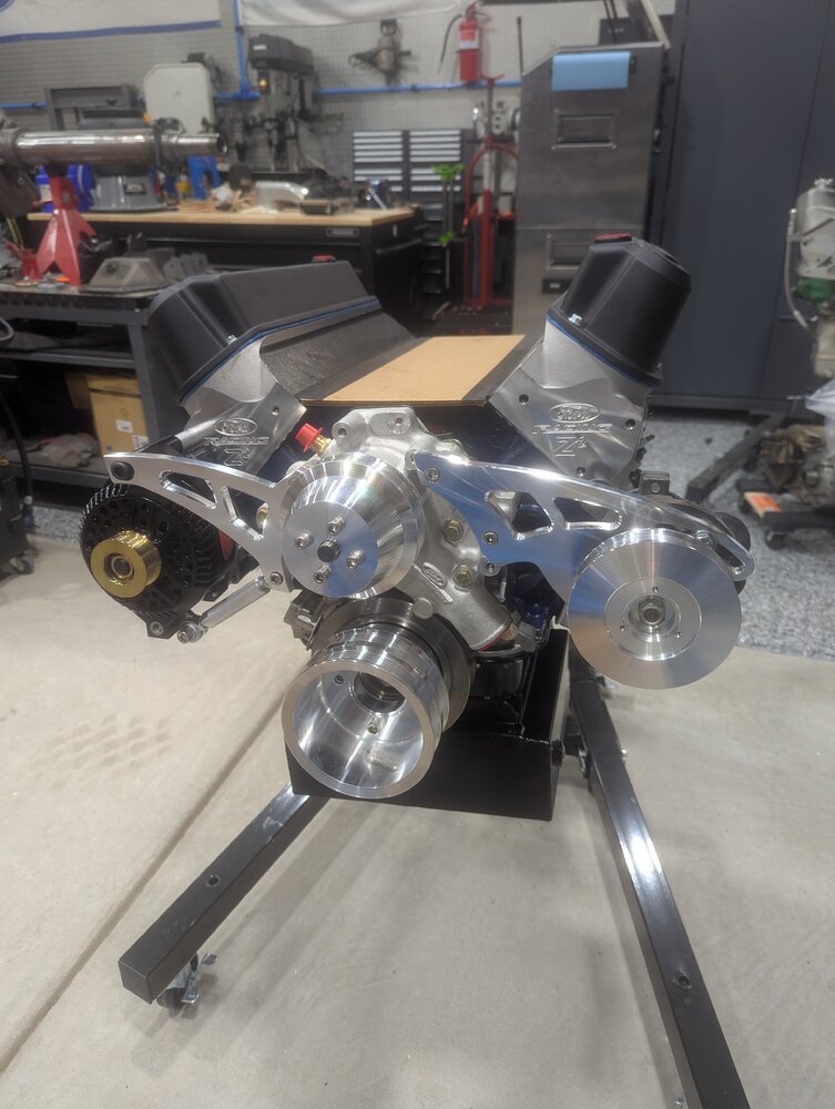

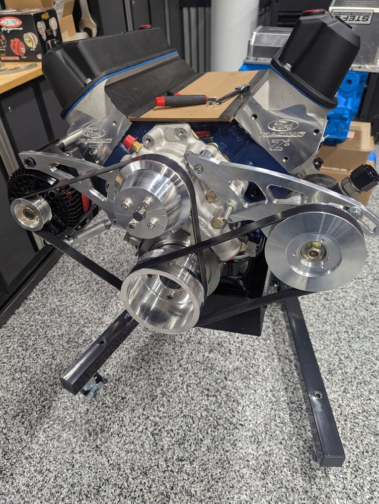

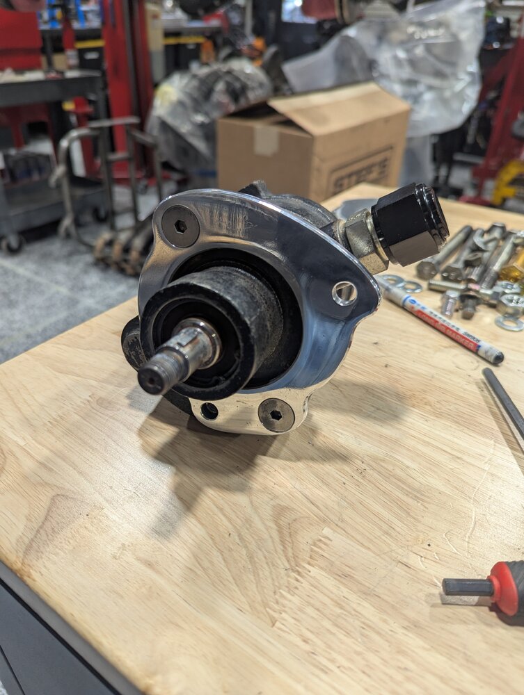

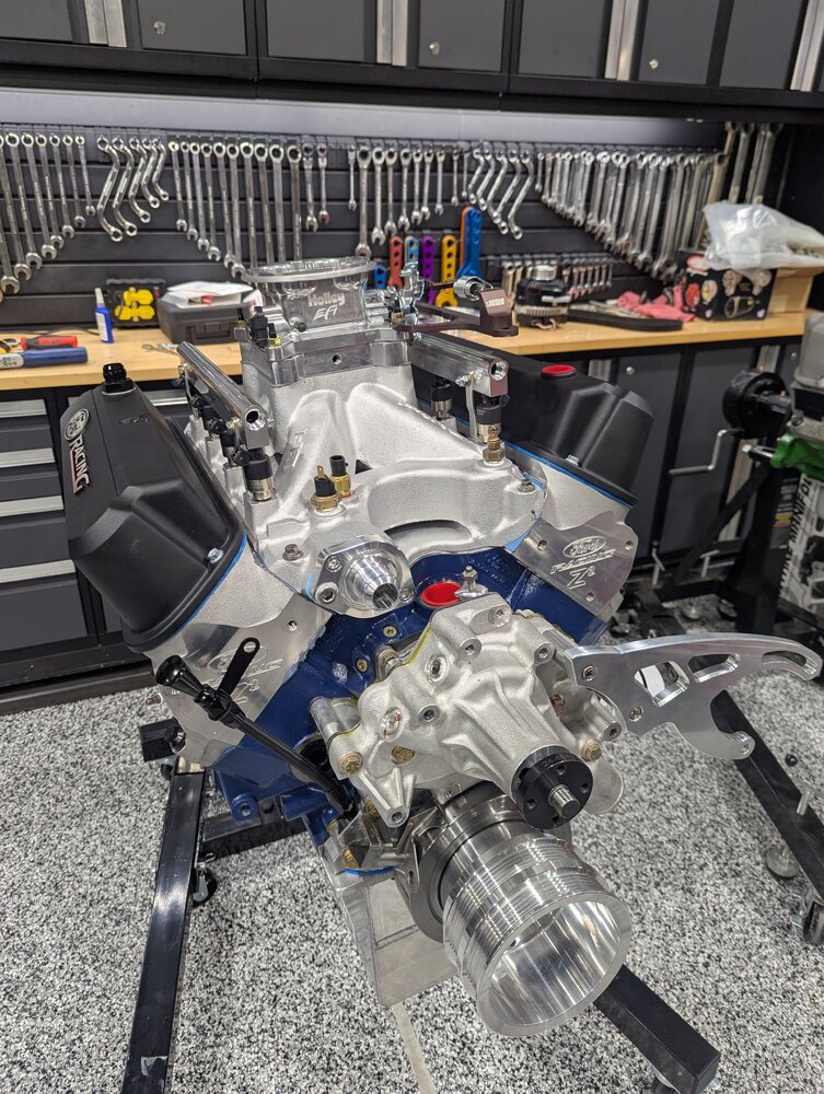

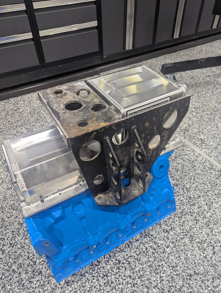

Got a little bit accomplished, brackets and pulleys test fitted. Looks like I'll need to do some modifications on the PS bracket as I suspected. The pump is a Howe TT pump that is based on a modified Saganaw P-Series pump. Need to rotate it clockwise to point the inlet vertical which should just be a matter of relocating the bottom hole inward. Will need to figure out pump/pulley spacing later. Not a fan of the polished look so might cerakote them black

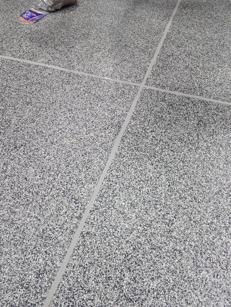

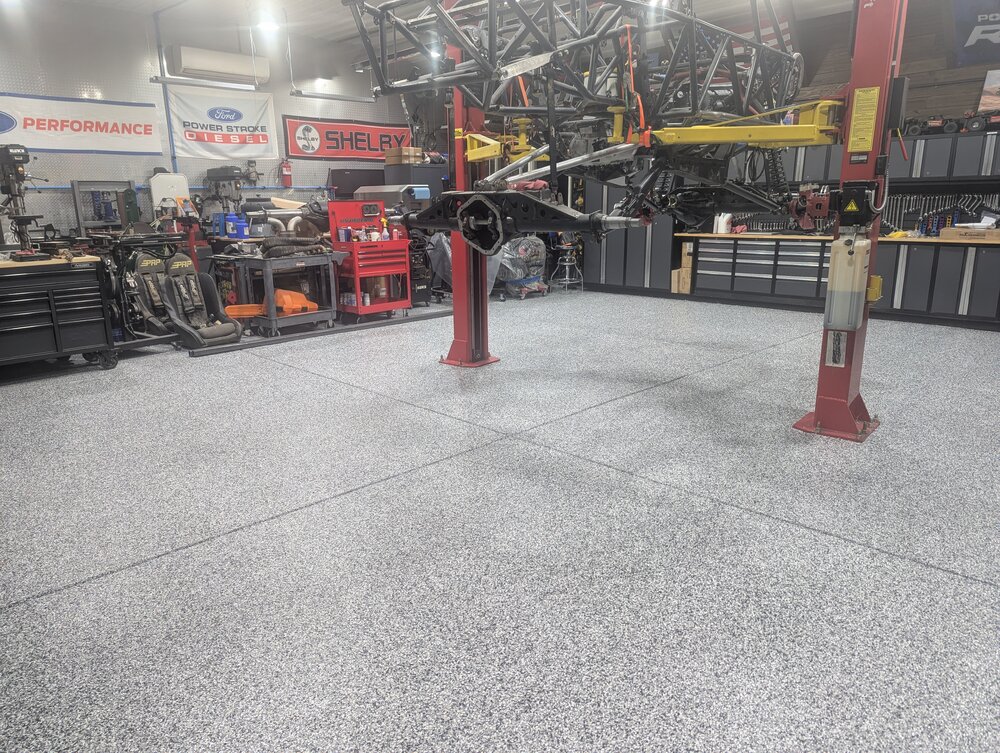

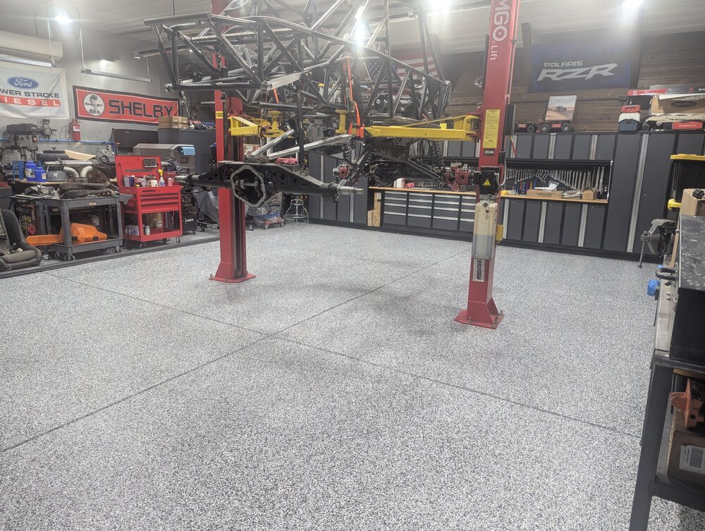

Floor gets finished in the morning and then everything gets put on hold for a couple of days until it cures. This old man is tired and time to chill for the evening.....
