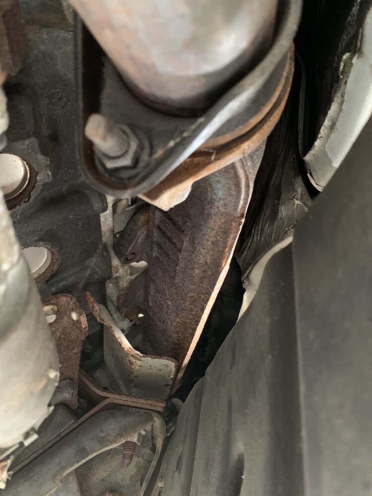

So I finally took possession of my box truck to use for work, it needs the exhaust manifold bolts replaced, I guess it’s common for them to break off? Drive side is already off, just needs reinstalled. Passenger side needs removal and removal of broken bolts, I seen at least two with a quick inspection. My buddy that I bought the truck from made me well aware that the passenger side was gonna be a PITA and there was a reason he hasn’t done it yet, so naturally I said challenge accepted…..but before I beat my head against the wall too much, any tips or tricks to removing these broken head bolts? It’s a ford V10

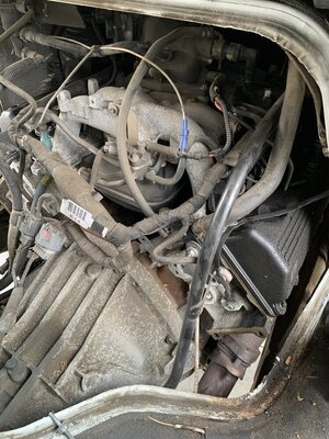

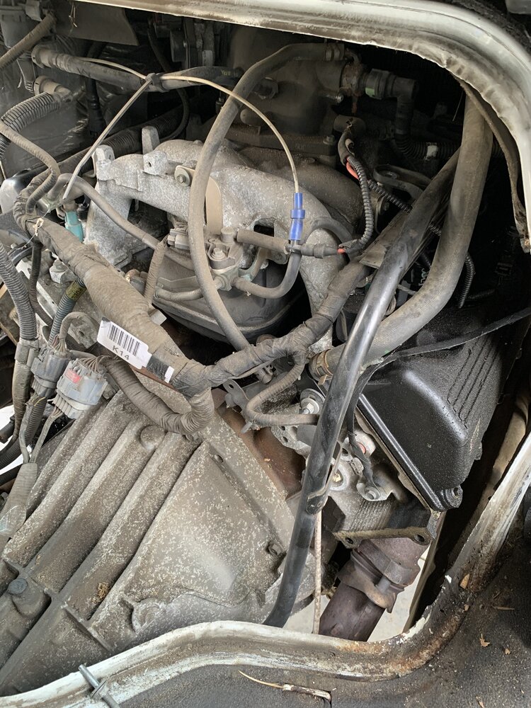

Thanks! My next concern is going to be gaining access to them. Without pulling the engine. I haven’t looked into it thoroughly yet. Was going to do that this weekend and really gameplan as to how I’ll tackle the job. But initially, it’s stupid tight right there, looks like maybe the fender well lining can be taken out, or I’m even open to taking the fender off altogether in order to gain easy access. So I’ll see about that this weekend and keep those methods in mind
I’ve done many of these. Get to the ones you can, taking the fender off will do no good. These do come out much easier than the Ls ones for some reason. But will be a couple in the 6.8 you can’t really get to easily. I have had to leave a couple in that I couldn’t get to but with a new gasket it sealed up 99%

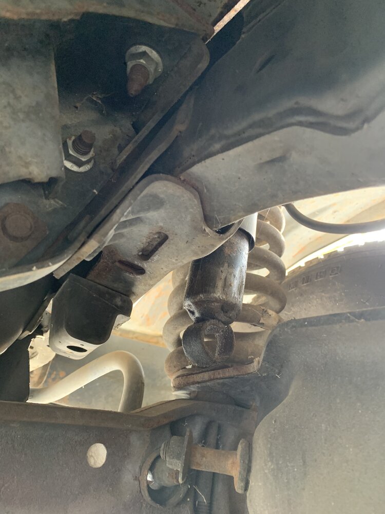

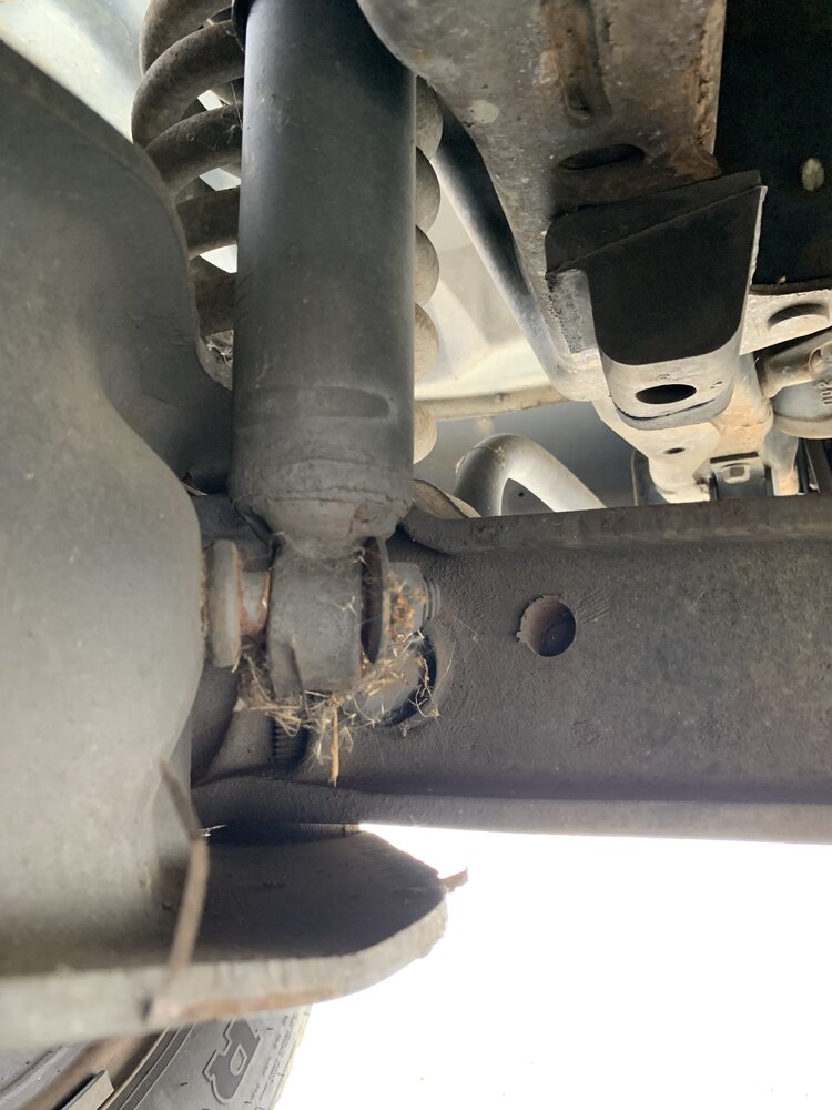

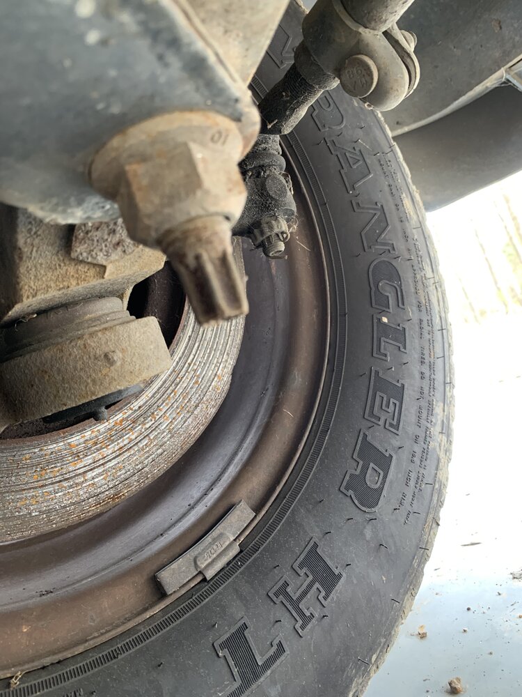

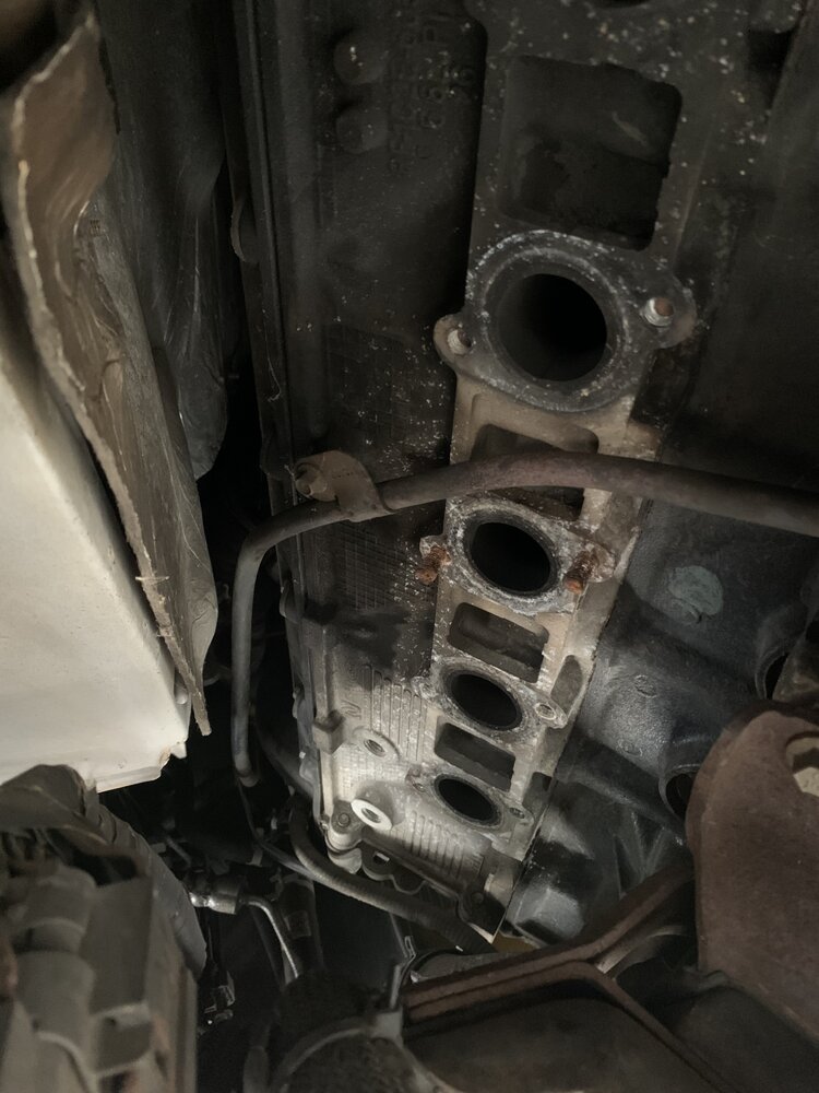

Just a little update with what I’m working with. Shocks are shot haha but new ones were included. Gonna need brakes as those rotors are as groovy as the 70’s and then there’s the exhaust. Driver side was already off, I’ve got two bolts still in block and two others are broken off in the block. Meanwhile on passenger side, I believe there was about 4-5 that were broken off already. Haven’t attempted to remove anything on that side yet
