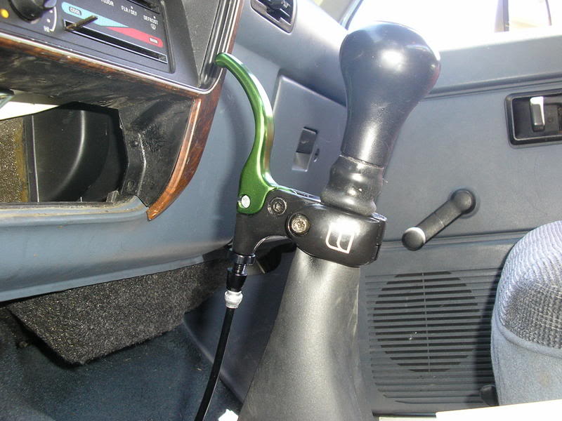

brake lever for bicycle to control the throttle on straight drive
patrick12
Active Member
Jul 12, 2010
King
brake lever for bicycle to control the throttle on straight drive while your 4wheeling So you can work the clutch and the brake. mount it on the shifter i saw it on here awhile back but can find it on here or Google
thanks so simple:driver:
And typically you want to use a shifter, not a brake lever. The older Shimano ones work well because they don't have built in detents, so you can set them wherever is optimal for the situation.
On my old xj i had a bicycle click style shifter control mounted under dash. I used that to set a high idle and hold it when i need a certain rpm. But i also had a brake lever mounted on a jack handle between seats. Arm could lay comfortable on console and control throttle. And when i needed a little extra throttle for a short time i could control it with my hand while my feet worked the brake and clutch. Work very well.
Sent from my SPH-L720 using Tapatalk
X3 for the brake lever. Grandlift had one on his shitter on the sami and it was sweet.
I have the old shifter type and have wanted to go to the brake lever type for a while but then i got lazy and decided im going with an automatic instead. But they do come in handy.
Did the same thing jeepinmatt & others did with a shifter cable instead of a brake cable. Works like a champ during the stop-and-goes on the trails/hills!
Mine's mounted to my dash and its pivot point is actually a wing nut screw so you can adjust & then set it for holding the RPMs up for on board air or 'redneck cruise control'.
