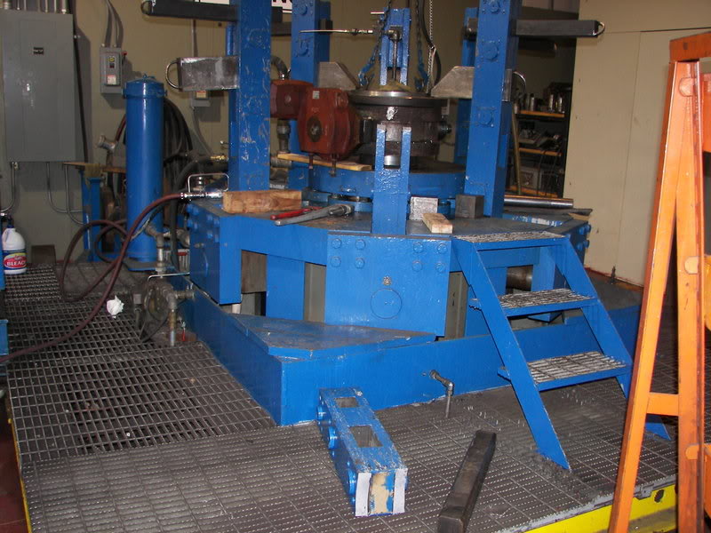

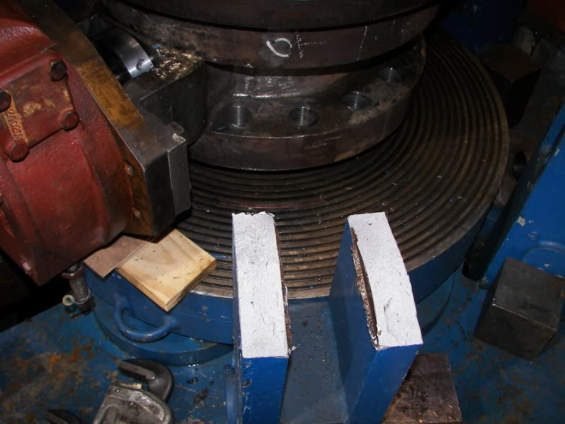

I was standing a few feet away when 5000lbs of force finally got to this test press.Steel is 1.75 Thick
Also cracked two other post...press has been scraped.
20+ years of pressure did her in...new one in design phase

What does that their machine thingy do (besides the obvious answer like: its a press)? Is it for a particular step in a manufacturing process? Just curious.
It is used to test the valve
The "press" is used to lock the test plates onto the valve while water pressure is forced in a test plate into the valve to check the valve for leaks.
I valve in the pic was being tested @ 1600 PSI almost double it's working PSI
