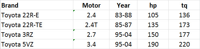

You considered a 3rz or 5vz at all? Both gassers but both Toyota motors. I don't have experience w/ 22RE-T's but from all I've heard they're good little motors and very coveted. I'm inclined to go w/ @StretchASU on this one...have somebody rebuild it and keep on gettin' it!
Check out the top table here: Toyota Pickup and 4Runner Drivetrain Specifications
It will show you how that motor shakes out w/ the other Toyota motors I mentioned (keep in mind power/weight and you'll prob see what you've got is hard to beat).

I don't know much about the 3vz swap from a mechanical aspect, just interweb wrenching. They are great motors and make more power than the 22re (t) platform. I just assumed the op wanted more power so why not step up to a 6 cylinder, plus if you can find one the trd supercharger would really wake it up.
