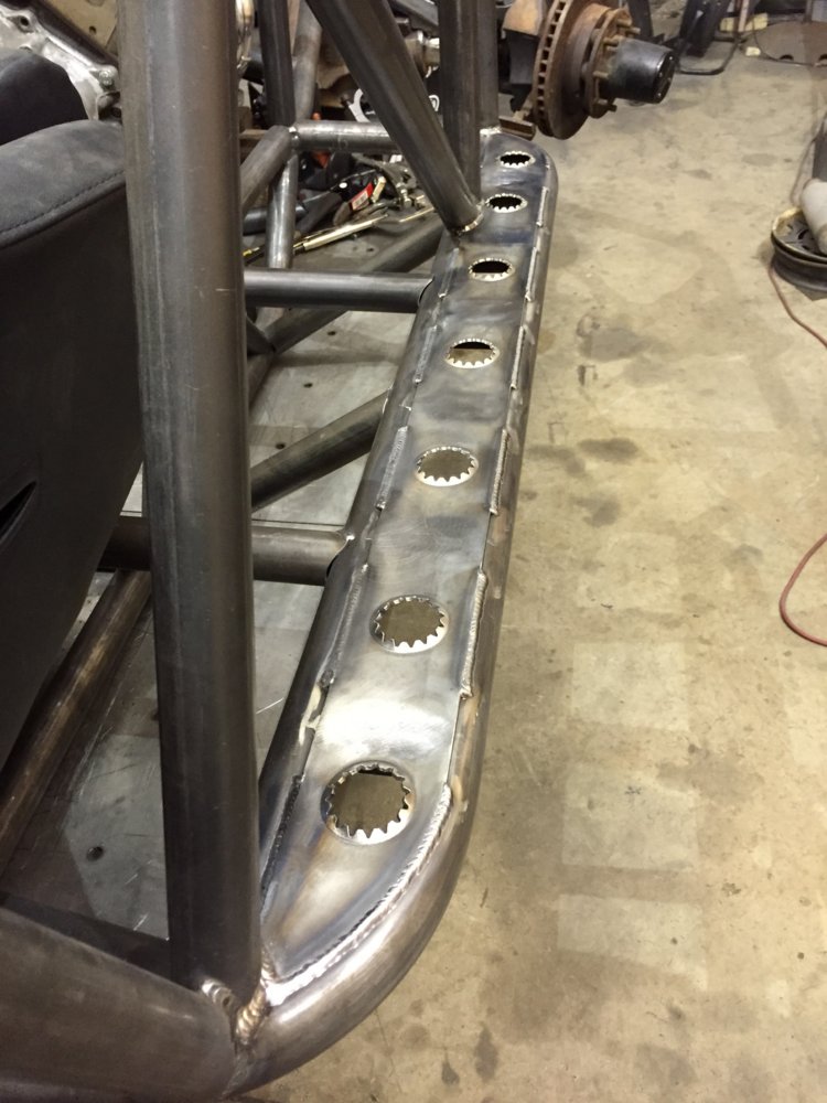

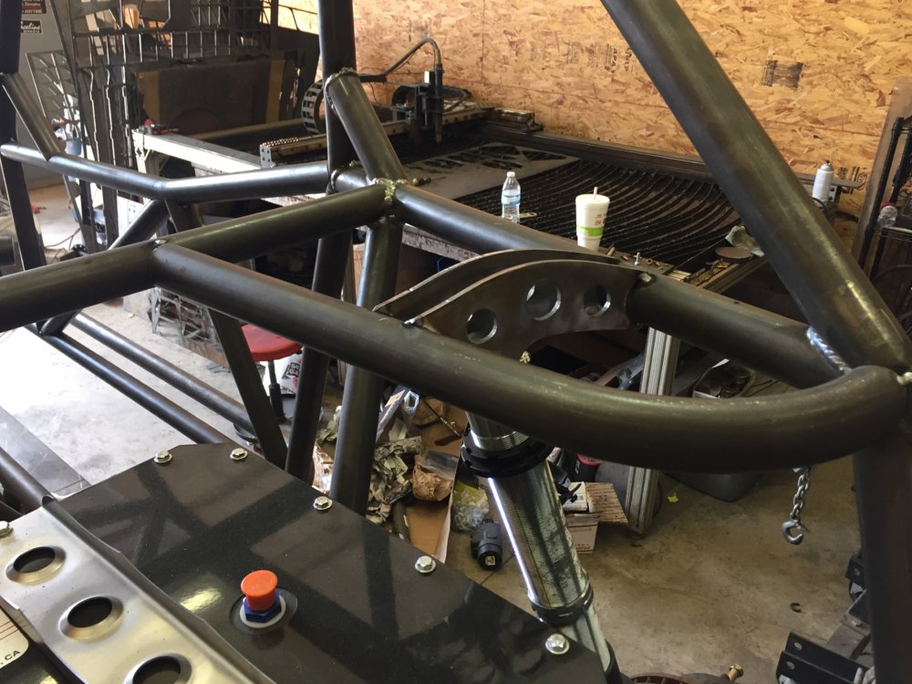

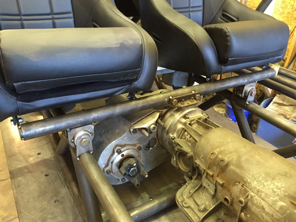

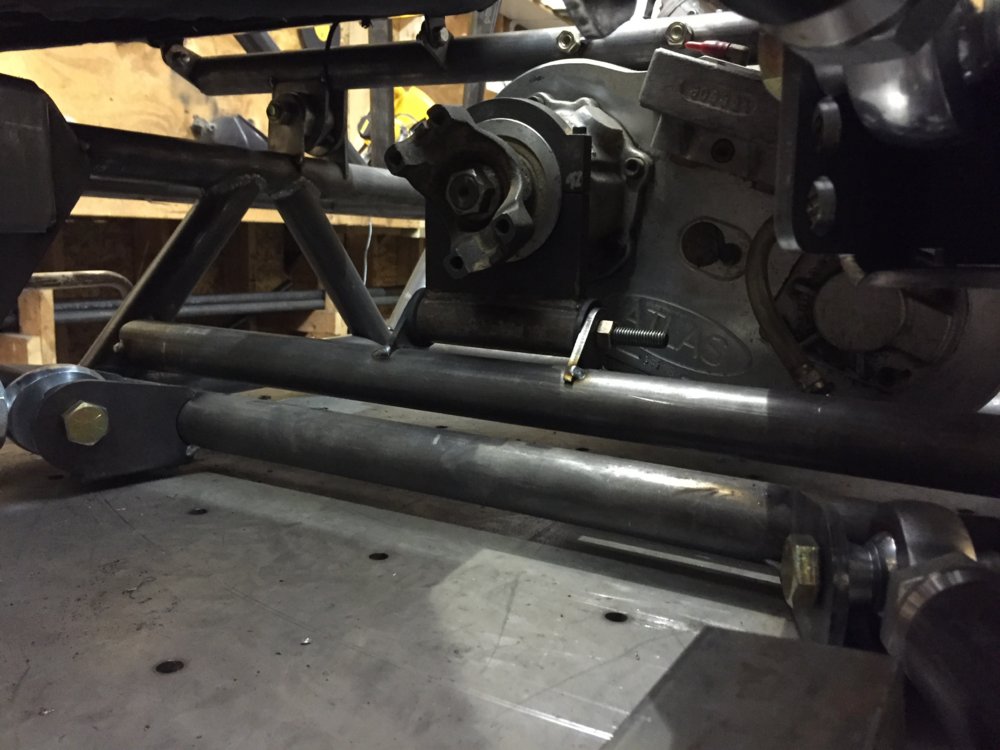

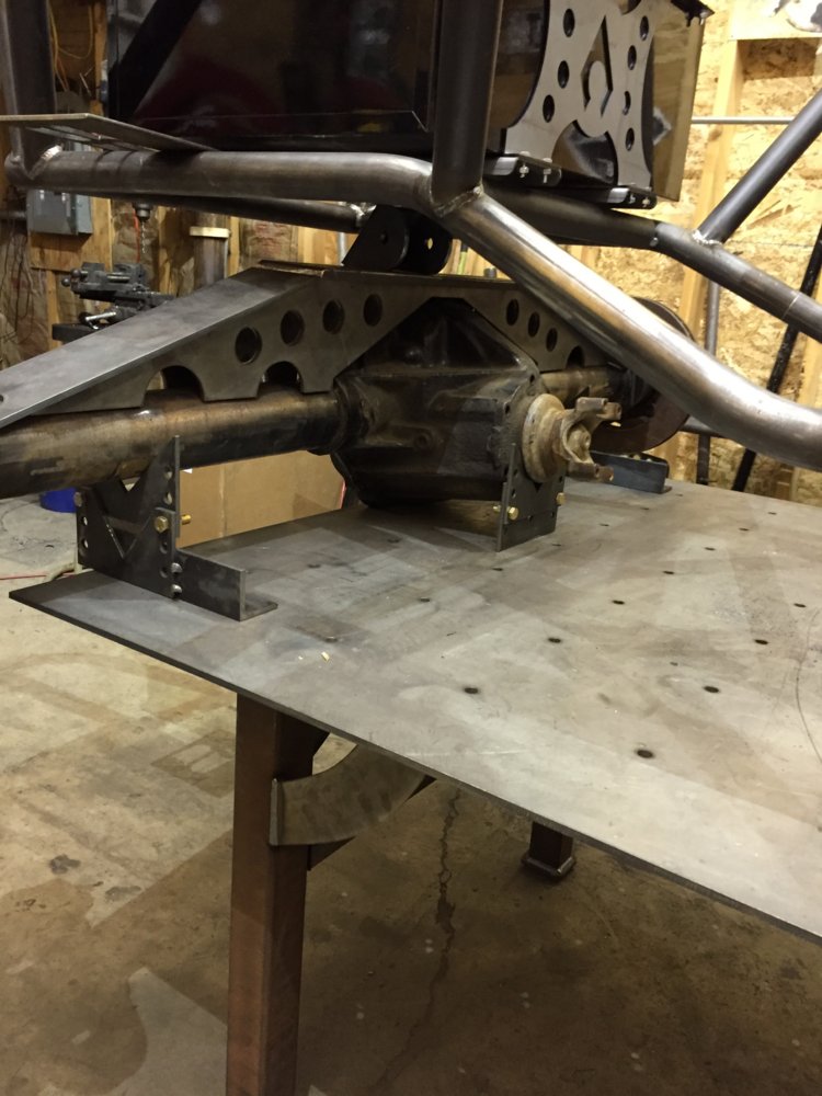

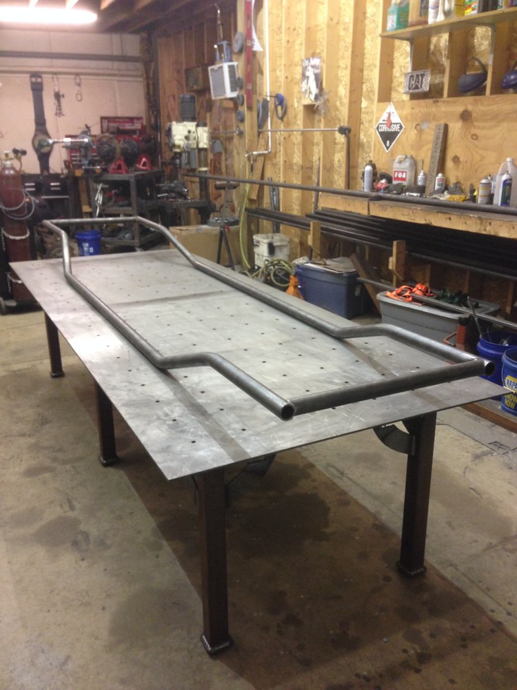

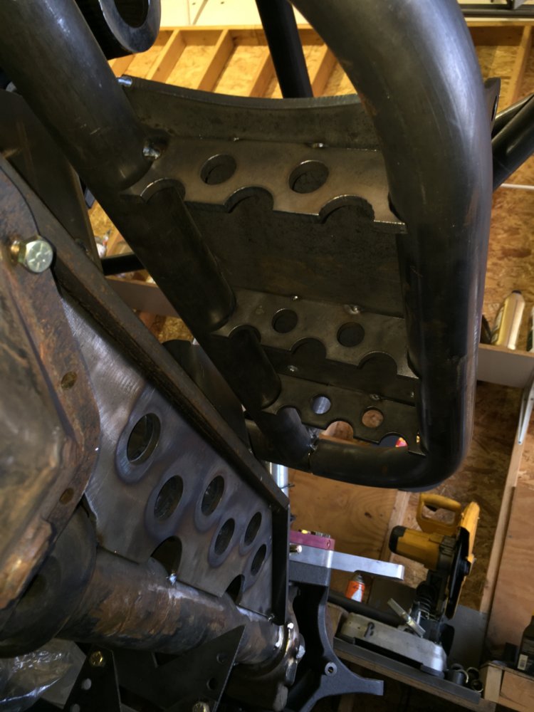

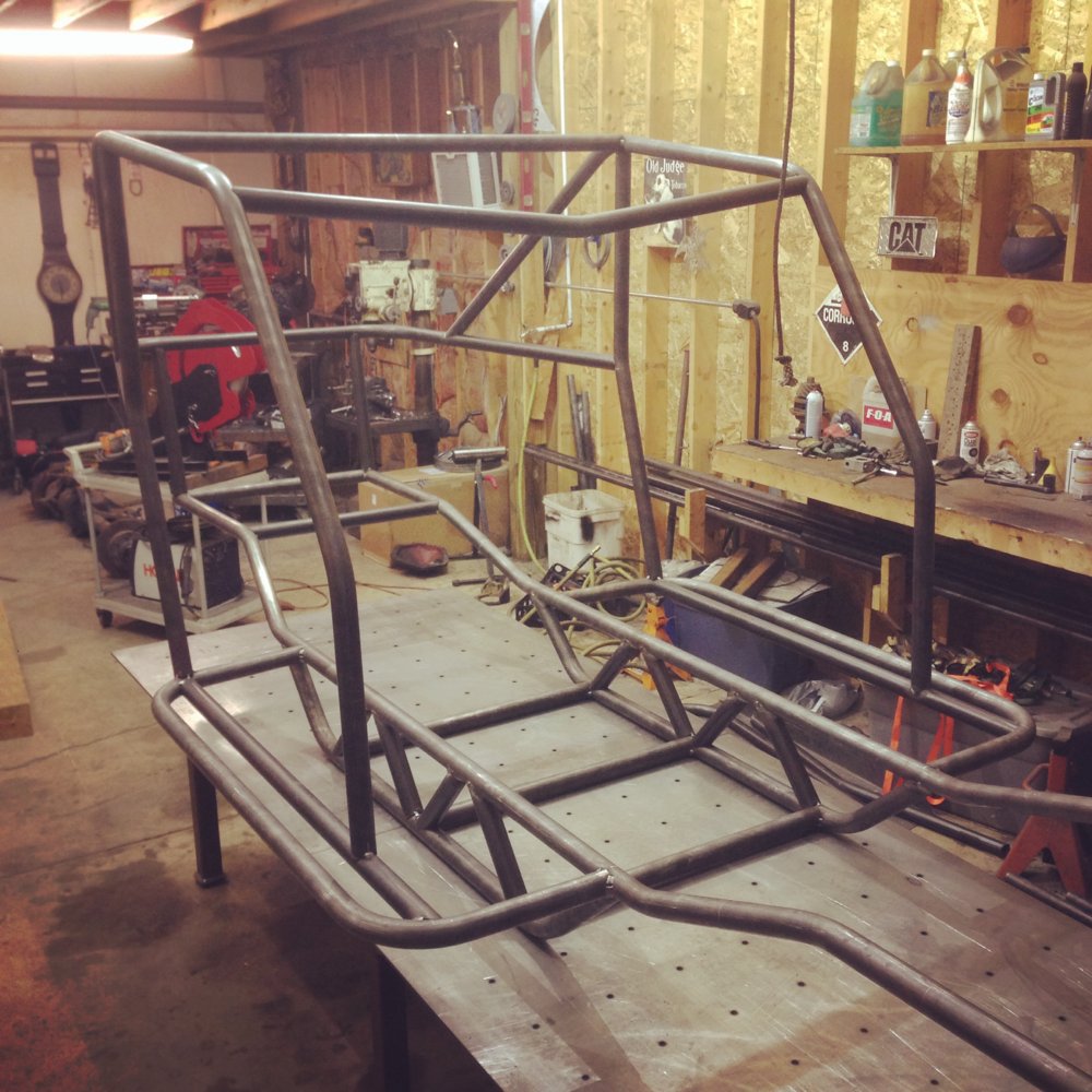

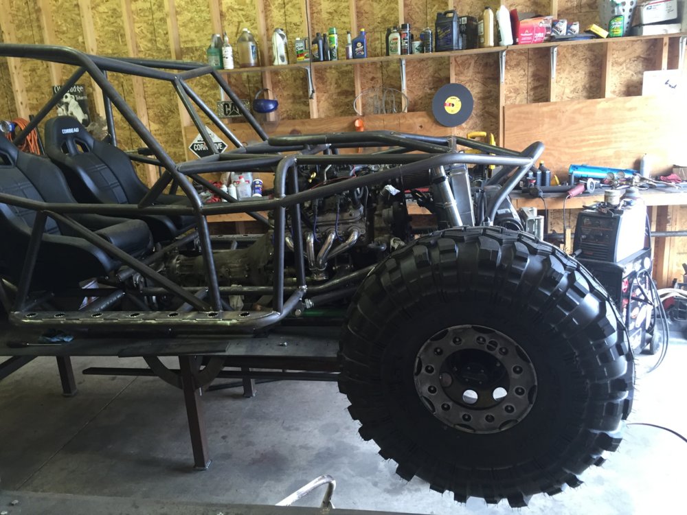

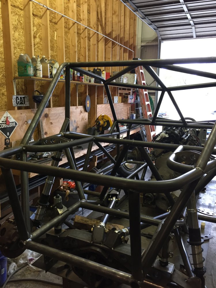

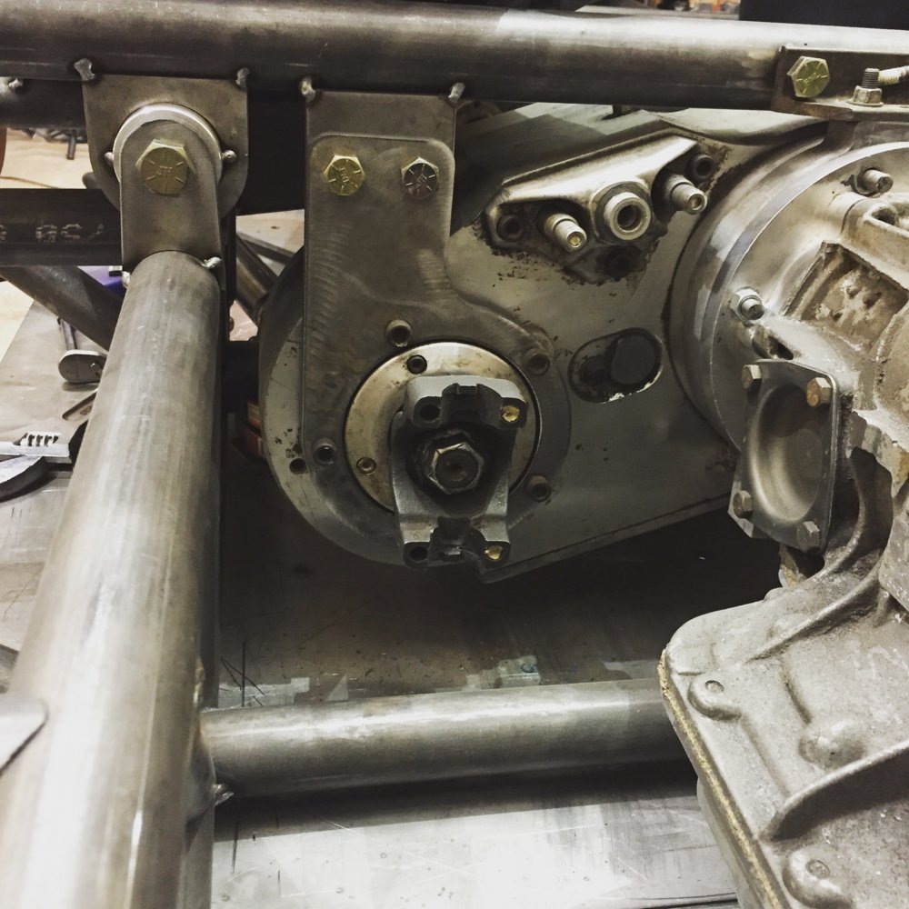

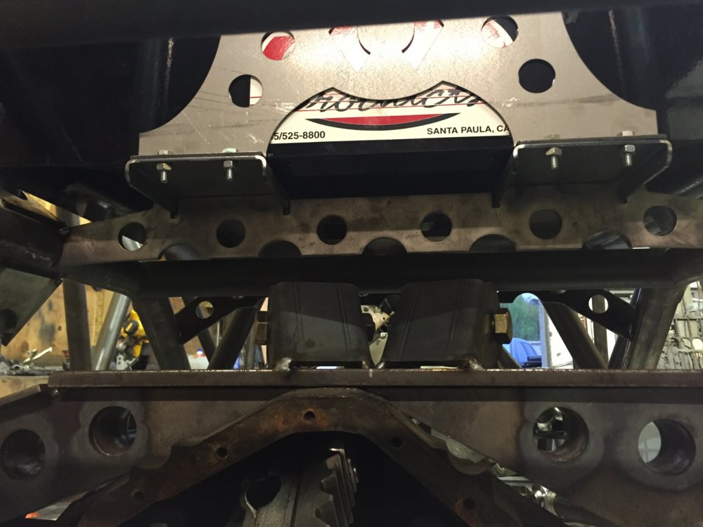

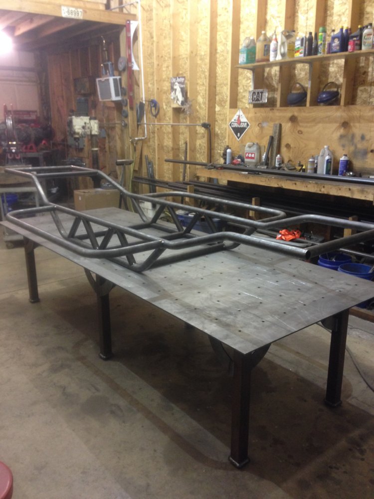

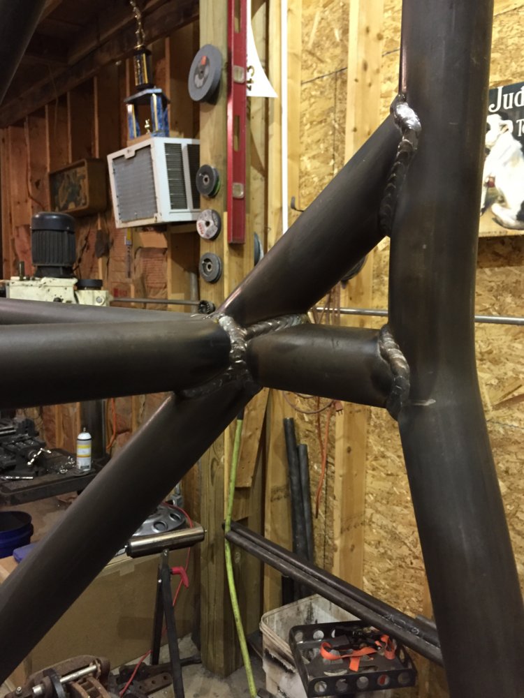

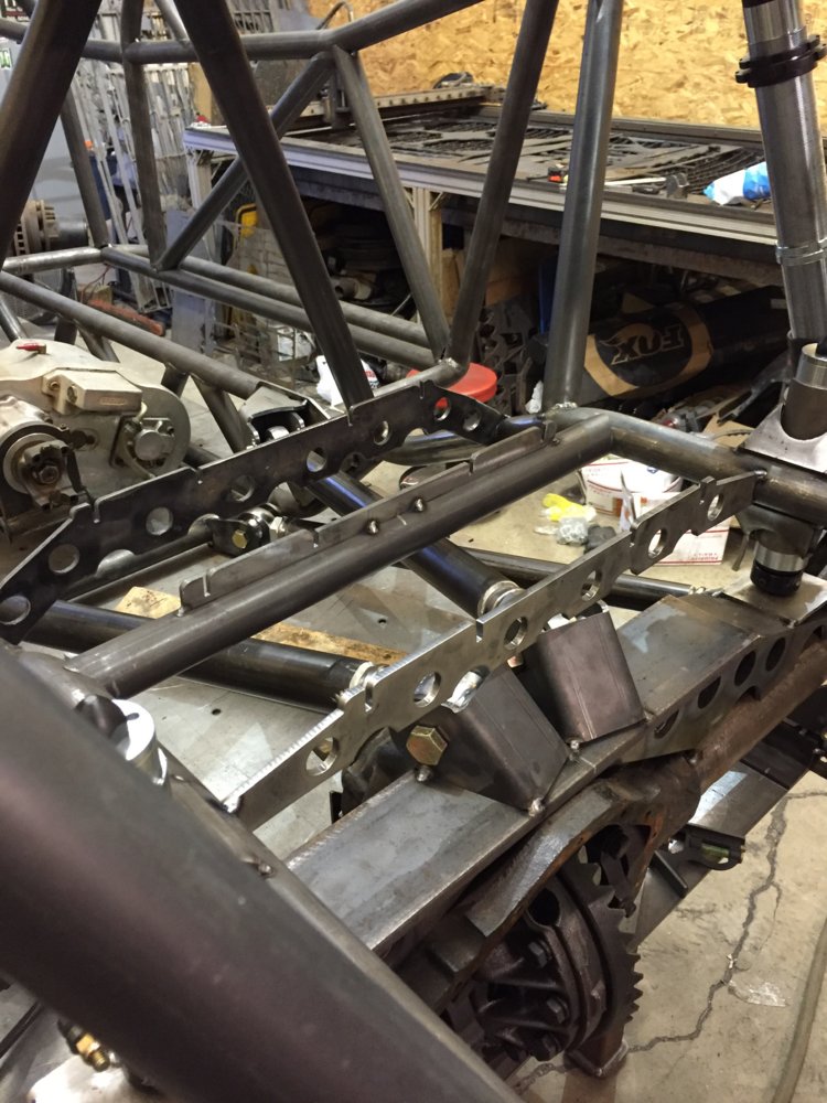

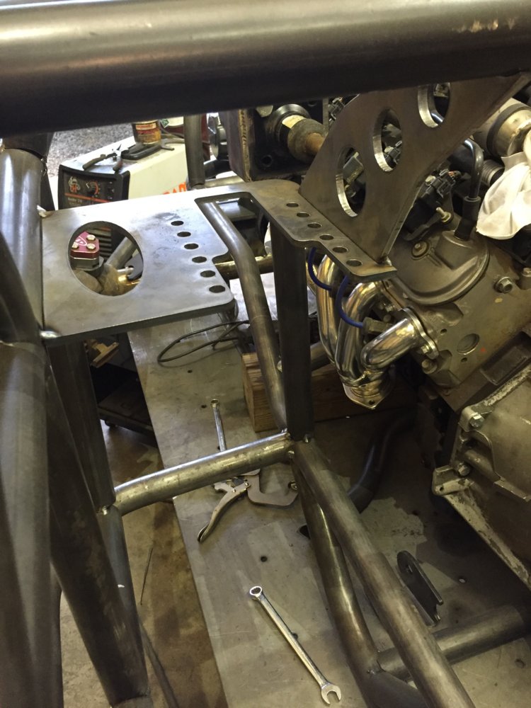

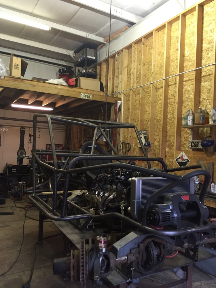

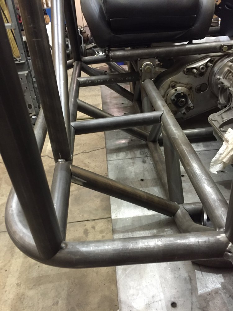

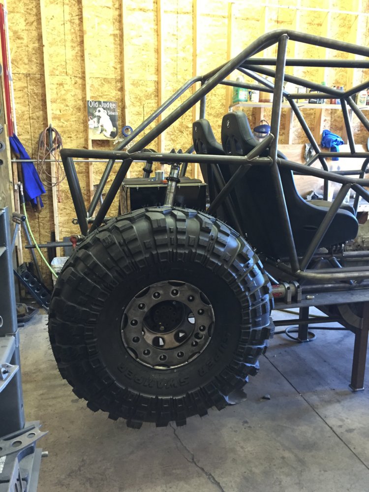

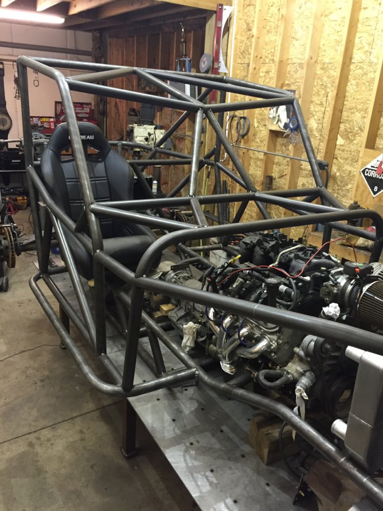

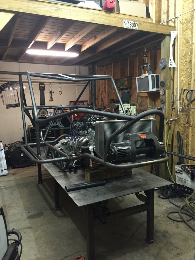

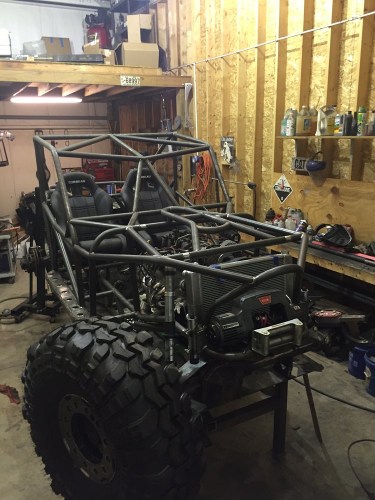

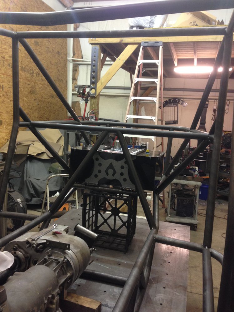

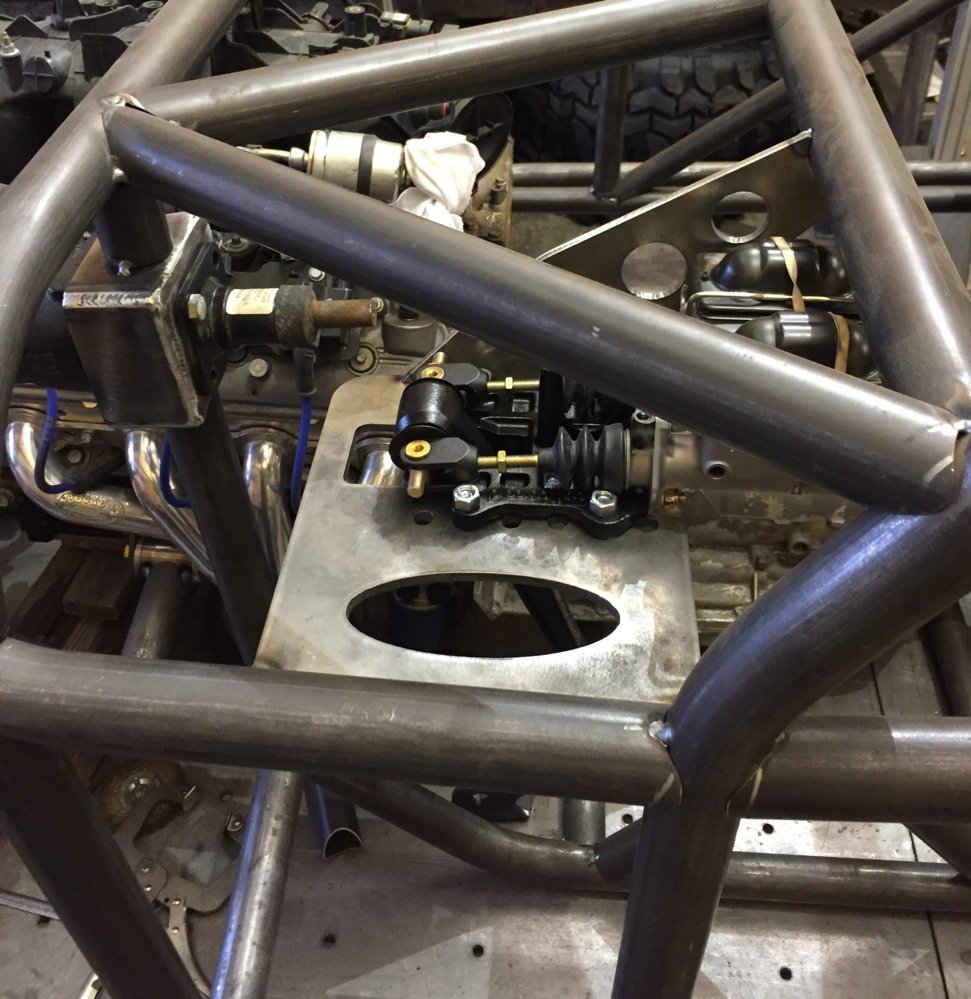

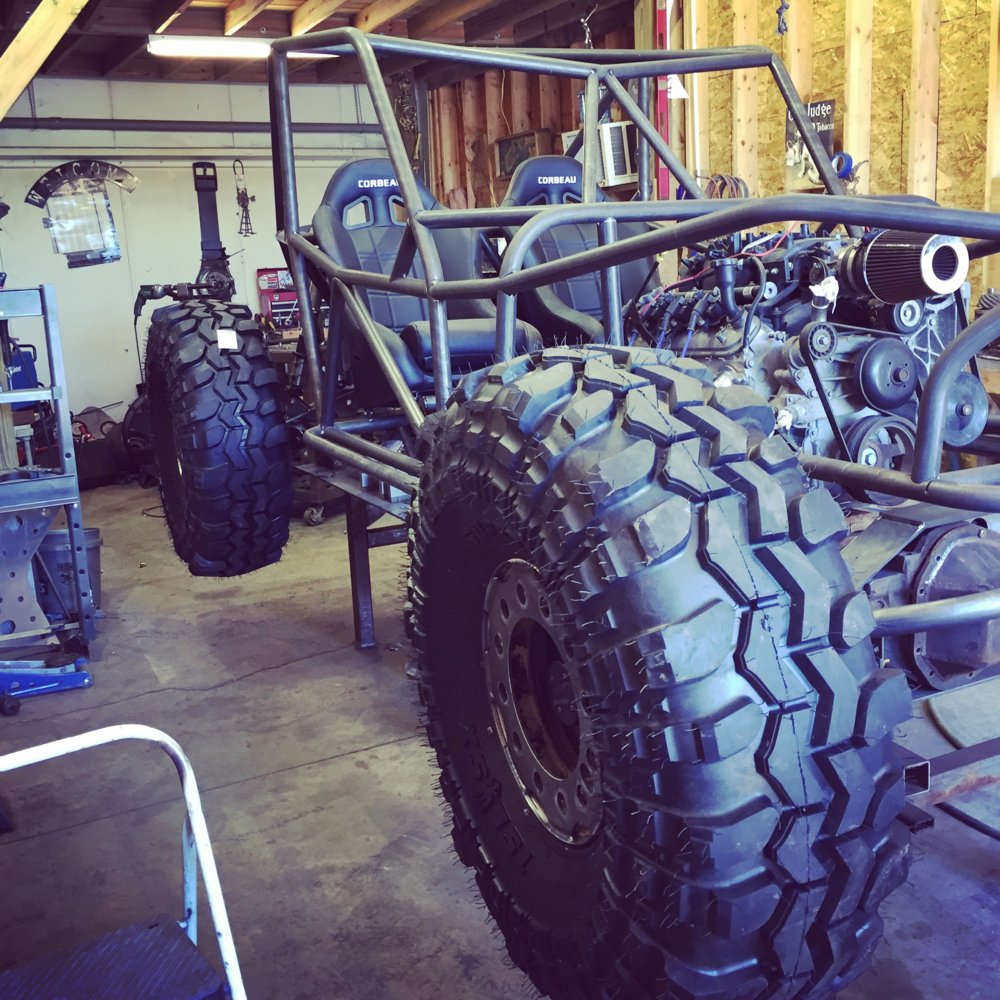

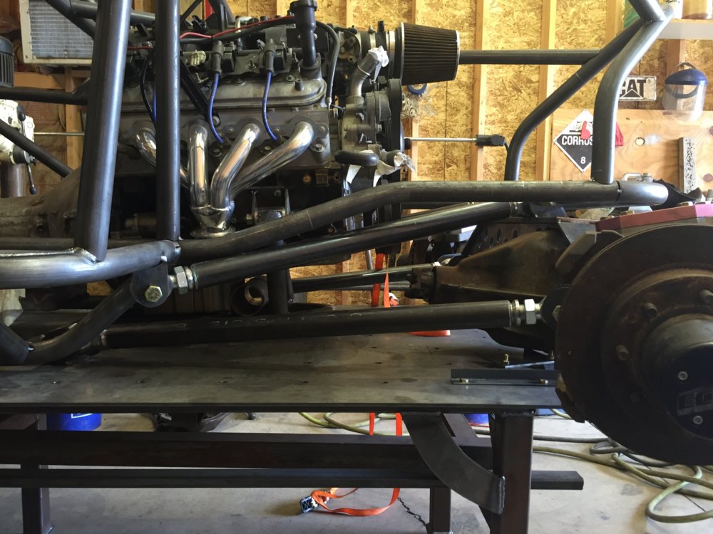

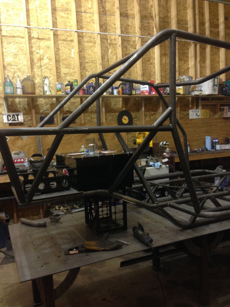

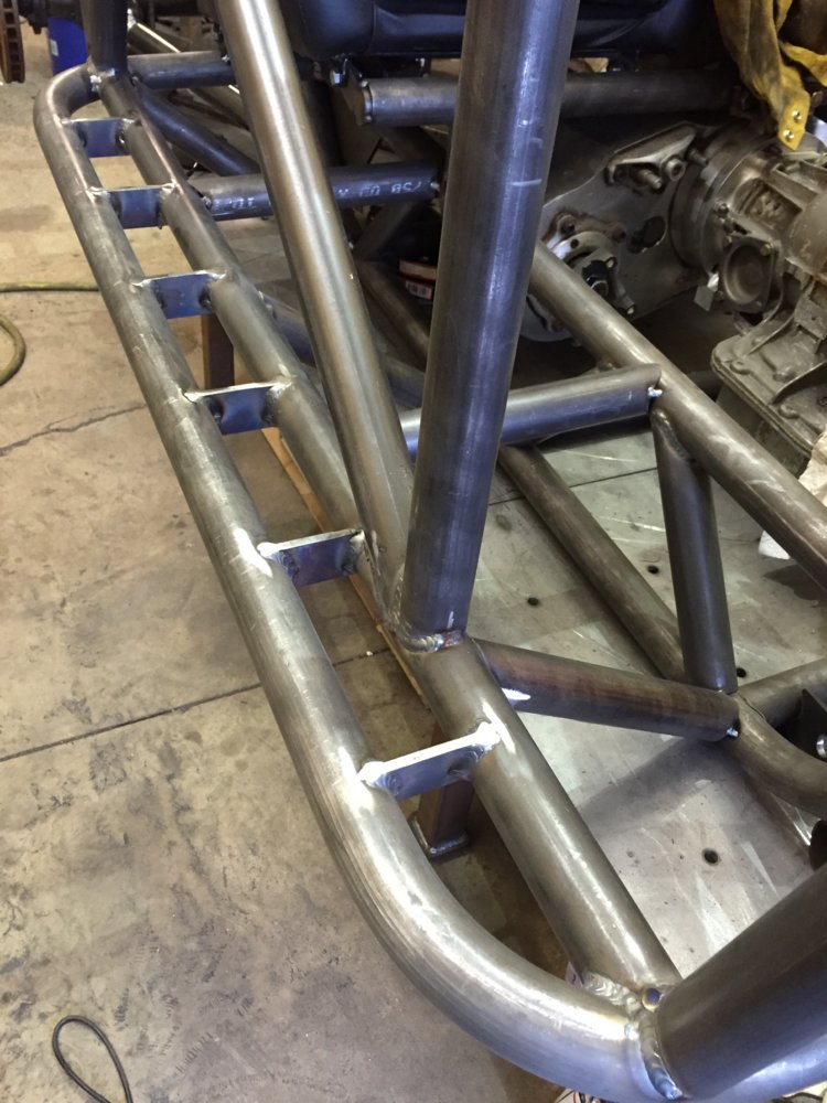

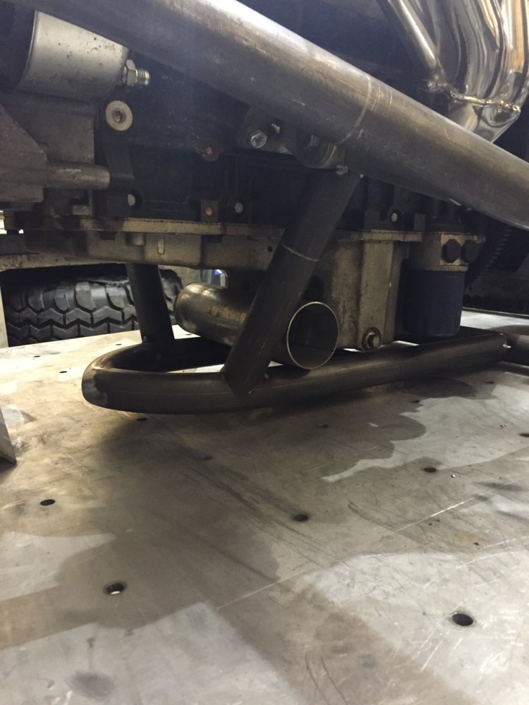

I started building this buggy a couple months ago for Dustin Wilkie (crawler nut), figured I'd start a build thread for him. It's getting a lq9, th400, atlas, 60/14 bolt, fox coilovers/bumps and 43 stickies. I'm building it out to a roller with pedals,seats,radiator,fuel cell,winch mounted then he's gonna take over. Frame, sub frame and roof bars are all .188 dom. Anyways on with the pictures.
