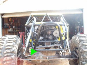

Wow, that looks great! The only thing I would do is beef up the axle side pan-hard bracket if your not already. I think that spring perch will give too much.:beer:

Thanks,i agree,the axles is a mock-up to see if it will work,they need to come out and get all the goodies,truss cleaned up bracing,knuckle gussets,the perch will get boxed in and lots of gussets.
