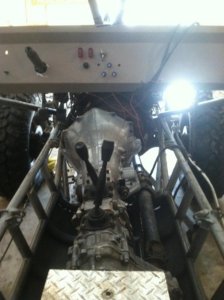

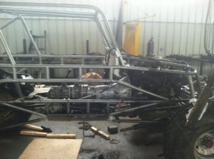

sorry I did say that wrong in the original post. the 4.7 is in the rear case. The front also has an upgraded 23 spline chromoly input. I do kinda want to keep the toyota cases, mainly because the cage was designed around them. Its pretty tight as is. I'll try to get some pictures up. Front driveshaft is the trickiest. I have already had to raise the cases about 2.5" for the shaft to clear the pan.... not sure i am assuming the other t-case options would be even wider and more difficult to squeeze into the belly of my rig.
