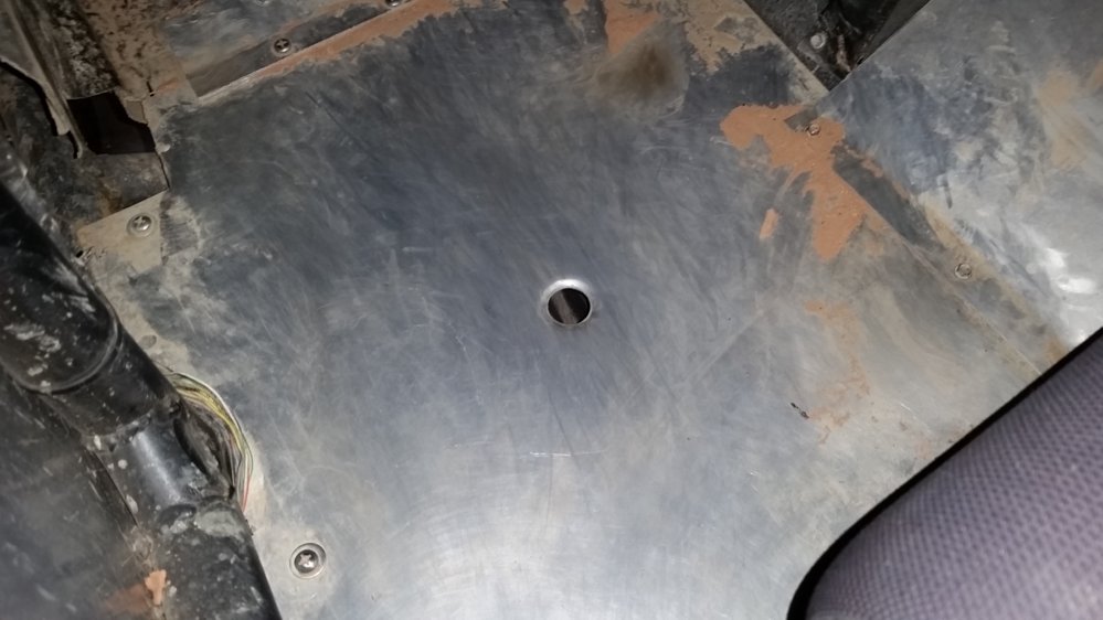

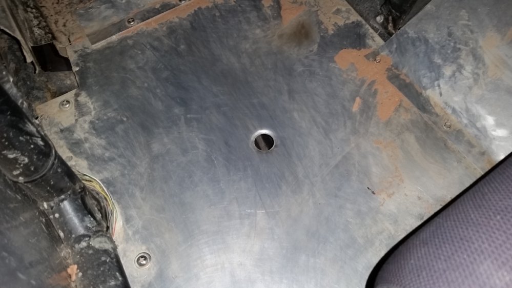

Mine have been in since April. I'll take some pictures tonight. There will be some scratching but not a lot. Will it stay shiny, no. It really depends on how much mud and crap gets inside, thats what does the scratching.
Here is my floor after roughly 7 months of use. I don't have floor mats so this is direct contact.
The aluminum will hold up better natural. If not coated with something high end in paint or liner moisture will get trapped. It will corrode much faster than you think. Also between dissimilar metals with a moisture trapped electrolysis will be much greater. Some of the worst corroded fire trucks I have seen have been undercoated or cheaply painted units built from aluminum.
