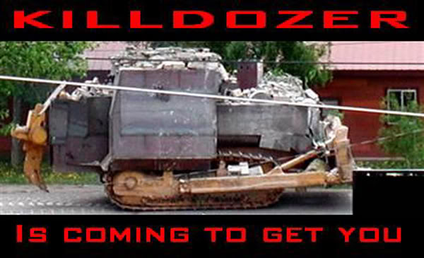

How bout this....
http://www.youtube.com/watch?v=24n77GgRtrw
Pretty crazy!!! Too bad it ended like it did.
LMAO...not quite what i had in mind lbyota!

I feel like Ive been under a rock. I had never even heard about the "Killdozer" incident. That was pretty awesome.
