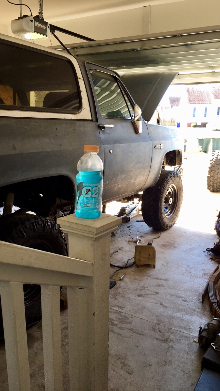

Try building a k5 on tons in a 2 car garage.
some days I'm like how fuck am I going to get it out of here with this 7ft door.... then I realize I can just deflate the tires, lol.
Ha yeah I did that when I lifted my Zj in a buddies garage we thought we were good deflated tires and it barely made it out I believe we dropped them down to 5 psi... that's a good looking k5 I'd be hesitant to cut fenders on that one too!! Lol
