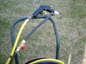

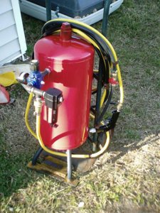

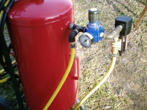

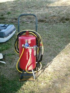

This works great! I am going to build a cabinet out of plywood large enough to blast a motorcycle frame (or axle housing). makes cleaning up parts a Blast! I built one from an 11 gal air tank from home depot You can get the gun from there also. Mine works awesome.I welded a
1 1/2 inch coupling to the top of the tank with a 1 1/2 plug to add sand. I'll add an actual photo later. and using an actual air tank that is rated for 200psi i didnt add the blow off valve cause my compressor only goes to 125psi.
Here are some pics of the final product!
works awesome! I am putting a 1 1/2" ball valve in the coupling to make loading it easier. you can adjust the regulator between 7-12psi depending what media you are using. I put a valve in the sand line so when you are not blasting you can shut off the flow of sand. Make sure you use actual blasting media, Playground sand is silica and is dangerous to your health and I believe Illegal!
