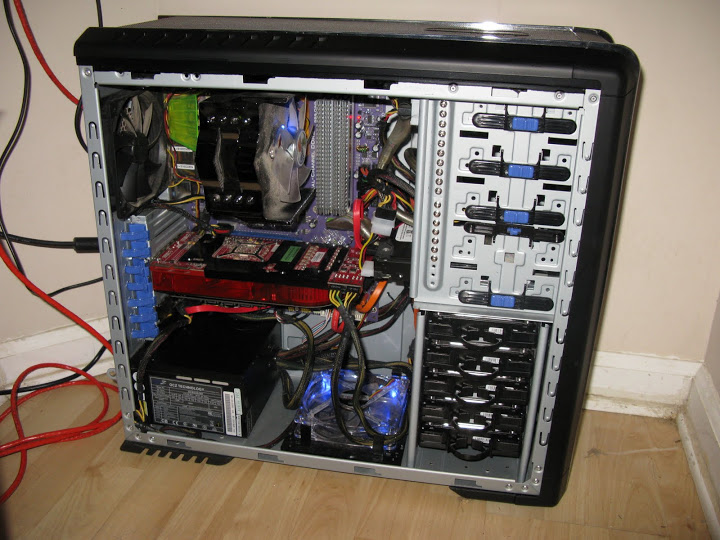

... interesting. That's similar to this Lian Li I was looking at, except with a rebate, no stupid window, and an extra 3.5" bay.
Also... an awful lot of video card for a "server"... but I guess I can't talk much. Mine will probably get a Radeon 5770. :lol:
