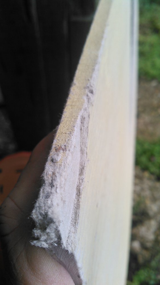

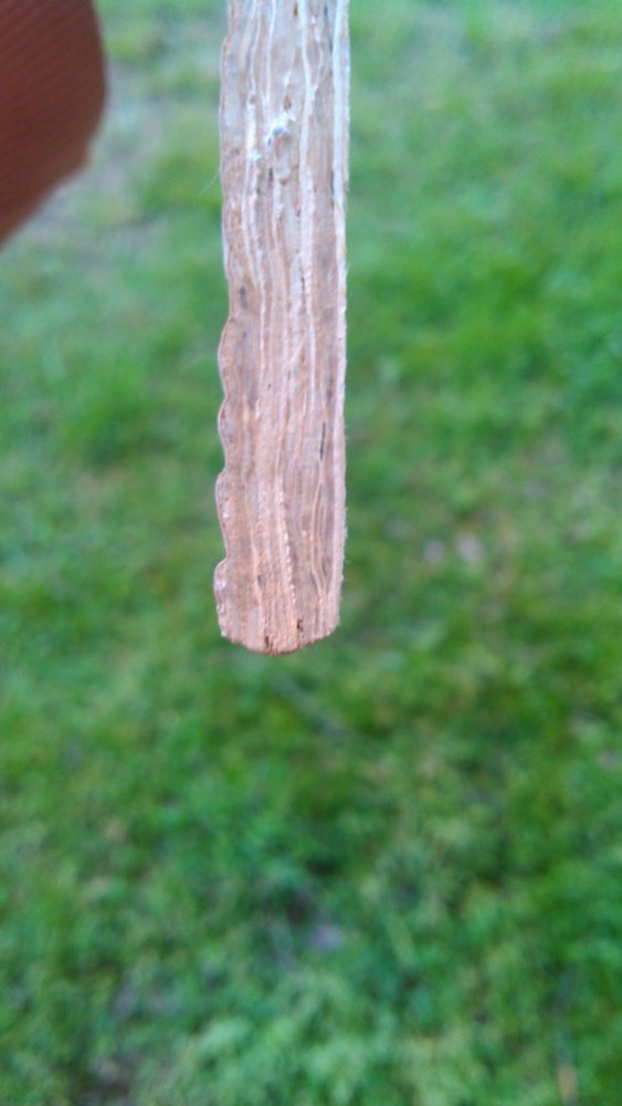

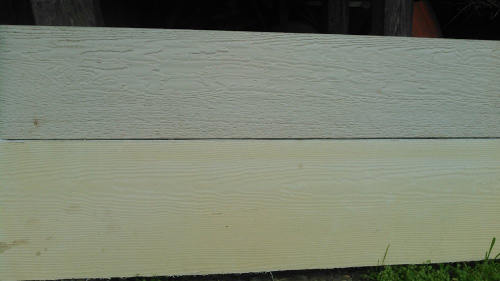

A few pics of LP vs Hardie since I had a few pieces laying around. LP has more grain definition.
LP smart siding on top...
LP profile edge
Hardie straight edge and you can kind of see how it's layered. The broke off chunk was one layer... I think it has 3 more
