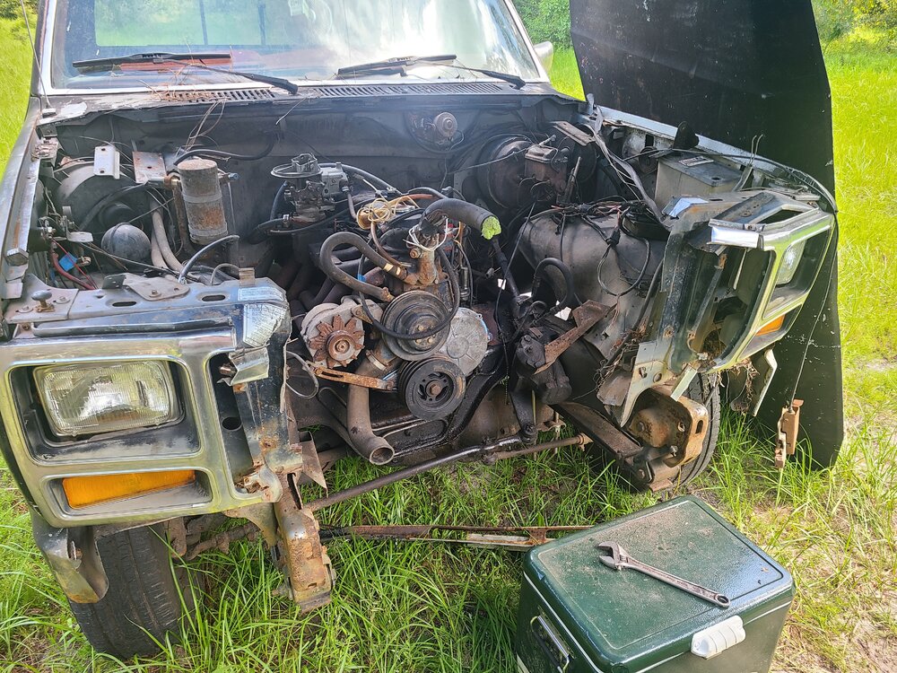

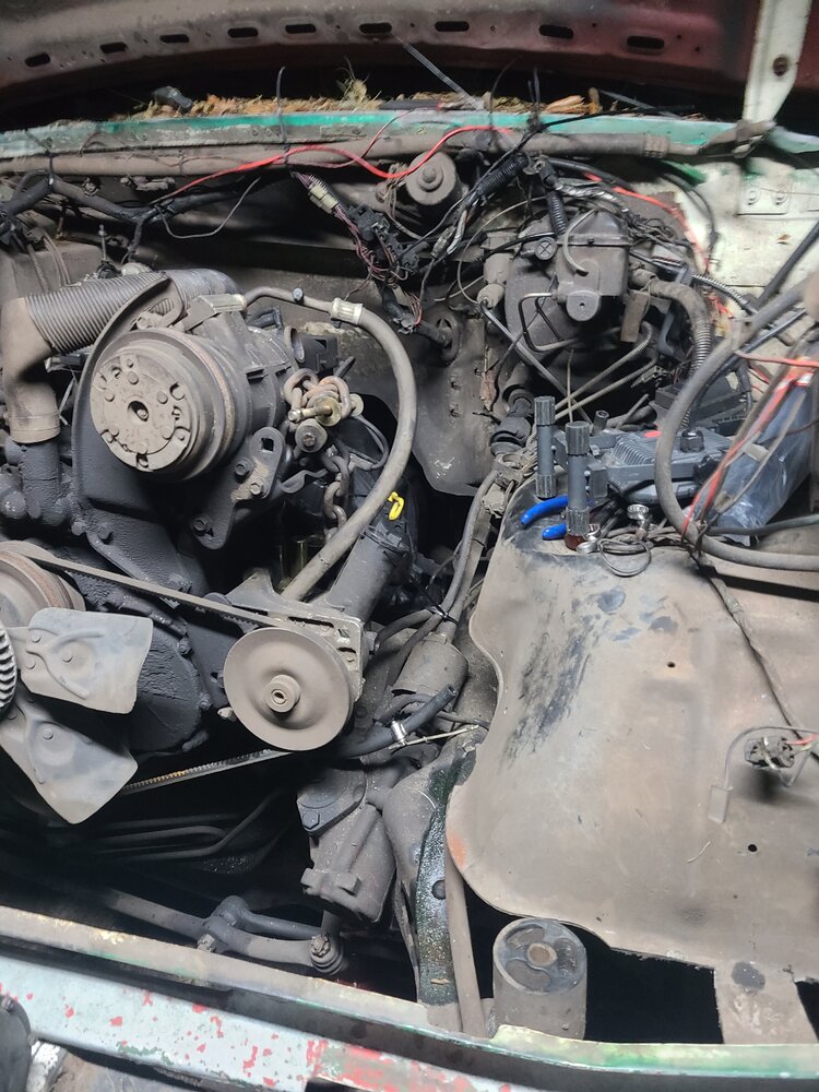

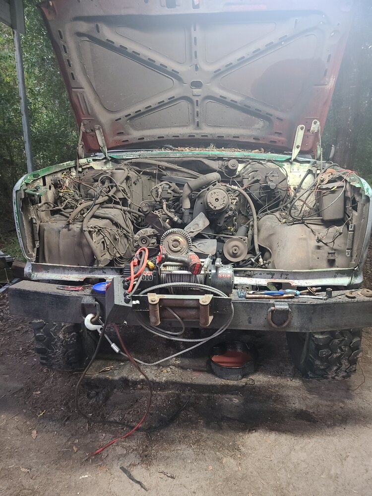

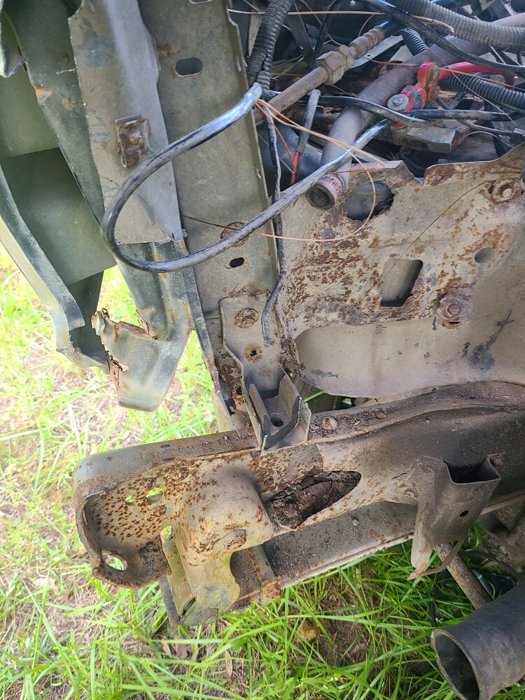

Well today I put in about 4 hours. After figuring what wiring was important I started dissambling. This truck has already been hot wired to bypass everything but the key. Zero sensors plugged in and connected. Literally only thing attached was the bare minimum to make it run. Hardest part was removing the radiator support because of the clamp on threaded inserts braking. Second hardest thing was untangling the wiring harness and getting it zip tied out of the way.
In the morning I have to disconnect the clutch, starter, and exhuast. I already have the majority of the trans bolts broke loose. I didn't feel like crawling in the sand in the dark. I'm going to try to leave the trans in place when I pull the motor. I ended up spending most of the time standing on the sway bar in front of the fan to be able to reach everything.
Tomorrow my goal is to get this motor out and the donor truck to this point.

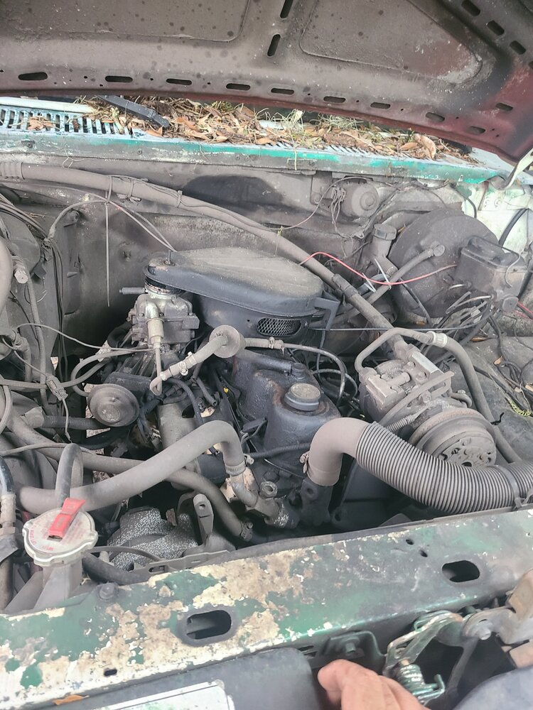

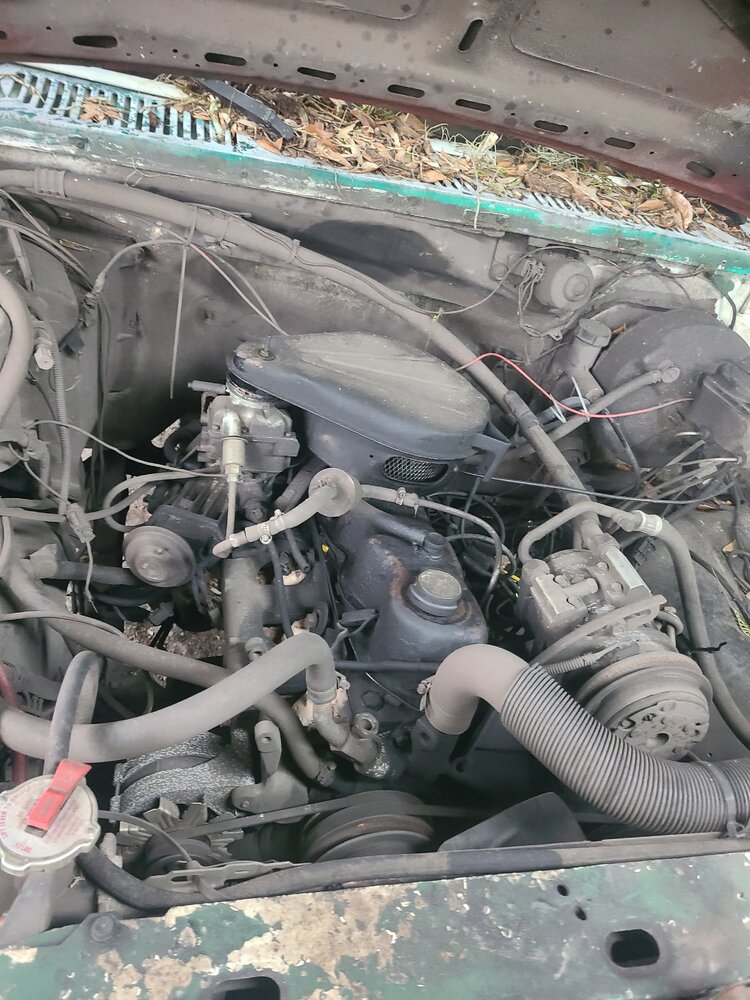

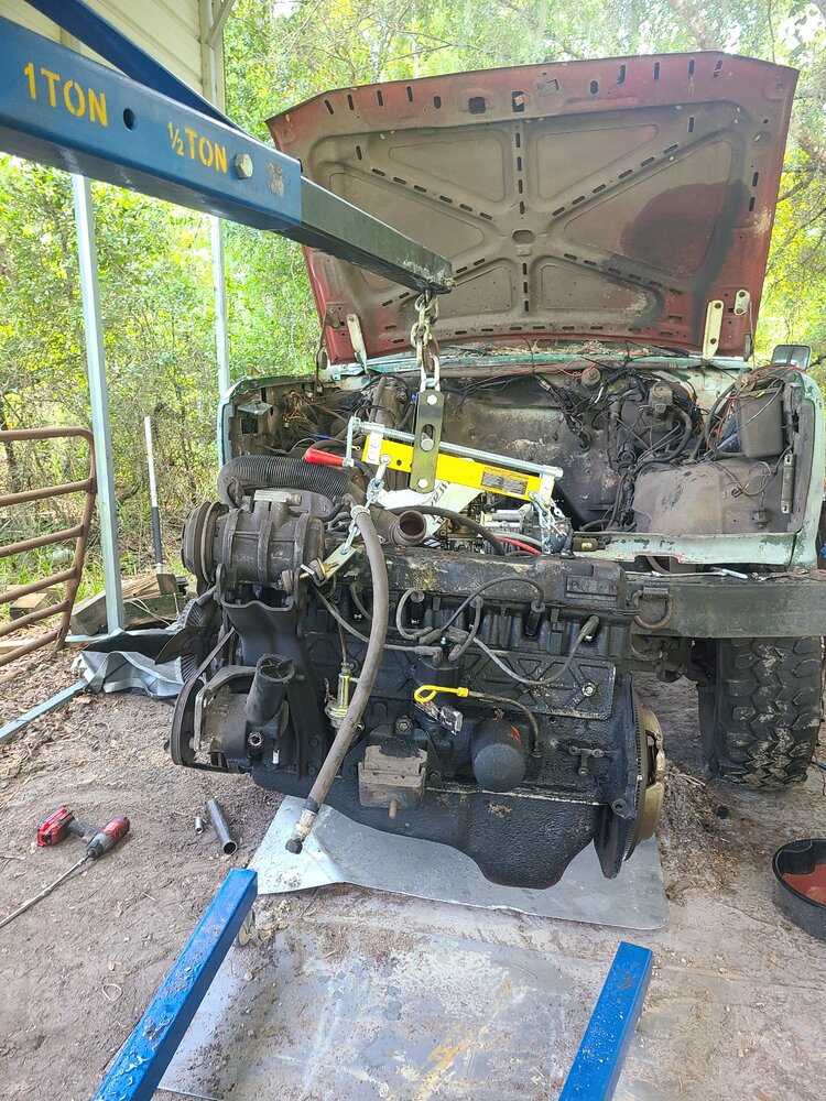

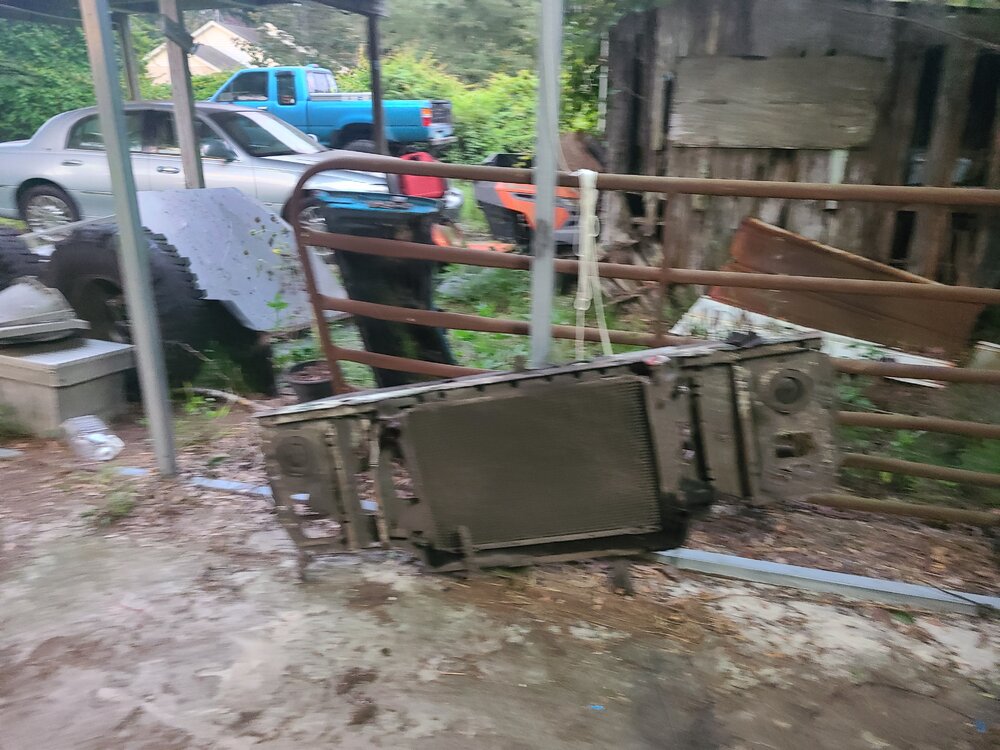

After a few busy days my uncles truck runs. I still need to install the radiator and front clip. The new to him engine has a small oil leak from the oil pan due to a bolt being stripped out so that is going to get drilled and tapped later. We ended up having to ditch the mechanical fan due to differences on the water pump pulleys and the old pulley being rusted to the old water pump. So it's getting duel 16inch efan setup.

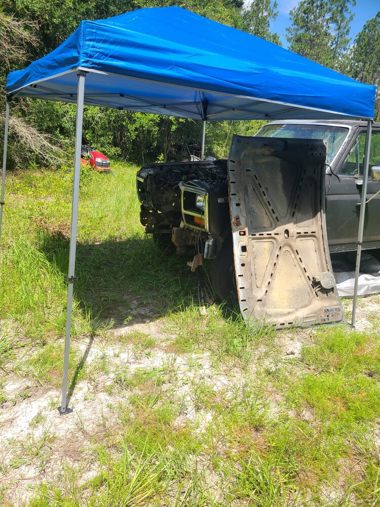

Pulling the engine out of the donor truck was easier since it was missing the front grill and the radiator support being rusted. I decided the saw saw was the best course of action instead of undoing 30 tinny fasteners that would probably break and free spin.
Overall it was a very easy ordeal. Except it took 3hrs to get the new engine linned up and in. But after it finnaly slid into place 30 minutes later she was running. Ps engine hoists on sand suck.
